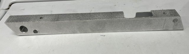

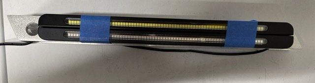

    If anyone is interested, I got a little more completed on my project. Might end up going with two LPB on each side as opposed to the current idea of one LPB (red) and one LPR (white).

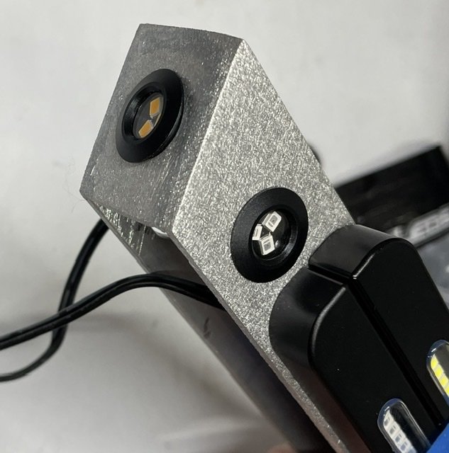

    And if you want to know what the little holes are for on the end, those will be additional parking lights. Red to the rear, amber to the side.

    If it was me I'd do one of each as you will use the reverse light way more often. What did you make the mount out of?

    It’s aluminum. 1 1/4” X 1 1/4” channel. Aluminum works well I think because it is easy to work (any carbide tipped blade used for wood will also work against aluminum for the most part) and it won’t rust. These will eventually get powder coated. There is another piece of angle aluminum that covers the bottom, to make a square tube kind of. It also has a couple of those little round lights that will function as puddle lights. I tend to not know when enough is enough….

    Looks great!! Can't wait to see output shots when you are complete. Did you trim the mounting tabs on the LP light bars to make them sit flush to each other?
    I wish they made the LP bar in Amber, but I get that it wouldn't probably have the customer base to justify it. I would love to add them to the bags of my motorcycle. The "Stripelight bars" are nice too, but I like the mounting tabs, flat edge and length of the LP bars.

    I did. I wish they made them in a surface mount configuration like their exterior strip lights, but I have to work with what I have. And what I have is a die grinder :D
    Amber would be nice as well. I’d love an amber/white switchback as well.

    Without the mounting tabs, how are you going to attach them to the aluminum? Double sided trim tape?

    Yeah, most likely. They have a “step” of sorts on the back, so I am using a 1/8”X3/4” filler to fill part of that gap. That should give me adequate surface area.
