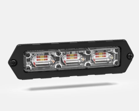

    HAHA. Well luckily it has 3 available presets. So theoretically you don't need a controller if you only use 3 settings. For my bike it would be red running light (30% power), red brake pop (flashes 3 times full power and goes to 70% steady on) and amber turn signal (100% power). But if it were my truck and depending on mounting position I think I would only use brake pop, amber turn signal and white/flood for additional reverse lights. Go back to page 5, I have links and videos from youtube.
    We've all seen police car's lights and know exactly how bright/intense those lights are. They are made to get your attention no matter the weather condition and they are made to be extremely reliable. To my knowledge it is the only light that has 4 colors in one assembly that uses all the lenses for every color.
    For the Feniex Quad they also have a recessed mount that wouldn't look nearly as bad.

    I think I remember something about “modes” now that you mention it. I did a little investigating on these, and they seemed pretty cool, but I didn’t do too deep of a dive. But having different modes activated by different trigger wires (I think that is how it said they work?) could be cool. I am just a sucker for lights that do stupid stuff :rofl:. The surface mount could be cool too. My original intent with the VLED was to have it rear mounted behind a slot in the aluminum. But, since I am doing these with brute force and a router, that idea didn’t work too well :p.

    I've looked into those as well, no doubt they are awesome and sleek!! I think I have seen them on a couple HD's, didn't ask the owner but I was pretty sure it was those. Very few strip lights with red/amber out there that are that nice. But $179 for the 8" and even more for longer ones is a bit much for what it is in my opinion. I think the Feniex Quads would draw the eye more due to it's intensity and functions, plus similar end price at $99ea. While a brake flasher could be added to the Custom Dynamics strips, it adds more cost.

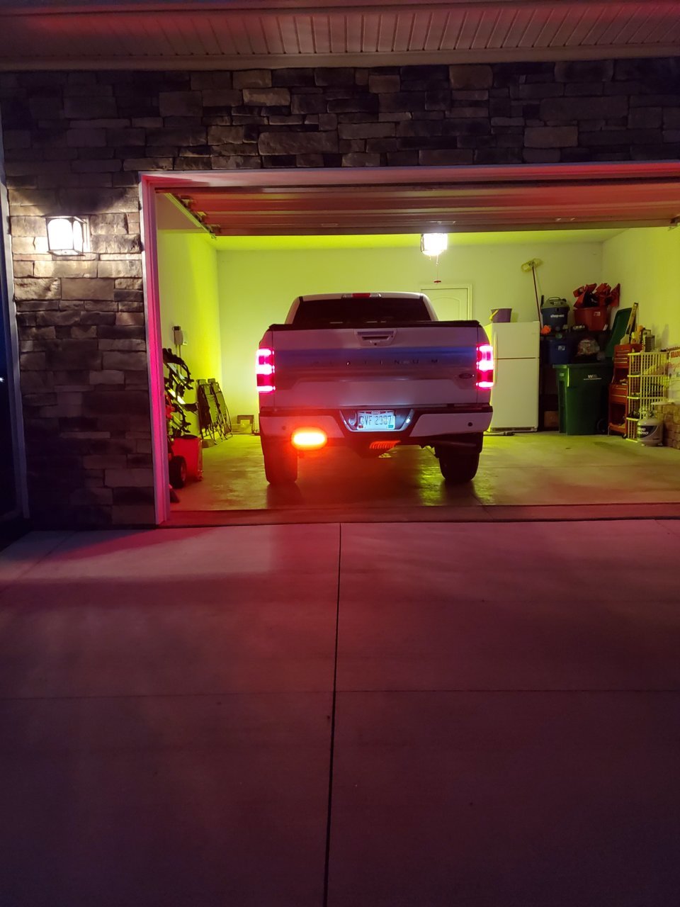

    Houston we have a problem. This works as designed while on ACC power but as soon as you start the engine it shuts off almost instantly. Without the engine on I can shake all the connections and not even a flicker.

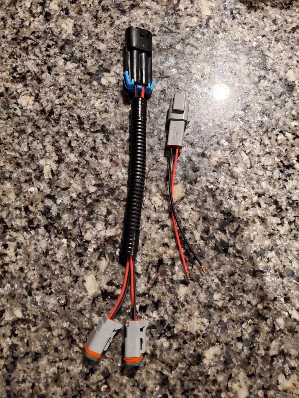

    No scotch locks. Tapping the fog light isn't actually correct. The DD ford f150 fog light kit comes with a h10 to DT plug convertor. I replaced the DD plug with a Starkey products h10 to dual DT plug adapter. From there I used Ford Motorcraft non insulated crimp connectors with glue lined heat shrink for all the connections. Since my f150 doesn't have a key when I say ACC power it is actually the vehicle completely powered up without the engine running. I only lose power to the rear fog when I start the engine. When it is on under power without the engine on I can shake and wiggle the whole harness without so much as a flicker.

    Used these. DT plug up front and another on the Hella rear fog.
