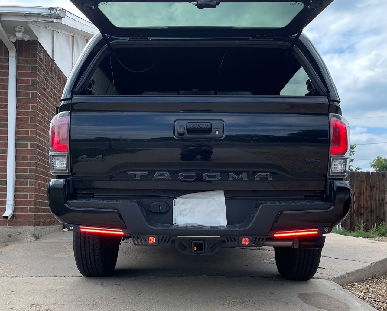

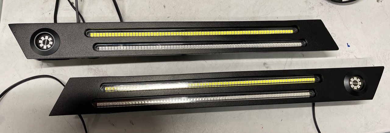

    I know it’s been a year and a half (no one who knows me would say I am quick), but I finally got powder coating done, so I am assembling these now. The bottom long strip is a VLED LPB brake light that will be my rear fogs.

  12. Aug 26, 2023 at 2:10 PM
    #152
    Puppypunter
    Puppypunter Well-Known Member
    Jan 4, 2020
    #315086
    2,688
    Johnny
    2019 Black SR
    Just another update. Got them installed finally.

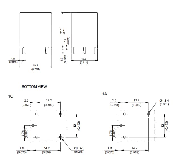

    They are their own circuit. I used parking lights as a source to the switch, and the switch (momentary) triggers a timer that then acts a latching switch. It will reset if the parking lights or the truck is turned off, so no chance of leaving them on mistakenly. The timer triggers a relay, and that turns on the fogs. Also, if I press the switch again while the rear fogs are on, it shuts them off.

    A better question is how many aftermarket relays does Johnny have in his truck.

    They're all sugarcube type...
