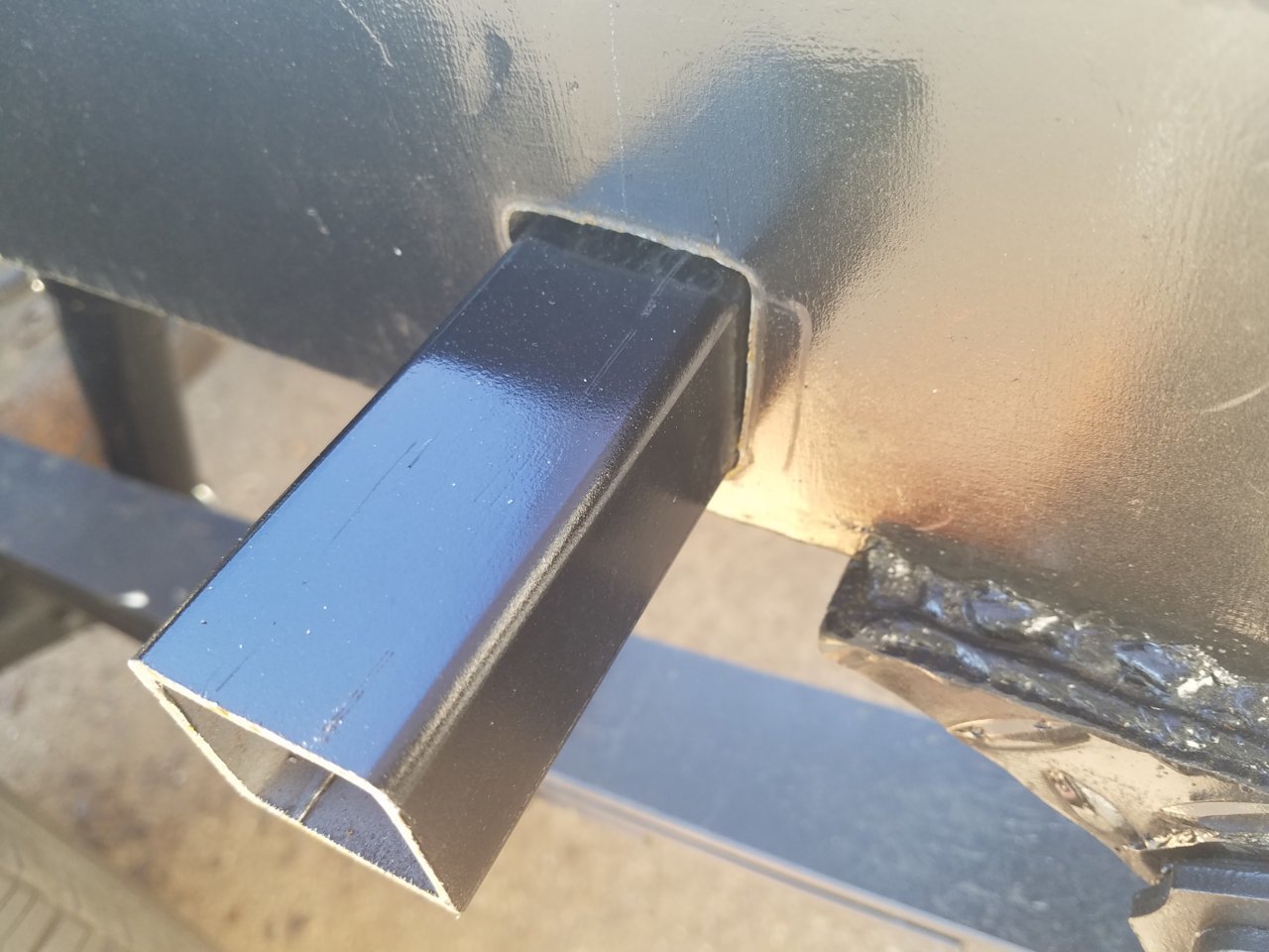

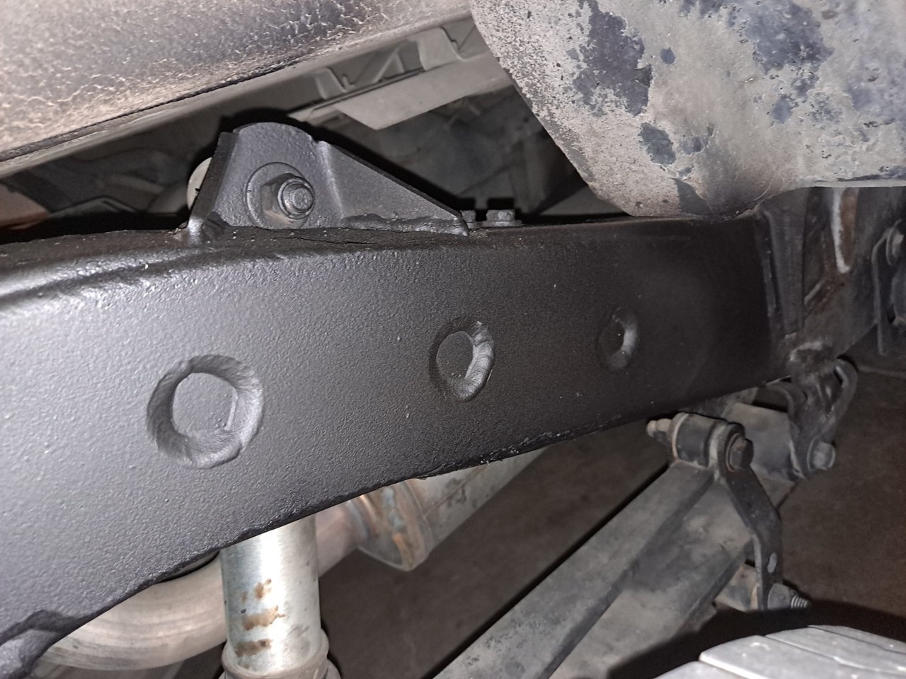

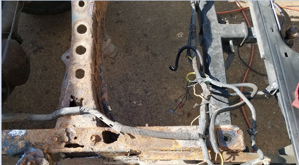

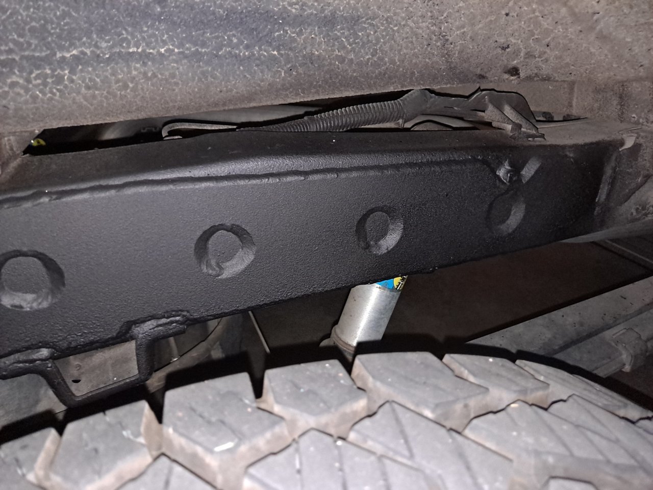

    When I repaired the rear section of my frame, I replaced the spare carrier with a home-made one, and welded some angle iron across the top of the fuel tank cross member. Cut a hole through the new frame section and slid a piece of thick walled 2"x 2" tubing through. I welded it later, after these pics. Made a frame to stabilize the tire to prevent swinging.
    Mainly, I did these steps due to rust on the original parts, but they definitely are stronger than OEM. As seen below, the spare carrier had multiple holes rusted through it. I don't really "off-road" (by TW definition) the truck, other than a little Southern Indiana mud occasionally, so not sure if this idea helps you.

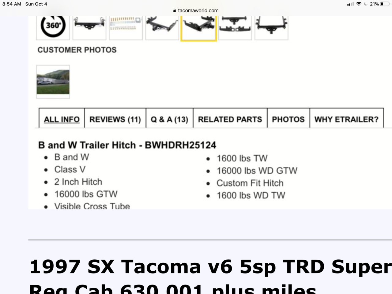

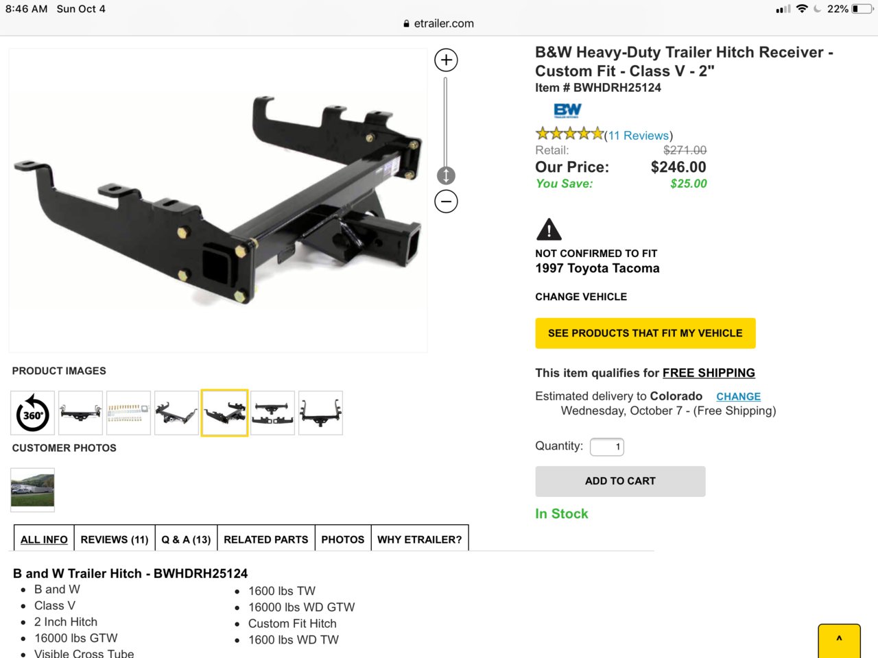

    V6 5sp,RegCab,TVS1320 Supercharger, 56mm pulley, methanol injected Haltech ECU, AC Tvs1320 supercharger,(MUST DO) every 125,000- 150,000 needs rebuild Projector headlights HID 5 speed manual Amsoil for all drive train Smaller 56mm custom pulley, (MUST DO) 2004 DESNO fuel injectors, zero ping ping, 2004 side door mirrors Dick Cepek Rims, Michelin tires LTX, ATM Pathfinders Dynopro ATM ( that last 100,000 miles) Now running Dynopro ATM mud and snow tires KN cold air intake Cat back dual exhaust with ss exhaust tip, Raised exhaust tail pipe to 2" below body line Optima*dry cell battery,red top Alpine sirius radio, 200 watt amp, focal is165 split door pod speakers Focal door speakers Subwoffer behind seat Viper alarm, Electric Locks Dark tinted windows, bucket seats corbeau lg1 Tacoma Rubber floor mats TRD fender extenders, Bilstien shocks, King shocks JBA UCA trailer iv hitch, electric brake control, Drilled slotted brakes, High carbon steel (MUST DO) EBS green stuff 7000 series pads(MUST DO) TRD engine oil cap TRD stick shift, Marlin crawl shift kit. Rear sliding window 2002 4Runner functional hood scoop cut into Tacoma hood, 4Runner dual overhead map light Gentex Auto dim + Compass + Temp, garage,rearview mirror Snow Methonal kit stage 2 Custom 3 core aluminum radiator Linex bed liner Haltech stand alone ECU, Intake supercharger gauge. Stainless steel brake lines, Custom leather wrapped steering wheel, Haltech stand-alone ECU,
    I have a class IV hitch, it’s for my double axle trailer,
    But I would think a class IV or V tow hitch would be worth the money and the frame brackets.
    Would one need anything more than that?
    Probably not unless you boxed the frame
