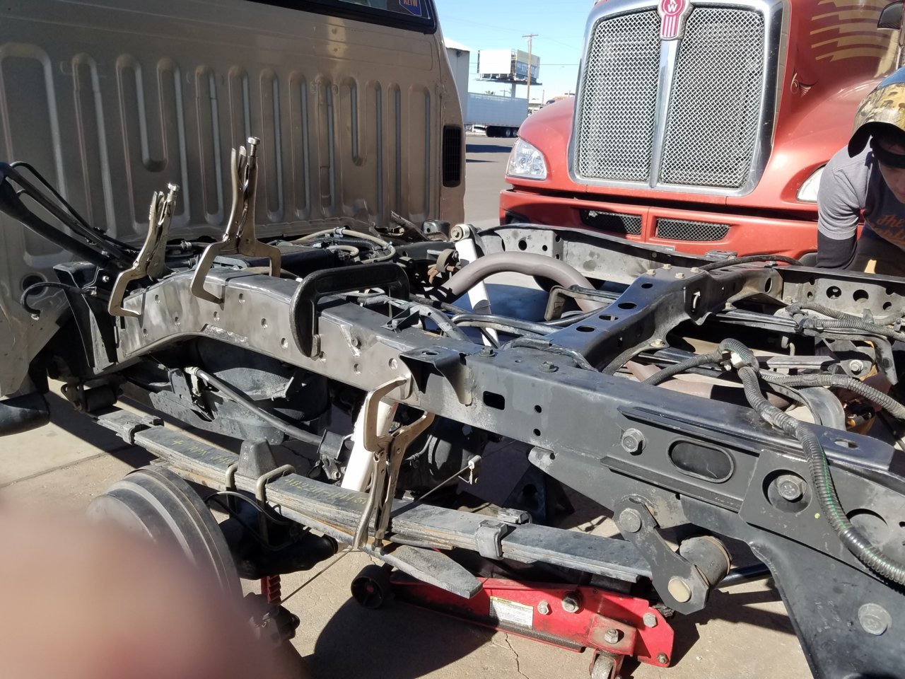

    My CBI frame plate reinforcements as I was installing them. The FROR do cover more.
    mjp2 and xtremewlr[OP] like this.

    Frame plates from tacomabeast/CBI came in today.

    Burned the passenger side on today. I'll do the driver side tomorrow.

    And finished the driver's side today.
    Bare steel, cleaned and ready for primer.
    Krylon red primer, dries fast, within 30 minutes.
    And the Krylon bedliner for a top coat. Also dries fairly fast, you can touch it within an hour or 2.
