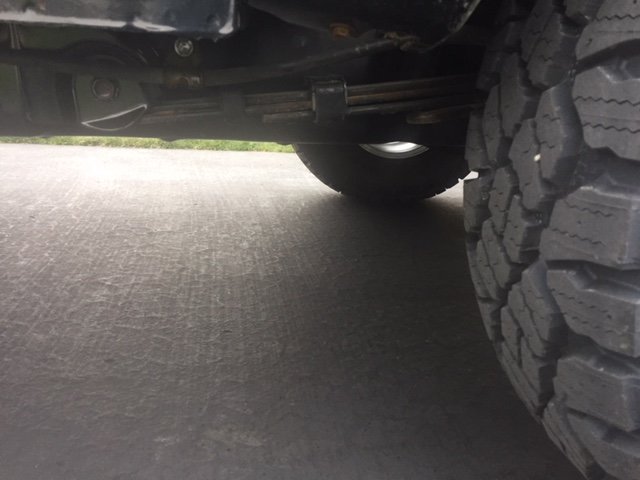

    What options are out there for a good set of leaf packs that take care of taco lean and provide 1 1/2" - 2" of lift.

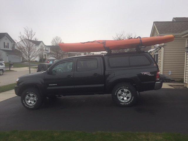

    I just got my truck back from the frame swap and my rear leaf springs are clearly not up to the task of carrying the weight of my Cap and added weight.
    I have 6112's up front set on the second setting from the bottom and my front end is sitting higher than the rear without the kayaks on top. As you can see I have a cap on the back. i know the front's will settle but the rears leaf springs are not going to get any better.
    I don't typically carry the kayaks but I do haul a Yeti 105 around with me where ever i go, sometimes full but mostly empty.
    Look at the frown of these leaf springs.
    Appreciate your help, I need to do this right the first time.

    A 3 leaf progressive with the overload left in will work. Can get one from Headstrong or Wheelers. A Dakar EL095R might give you more lift than you want but will carry weight better and still ride pretty smooth.

    You really need to do the front to get rid of the lean. A 1/4" top plate spacer will do the trick.

    I ran just a spacer, it solved the lean. Then I put in 885 coils and HD Dakar leaf packs with no spacer. At first there was no lean, but it returned in time. I now have a spacer on the driver side front again.
