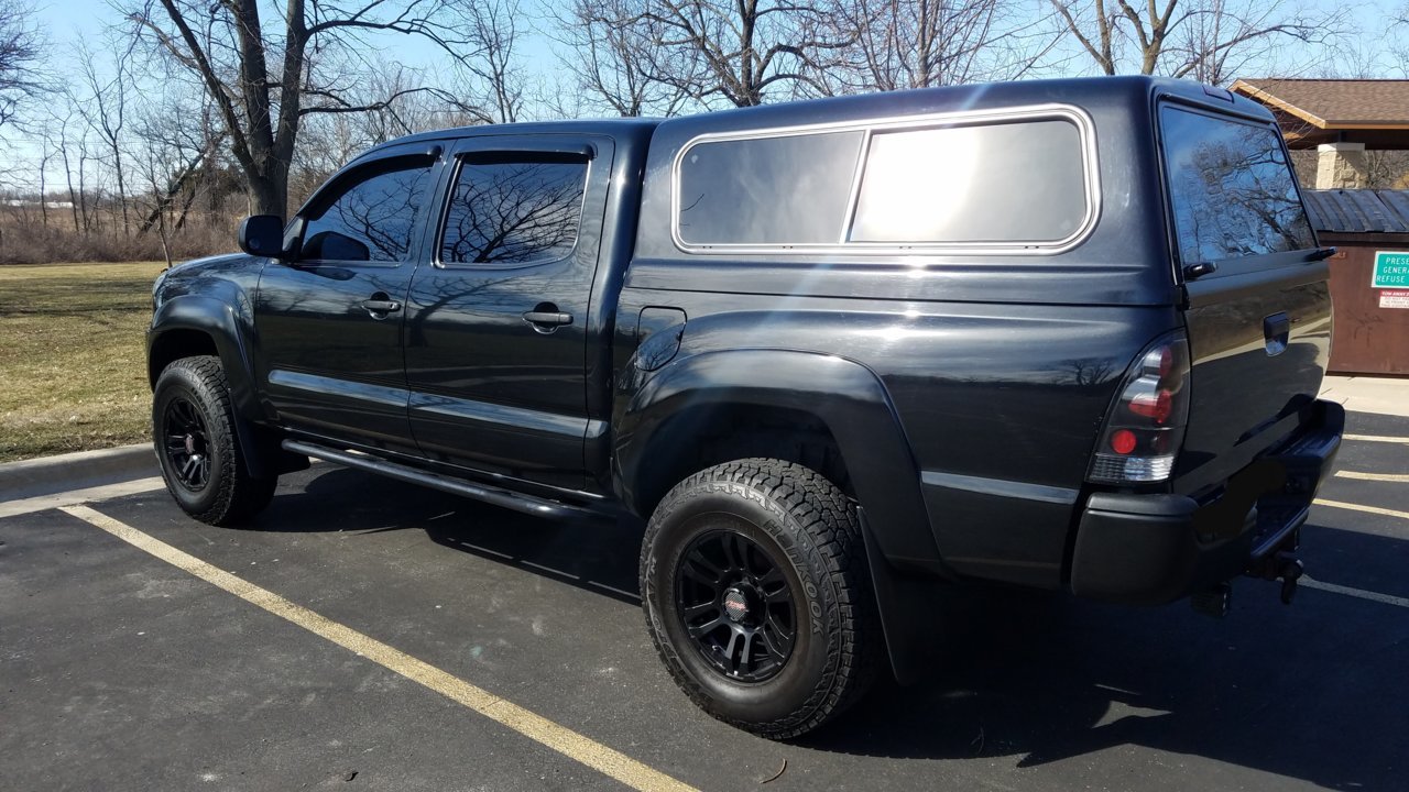

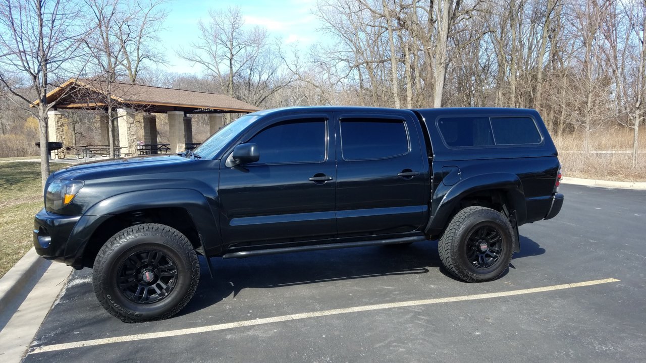

    General Spring HD leaf packs. 2 inches rear lift. I think I paid $380 pr.
    1/4" Toytech driver side spacer

    Some people a 1/4” spacer works fine. Others not so much. I had to use a 3/8” spacer

    I've got 5100's with Eibach springs. Springs set on bottom setting gives 1.6" of lift.
