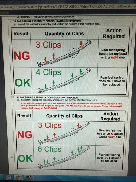

  15. Mar 29, 2016 at 2:49 PM
    #95
    CptSaveNoHoe
    CptSaveNoHoe Active Member
    Mar 23, 2016
    #182124
    27
    '08 DCSB
    My friend that is a tech at Toyota just sent me this.. Not sure if this is the only thing they are looking for..IMG_0629.jpg
    1Shifter and JDM like this.
  16. Mar 29, 2016 at 5:07 PM
    #96
    JDM
    JDM Well-Known Member
    Aug 14, 2013
    #110464
    1,158
    Jimmy
    CO
    2009 DCSB TRD OR S/C
    TRD supercharger, TRD exhaust, skids, sliders
    Part number 04005-34404, from the above pic. I haven't kept up with the topic and all the threads, so I may have missed it... but that's the first time I've seen a part number for the replacement springs.
