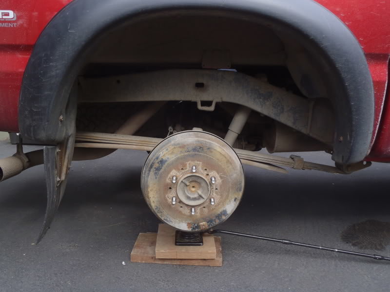

    i have a 2000 tacoma 4whl drive trd and i can't seem to load very much into it without the rear springs almost bottoming out??? i had maybe 800lbs of rock and the truck had about 1" of clearance between the bumper stop on the frame and the stop on the axle... this can't be right? what can i do? i want to be able to carry at least 1,000 lbs but would prefer to not have my ride suffer to much... do i add a leaf? replace the leafs with stock springs? with aftermarket springs? with a helper springs?

    Those leafs are done for. time to get a new leaf pack
    I hope you had a load in the bed when you took that picture

    what do you recommend i get? i am planning on replacing the shocks with the bilstein 5100 when they become available again... mid august? but should i go to toyota stock springs from the dealer? or? i don't really want to lift the truck.. but want it to ride good and carry a load... here is what was in the truck when i took the photo...

    Take a look at these, I dont have any experience with them but im sure someone else will chime in Thats quite a heavy load in the pic

    Do you have a pic of you're leaf springs without a load in the bed?

    i don't have a pic without a load... can post one tomorrow.... but the leafs are basically flat... and the gap between the stops is about 4 or 5"

    Those look pretty darn bad, but that would be expected with stock springs with the bed loaded like that. I don't have any recommendations on what to do other than getting new a new leaf pack but that would end up lifting you a bit as well. For comparison, here are my leaf spring with the bed unloaded (except my camper shell)
    They are pretty damn flat, and bottom out on minor bumps and ruts in the road when I load it up with a nights worth of firewood/gear. This past weekend I wheeled it down a terrible road full of potholes and large ruts and it was fine with the load in the bed. I've been doing that for two summers now and they seem to be fine, just a real uncomfortable ride. I am planning on replacing them in a few months though.
