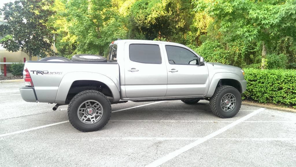

    So I’m looking to raise the rear by 1” and I’m looking for the best option!
    My current set up I have the
    TTHA-CK Toytec/Bilstein 3” lift kit
    This come with the Toytec rear Add-A-Leafs. Provides approximately 1.5"-2" of lift And Toytec Aluma Series 2.0 Rear Shocks - Designed for 1-3" of lift.
    i was sitting almost perfectly level with the front until I added the camper shell now it sits roughly 1/4” lower. That doesn’t include if I ever put/haul anything around.
    what are my option to gain an inch so I can have the rear sitting higher than the front? Thankyou!
    this is a picture of what I want to accomplish. (Stolen off another thread)

    It would be economical to go with a 1 inch block. Otherwise you'd have to change the whole leaf pack. Not sure if you could stack add-a-leaf setups, it may not be recommended.

    It's a one inch block, don't over think it. If you were going 3 or 4 inches then maybe buy a high dollar reputable brand. But 1 inch is gunna be solid material and not worth the price for a big brand. Might be worth it to shop around for highly recommended u-bolts though. Although I've used cheapos in the past on my old lowered 07 5 lug and never had any problems.
    Supreme Suspensions - 1" Rear Leveling Kit for 1995-2020 Toyota Tacoma 2WD 4WD | High-Strength Steel Lift Blocks + Square Bend U-Bolts https://www.amazon.com/dp/B08JCF41NX
