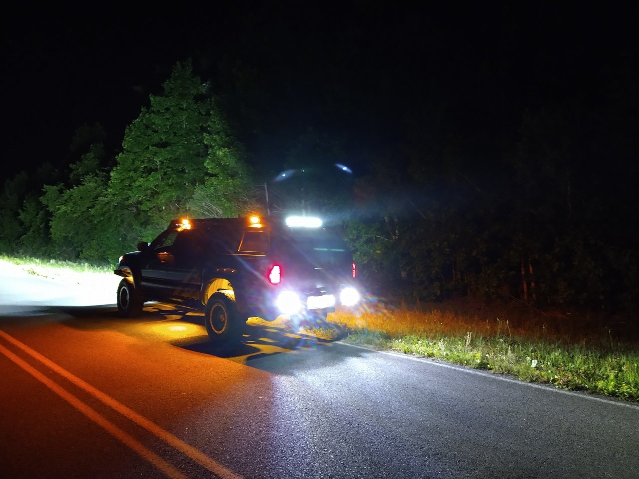

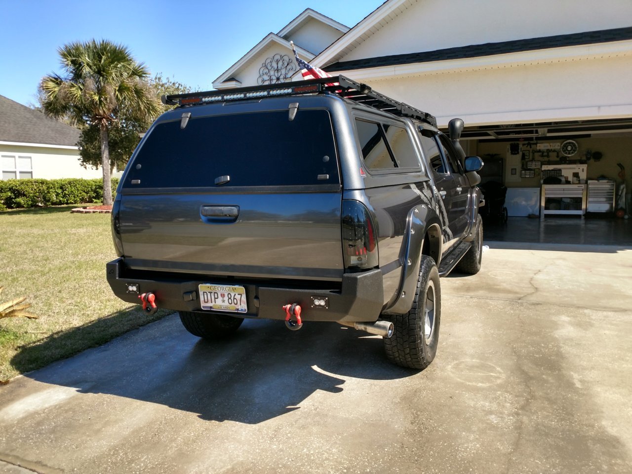

    Does anyone have a recommendation for a rear LED light bar with sequential turn signals and brake lights? The light bar I have now doesn't get much use. The Baja's in the rear bumper get used more. Thank you!Mar_2021_Rear.jpg All_lights_Rear.jpg

    What I really want is to replace the light bar on my camper shell with a light bar with sequential turn signals, brake light and reverse light.
    I like the features of the stick on stuff but the price-point is juuuussttt close enough between the Baja and the Putco/OPT-7. I agree the OPT-7 looks better but I've heard the same on performance.
    My hitch connect is hidden behind my license plate on my Pelfreybilt bumper.
    The Feniex stuff is cool but I don't think the price-point matches my application.
