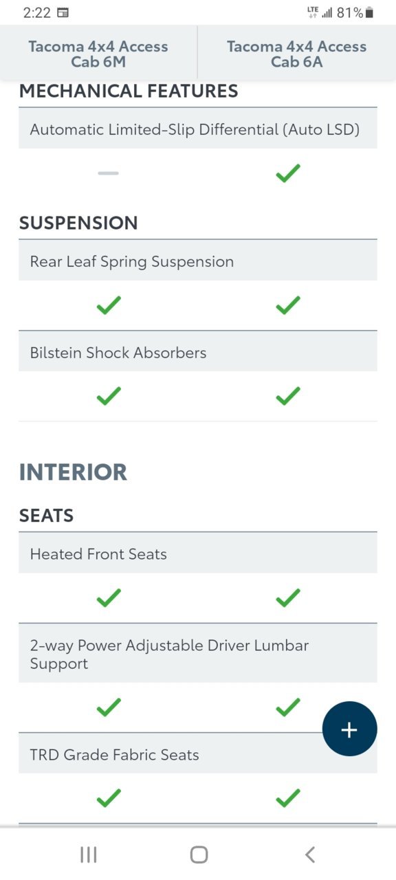

    The OR has it, just an oversight on the website.

    My 6MT OR definitely has it. Darn marketing folks…
    Edit: apparently I took that picture in Australia!

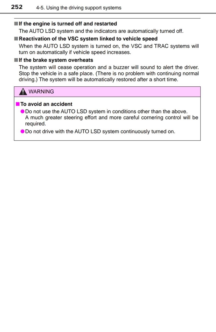

    This is from page 252 of the manual. It doesn't indicate a speed but it does say that AutoLSD does turn off and VSC and TRAC turns on based on speed.

    So, from what I've seen, the VSC and TRAC reenable, but Auto LSD stays enabled. I always use Auto LSD when I'm working in the fields, helps out a little when I don't wanna be in 4x4.

    I've observed VSC and TRAC re-engage around 30mph on my truck.
