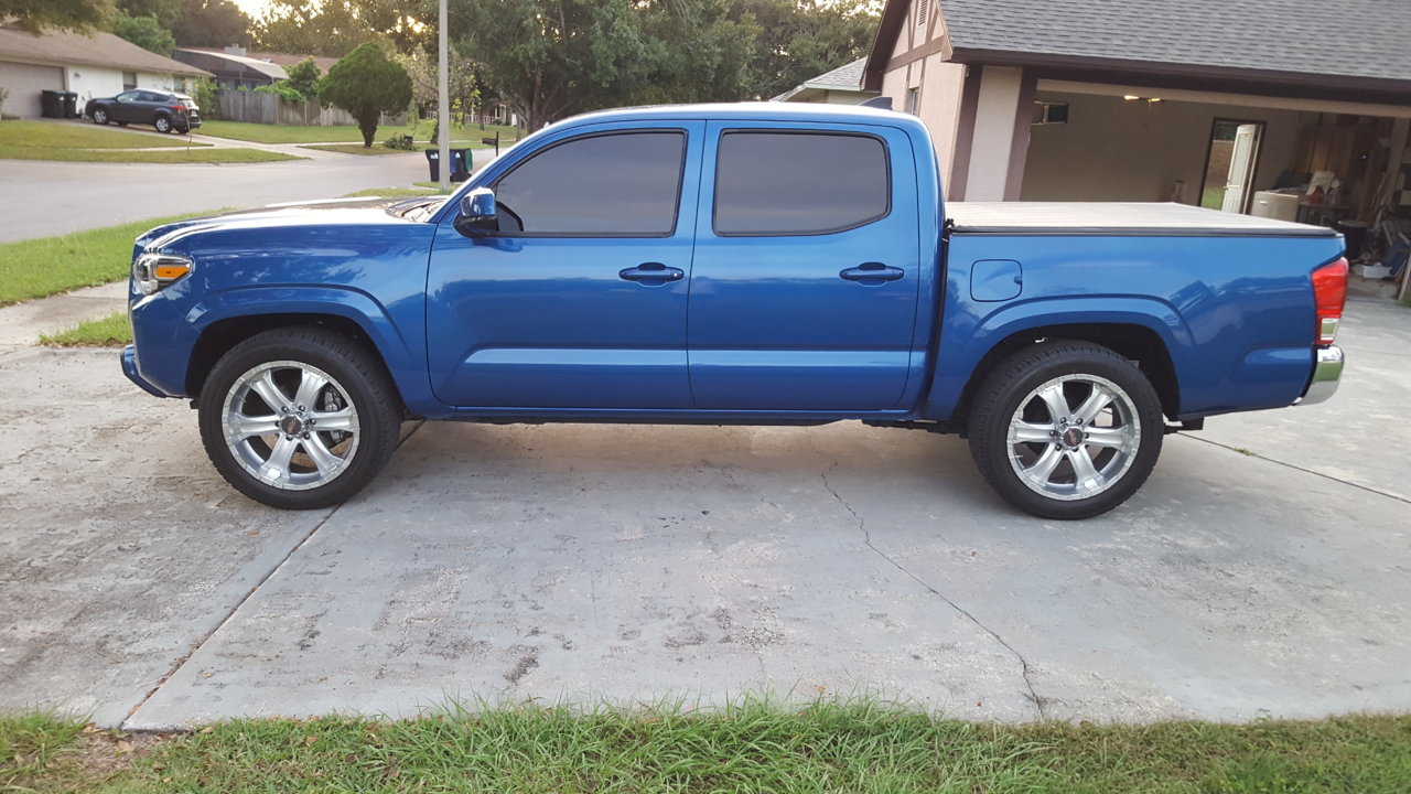

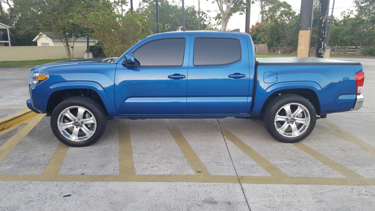

    sos. do the whole thing. 1st pic just rear done. rides great!

    Wasnt sure i like the idea until i saw this pics. Looks really good man!

    holy shit. the front looks great

    i meant the truck looks great!

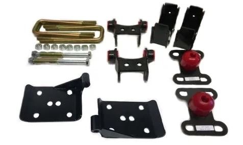

    The tundra racing/SOS performance kit is nice, im running it on my truck
    Here is a pic with the 2" up front and 3.5" out back- has about 1" rake
    Here is a pic with only the rear 3.5" drop installed- has about 1" bro lean

    Yes sir, rears are part of the top plate for the SUA conversion for the drop. heres a pic of those1.jpg
