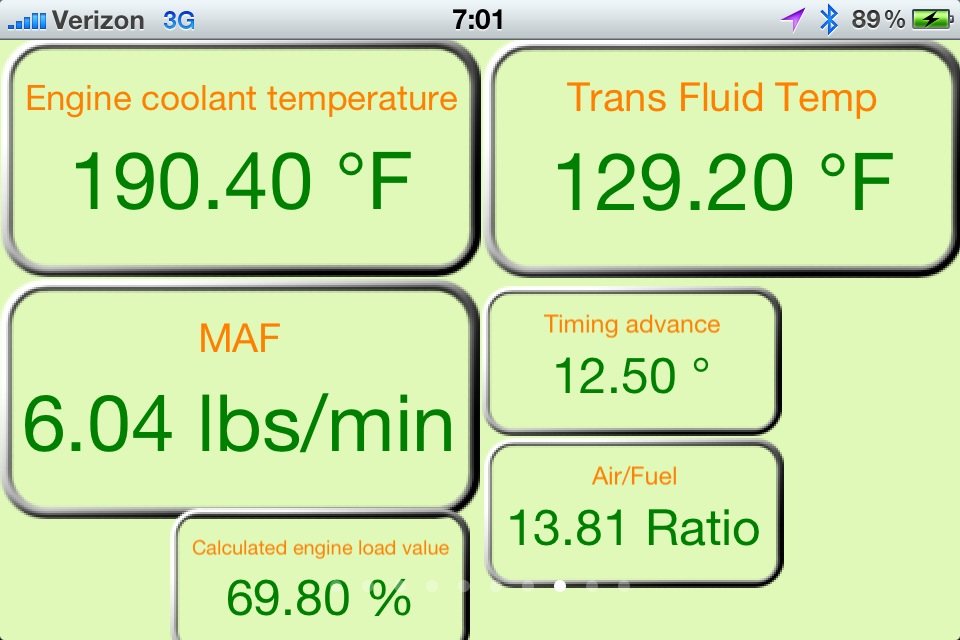

    Doesn't appear to be working for me. My OBD2 scanner is reading 0.0v for the rear O2 sensor. We'll see if the CEL pops back on though.

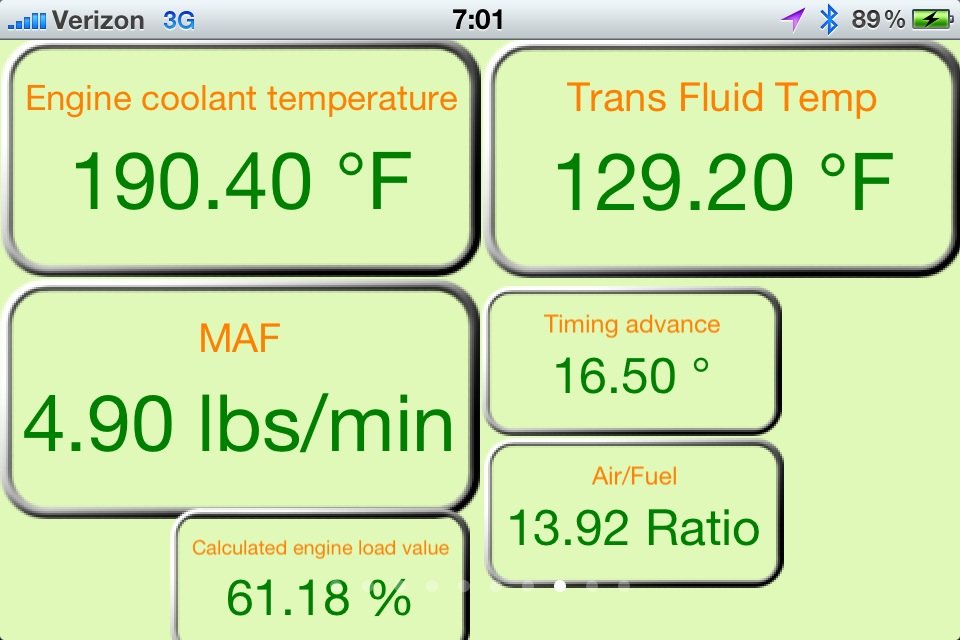

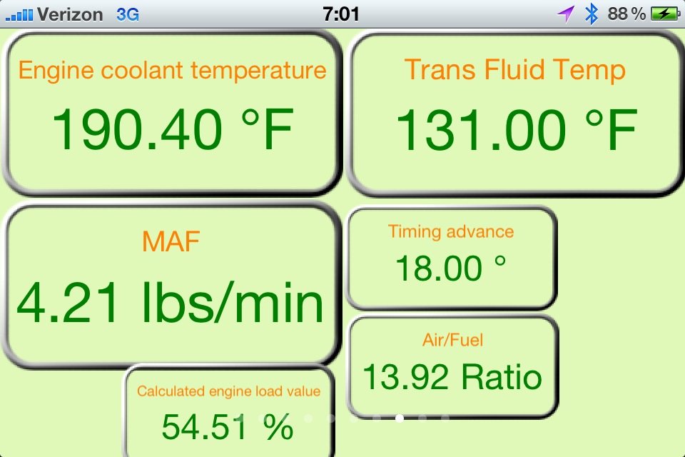

    No CEL yet, but a weird observation. My AFR appears to have richened up by 0.5 to 1 point. Typically in closed loop it stays right around 14.7. This could be because I didn't reset the ECU when I did this mod.

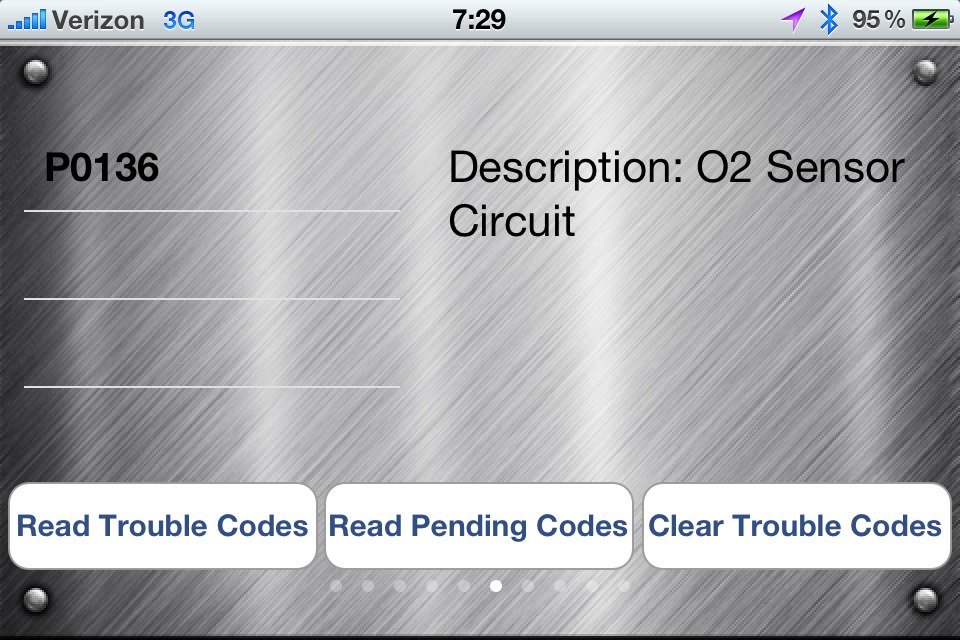

    Got a P0136 code. This mod doesn't work.
