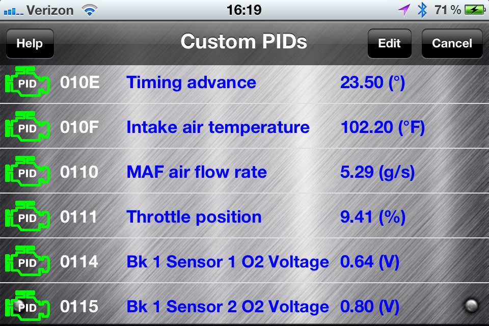

    Reversed the mod and heat shrinked the rear O2 wires back to stock. Rear O2 activity returned to normal, and AFRs returned to 14.7:1.

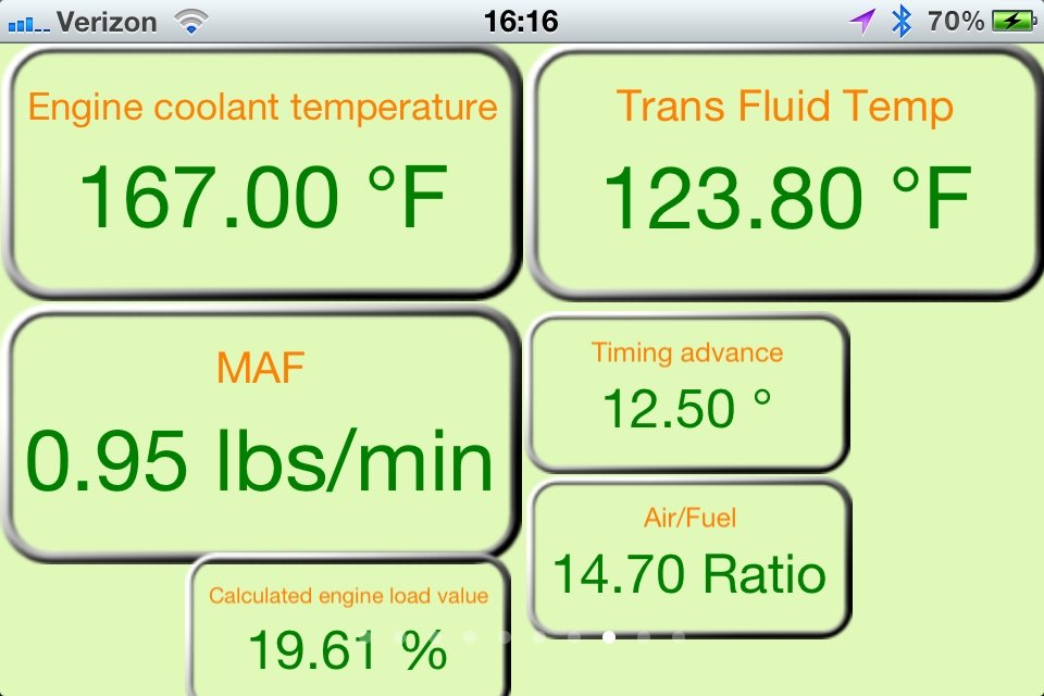

    What app did you use? How did you get the trans temp?

    Engine Link app on my iPhone. Check out my write up here:

    Ok, I think I figured it out. If your OBD2 scanner is reporting 0.0v for the rear O2 sensor, then you've done the mod incorrectly.
    I think the original instructions in this thread are kind of vague and sort of misleading. The way I interpreted the instructions are drawn out in my first diagram labeled "incorrect". After Googling, I realized that I had wired this thing up wrong. The second diagram, labeled "correct" is how it should be done.
    I'm now getting a voltage signal from the rear O2 sensor again. It seems to hang around 0.5 to 0.4 volts typically, whereas before the mod, the values would bounce around quite a bit. I'll drive this around for a while and report back on whether I get a CEL or not.

    My phone is a android but does the torque pro app monitor trans temp on 1st gen Tacomas?

    Yeah, it does. I've not used it myself, but there's a long thread about Torque on here somewhere. As long as your truck is '99 or newer, you can monitor transmission temps.

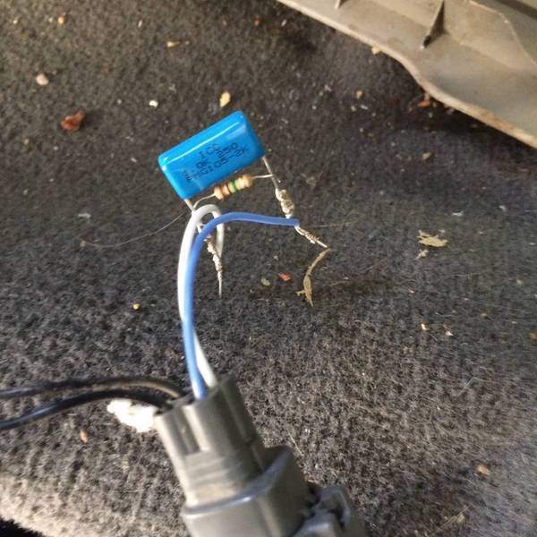

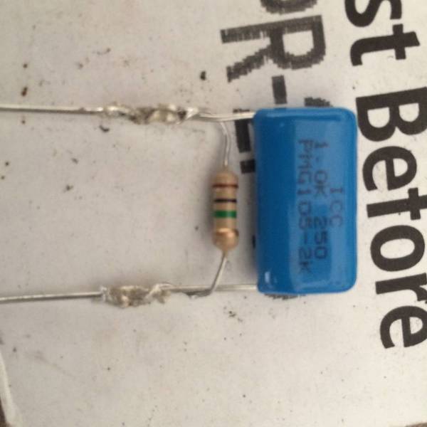

    [​IMG][​IMG]
    So since I'm a double cab my connection was under the front passenger seat.
    I removed the seat lifted up the carpet and there it was. This is how i set it up. I also disconnected the battery before anything was done. I'll update this post in a day or two. Runs for a while. Fingers crossed.

    Update.... So I ran this mod for a day and my O2 was reading 0. So I switched it to the way the 4runner has it done and now i'm reading the O2 is reading 45 or so. On both mods the check engine light was off. Right now the way I running lean. 14.28 I also had the truck put on a dyno to really check the reading form something other then my app. So my question is is 14.28 to lean?
