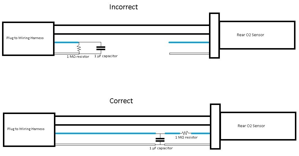

    do you put this in line WITH the blue and white connected at both ends or does this bypss sensor and send signal without ever going into sensor? anyne ever had probs with plastic outside clip having one less notch?

    stock
    Yes and yes. Don't know about the last. Finish the harness circuit between blue and white with the mod. Make sure you use the wires going back into the harness,,not the ones you just clipped off the sensor,,savvy??. You will make a dummy loop circuit,,lol. It tricks the comp into thinking the sensor is reading ok. Don't touch the black wires with anything sharp or dull. Report back if it helped or whatever the outcome. Good luck.

    ok had to buy sensor..the resistor mods had no effect because mine wasn't showing ready,,It has to show READY and be bad for THAT mod to work.So Ineed to drive it...lost the one bad code...So Imma drive it tomorrow for about 100 miles and see what happens

    the mod I tried SEVERAL version until I found end...you have a guy in an O2 thread that says he CUT the wire to the sensor and put the cap and resisitor in a loop went from cut blue to cut white towards clip...Doesn't work the only one that LOOKS like it might haven't tried but MY SENSOR WASNT BAD it wasn't showing ready..and MOD only work when sensor isbroke and showing engine light

    Posting this info in the hope of being useful to someone. I have a 2000 2.7l 4runner with 310,000 miles. It started throwing P0420 codes during the summer a few years back. Tried this mod and (correctly!) wired in the resistor and capacitor. Went about 300 miles before I got a CEL on with a P0136 code. It was the first time ever for the P0136 code. Reset it and crossed my fingers. It has been since May and 5,000 miles and the CEL has remained off with no codes being thrown. I did notice something interesting, though. The Cat readiness monitor still shows "not ready". However, I was able to pass emissions with that one not ready. It's my daily driver and I have not noticed any effect on gas mileage.

    The CEL on our 2012 Camry was persistent after our daughter hollowed out the catalytic converter. We tried the spark plug anti-foulers, and that did not work at all. We found this schematic and tried it. First with the 1 resistor, and 1 uf cap. That did not work. Then we saw the schematic with 2 resistors. Tried that, and it did not work. Then, we saw using a 4.7 uf cap. Tired that, and it did not work.
    After all that, we ran across this thread and saw the PIC you posted. we decided, you know what-- let's try the incorrect version. Believe it or not, that is what FINALLY WORKED!!! No nintendo, but it is what it is.

    After looking at several different diagrams of different ways to bypass the o2 sensor, and trying several different variations, NOTHING worked on our 2012 Camry.
    Sat down and reviewed several different diagrams, and something didn't sit right. It was like they were incomplete. Went ahead and designed my own version of this bypass.
    Used 1 - 2.2 UF 50v capacitor, and 3 - 220k Ohm 1/2 watt 5% resistors. NOW- the light is out completely. If anyone else is still having issues, try out this. It worked great here.
