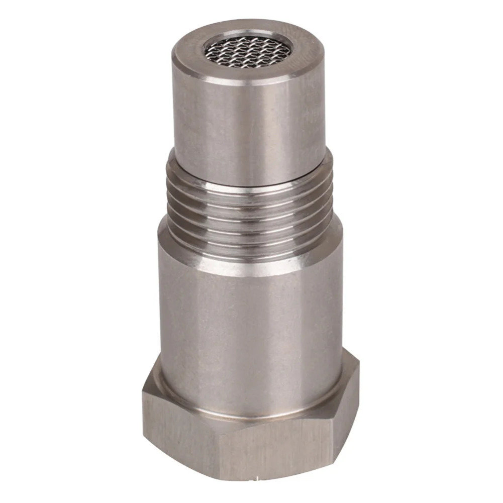

    Ahh man guys i have had this F’ing light on for 3 years now on my 2000 2.7 sr5 cali emissions. Need to get emisions done one last time and trying to figure it out. They stole my cats, i replaced them with the cheapest cats i found on eBay expecting them to throw a code and then just bypass it with spacers. Well the spacer aint working and im not spending a bunch of money for real cats. Im not versed in all this electrical terminology and pretty much know nothing about resistors and capacitors and stuff. I tried reading through all this but i cant seem to figure out what the final verdict is. Is there a youtube video i could follow or something. Im not a mechanic but i went to automotive school and then endend up not working on cars for a carrer. i do everything on the truck, just pulled the head last year and brought to machine shop cuz of a burnt valve. ( thanks to the haynes manual) So im capable of doing whatever is needed i just need clear instructions or a final verdict on what works and maybe i can figure it out from there. Thanks! I love my truck but damn these emission codes suck.

    If they only check it by connecting to the OBDII port, then you should be good with this mod. The voltage readings from the downstream oxygen sensor would be all they could look at, which will appear as the catalytic converter is functioning properly. Wrap up the wires nice and neat afterwards, and you probably are in the clear.
    That being said, you will probably have to ditch the spacer if you wire in the resistor and capacitor, or it may still throw a code. Not to mention, it's easy to spot. Don't make it easy for them.
