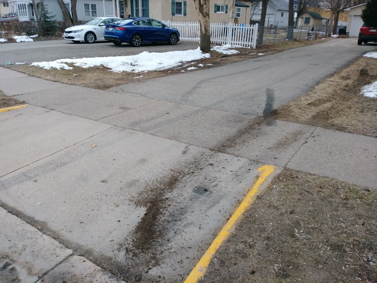

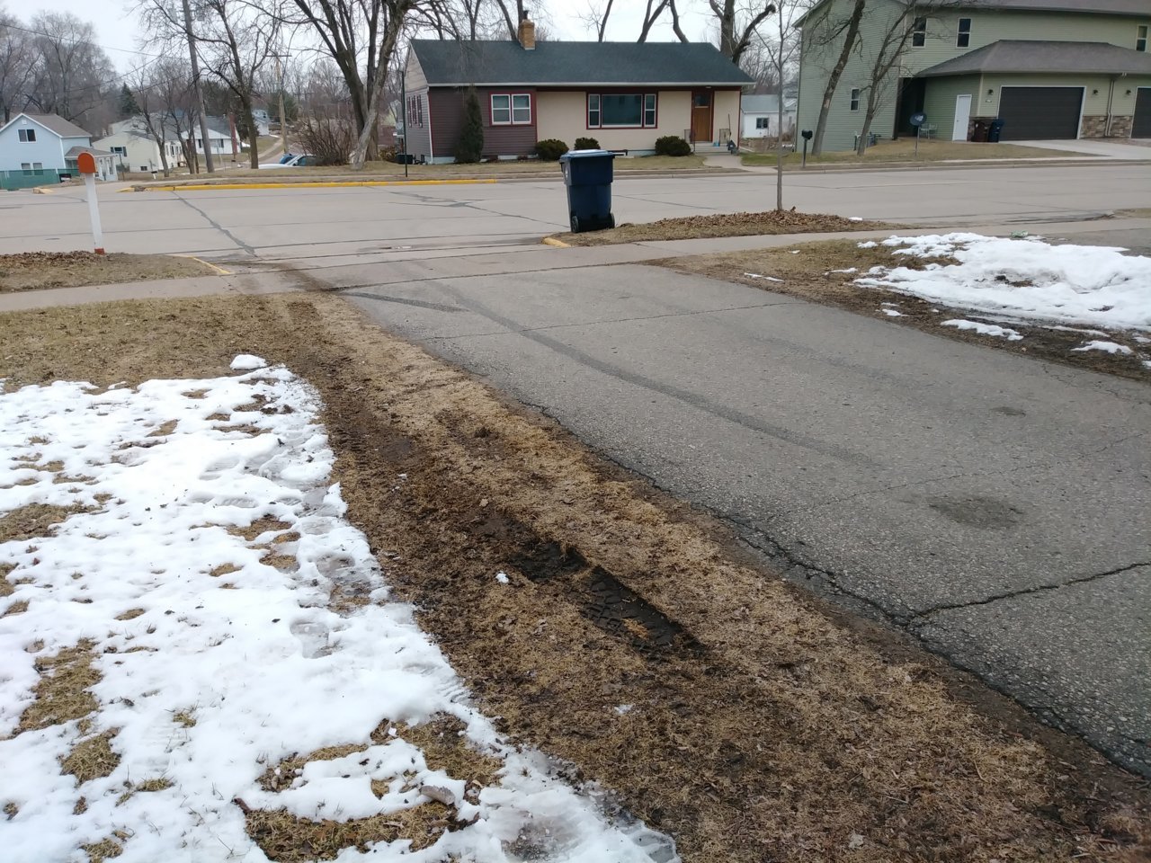

    Here are two pictures of my driveway and the skid marks I made. First I tried gassing it in 2wd with no results i wasn't moving at all. I then put it in 4wd and made it half way out my driveway. By this point i knew i was fucked and got my dad to pull my out of the street with his rubicon.
