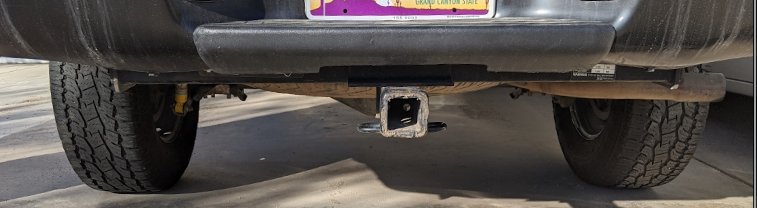

    I'm asking if I can have a hook or other recovery point without the hitch.

    You can if you get an aftermarket bumper.

    There is a hole for a ball on my bumper. Yes, so within reason.

    Remove the plastic cap on the bumper step to reveal the hole for a tow ball:
    Instead of a tow ball, put a soft shackle through it. It's only rated to 3500 lb, so you have to carefully estimate the pulling forces involved.

    Hack that receiver off and as needed wrap a strap around the structure the hitch is attached to.

    I like this idea. The bottom ones would be slick if they fit around my bar. Getting the hitch tube off looks like no small task with an angle grinder. I don't have a torch.

    I would leave it personally. I have dragged my hitch through some stuff but has never really been a problem for me. Honestly like that it is there because I would rather be hit there than just my rear bumper. Thing would fold up in no time, and a well placed sharp rock could put a hole right through the spare tire sidewall.
    Here is a video of my truck doing elephant hill. You can see in the end it does drag the hitch, but until I get a real steel rear bumper I would rather drag the hitch instead of the stock bumper.
    Edit - you should start with chopping that exhaust pipe. That is your real low hanging fruit...

    My hitch says 5000 on it, so not hugely different...

    Rule of thumb for pulling forces on level ground:
    1x vehicle weight when buried to the hub
    2x vehicle weight when buried to the top of the tire
    Additional derating factors apply on inclines or if there's a tire- or suspension failure.
    Assuming you have half-decent tires, it's unlikely you'll be stuck unless buried to the hub or higher, so pulling from the hitch is safer.
    Also you can deflate the spare to give it puncture resistance. Obviously only do this if you have a tire compressor in the truck at all times (I do).
