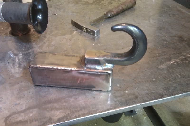

    I actually just made myself a tow hook for my receiver hitch. I still have to drill a 5/8" hole in it for a pin. and paint it black. I made a 6"x2"x2" OD box out of 10 gauge steel ( .135 thickness) and then welded a tow hook to the top. I found the hook at a parts store for $8. Steel cost me nothing.

    For those of you considering a tow hook, DON'T. For safety, you need a fully enclosed loop, otherwise the strap can come off. I refuse to recover/tow anyone who doesn't have a fully enclosed loop.
