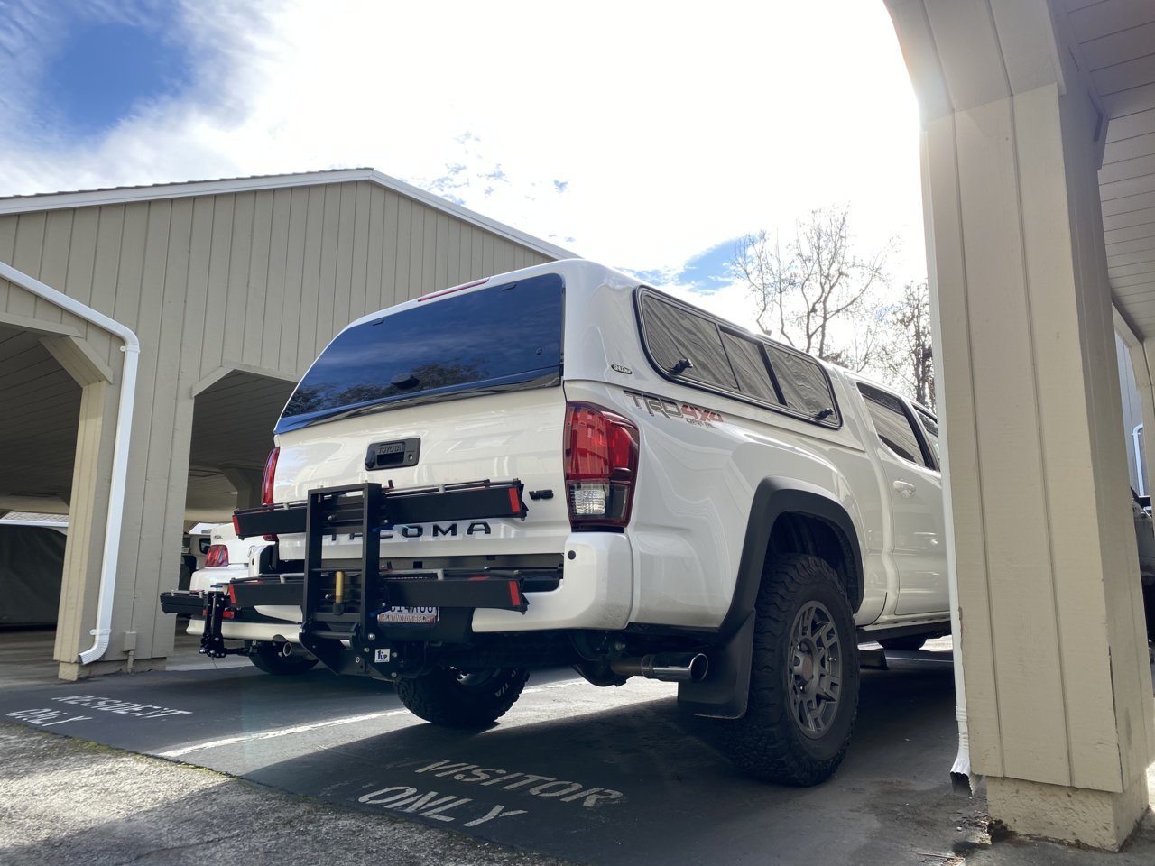

    Does anyone know what the best rear recovery point is for my 2019 Tacoma BESIDES the hitch receiver? The hitch-mounted shackle would be a great option, except I usually travel with bikes on my hitch-mounted 1Up rack. I’d prefer to find a rear recovery point that wouldn’t involve removing the bikes/rack.
    Not afraid to drill into anything, but I don’t want to hinder my warranty or alter the structural integrity of my frame.
    Let me know if you have any ideas, thanks!

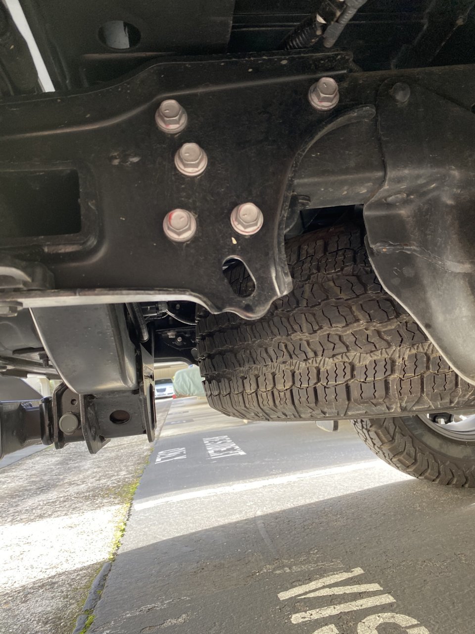

    These are the other two holes on the back of the truck, but they don’t look strong enough for recovery. Are there additional ones I’m missing? If you can include a photo that would be great, thanks!

    Good to know, thanks! Seems like I might just need to remove the bikes and use the hitch receiver for the safest recovery with a stock bumper. Not the end of the world, but I’m keeping my eyes peeled for alternatives.

    I'll bet that Toyota has some sort of bracket in mind (either OEM or aftermarket) that would use that elongated hole plus the 4 bolts immediately above it. Notice that the flange has a gap in it that would allow this hypothetical bracket to lie flat against the frame. Five heavy bolts would make a strong attachment. Stronger than, say, the Demon bracket that many of us are installing at the front.

    Good idea! I personally used that hole for my air compressor chuck :wink:
