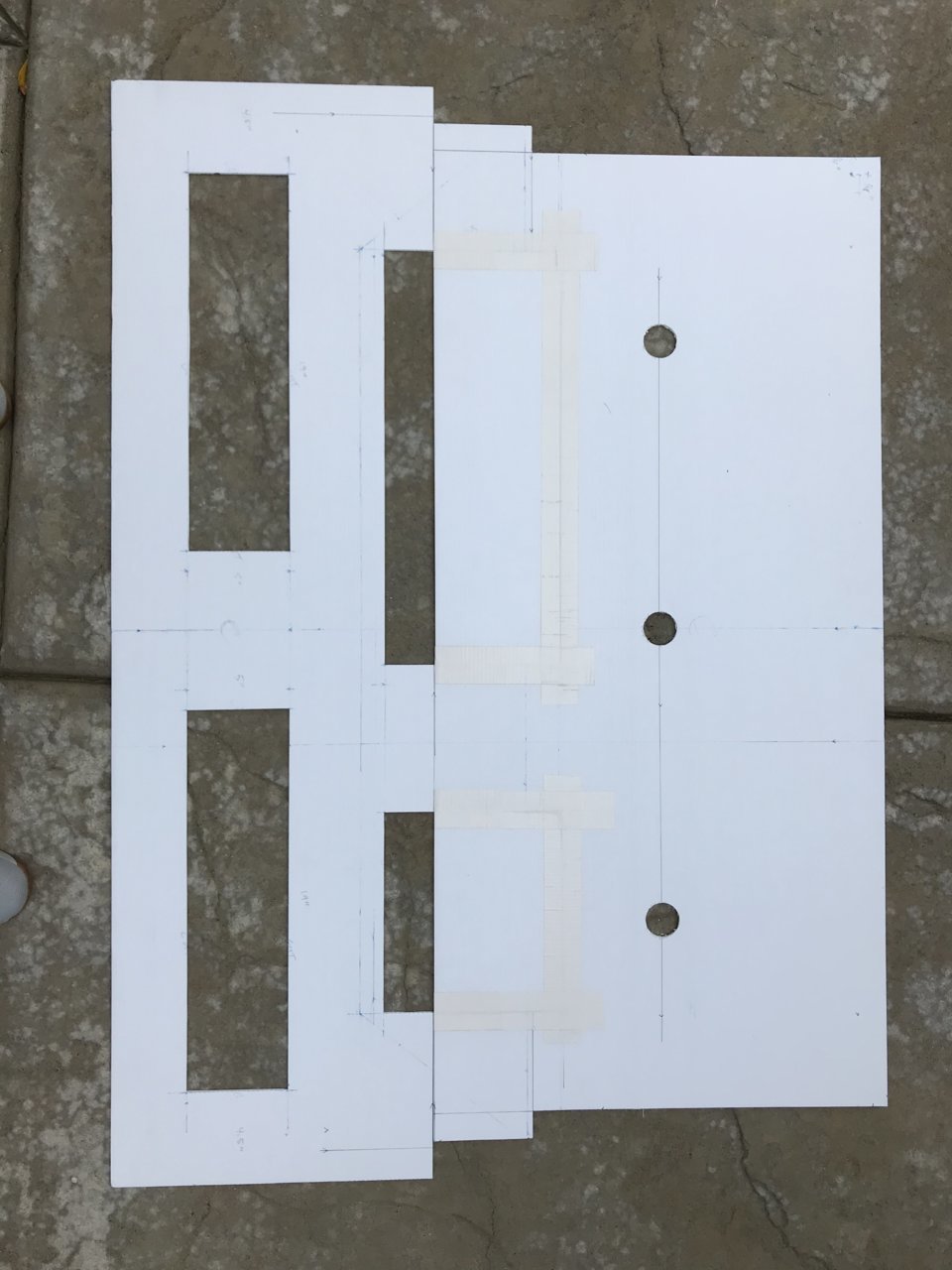

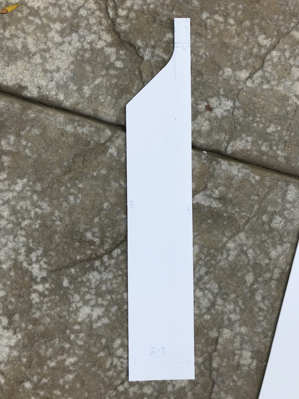

    Here you go, like I said it’s not much but it should be a good starting point. These measurements worked for me but might not for you. The template is made with corrugated plastic (Home Depot). I’m glad I went the template route. Measurements did change after fitting the template.
    The base is 3/4” birch and back, sides and fronts is 1/2”.
    You can picture the base template before I cut it up to make the back template.
    4AA54166-286D-4962-BAF5-6B898FB16308.jpg D198741A-605A-4098-8638-248C0483E421.jpg 2C6A3F4C-15D0-498D-8B44-396F8A2FC917.jpg Pink sticky notes are the final measurements I used. Note: if you’re long legged or roll with the seat all the back you’ll need to modify the depth measurement on the base.
    389C0EA6-35AC-4AF9-91FC-6100A0797B4F.jpg D9692A2B-2D56-4361-94C4-35A668724C65.jpg If you have any questions let me know. Enjoy guys and good luck with your project!

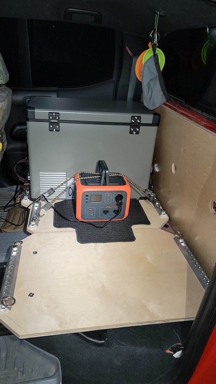

    Still some work to do but this has been quite a journey of folly (I'm a hack) and I'm thankful for everybody's smart input in this thread.
    Let's see:
    splintered ends,
    misdrilled holes,
    sanded clear coat,
    numerous bolt containers raided,
    rained on (in Utah no less),
    and warm beer (no longer!)
    Carpet, sound deadener, square bracket holes and storage solutions (?) up next.
