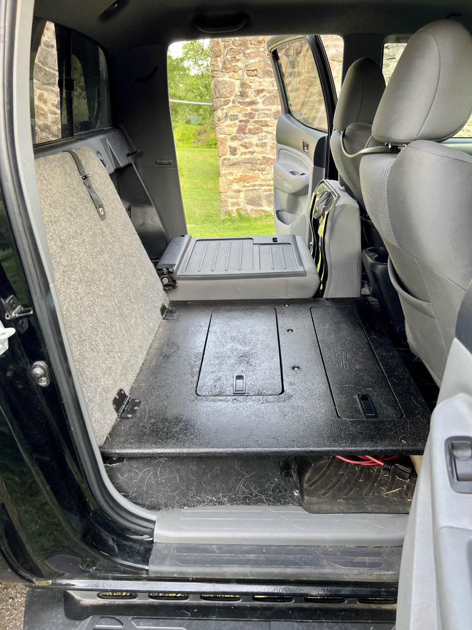

    Did you remove the cab vent for the installation of your Molle panel?

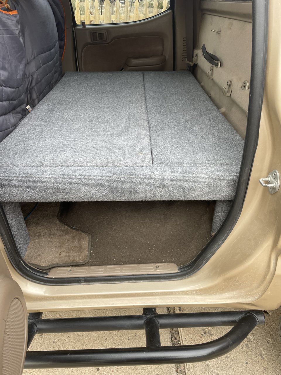

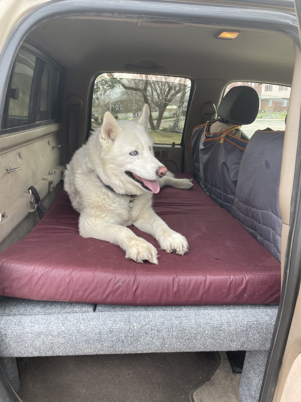

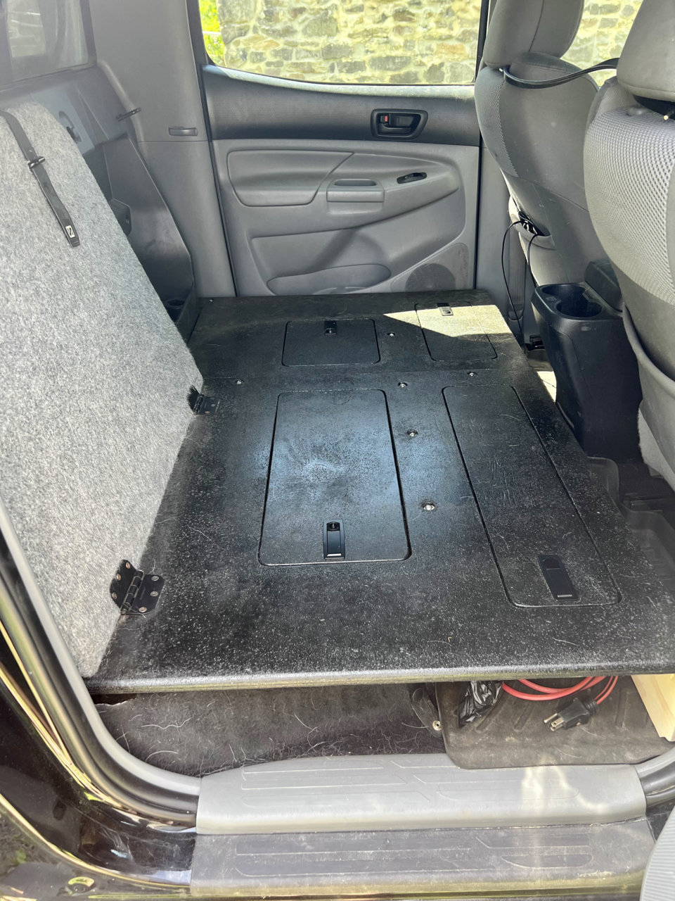

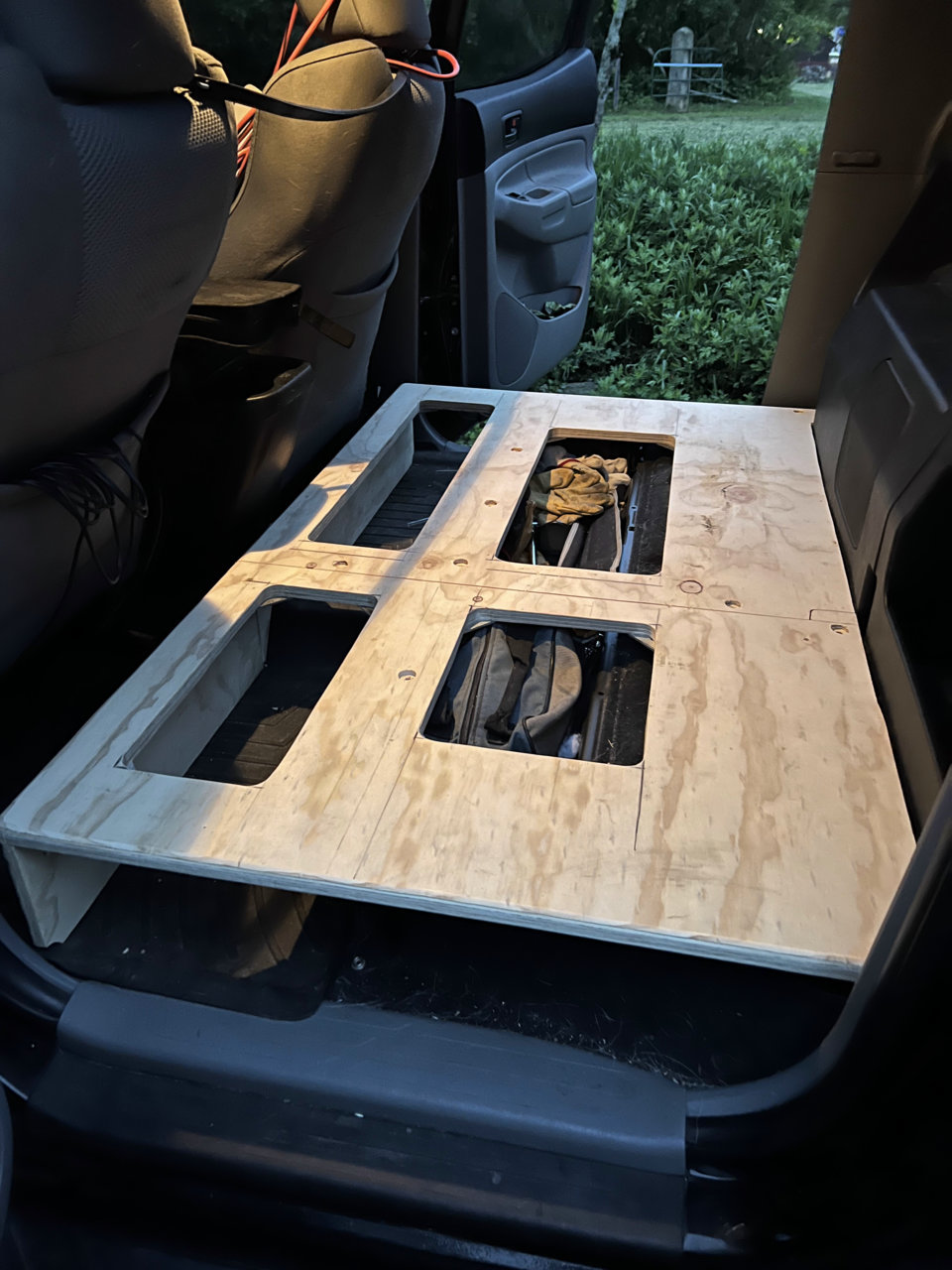

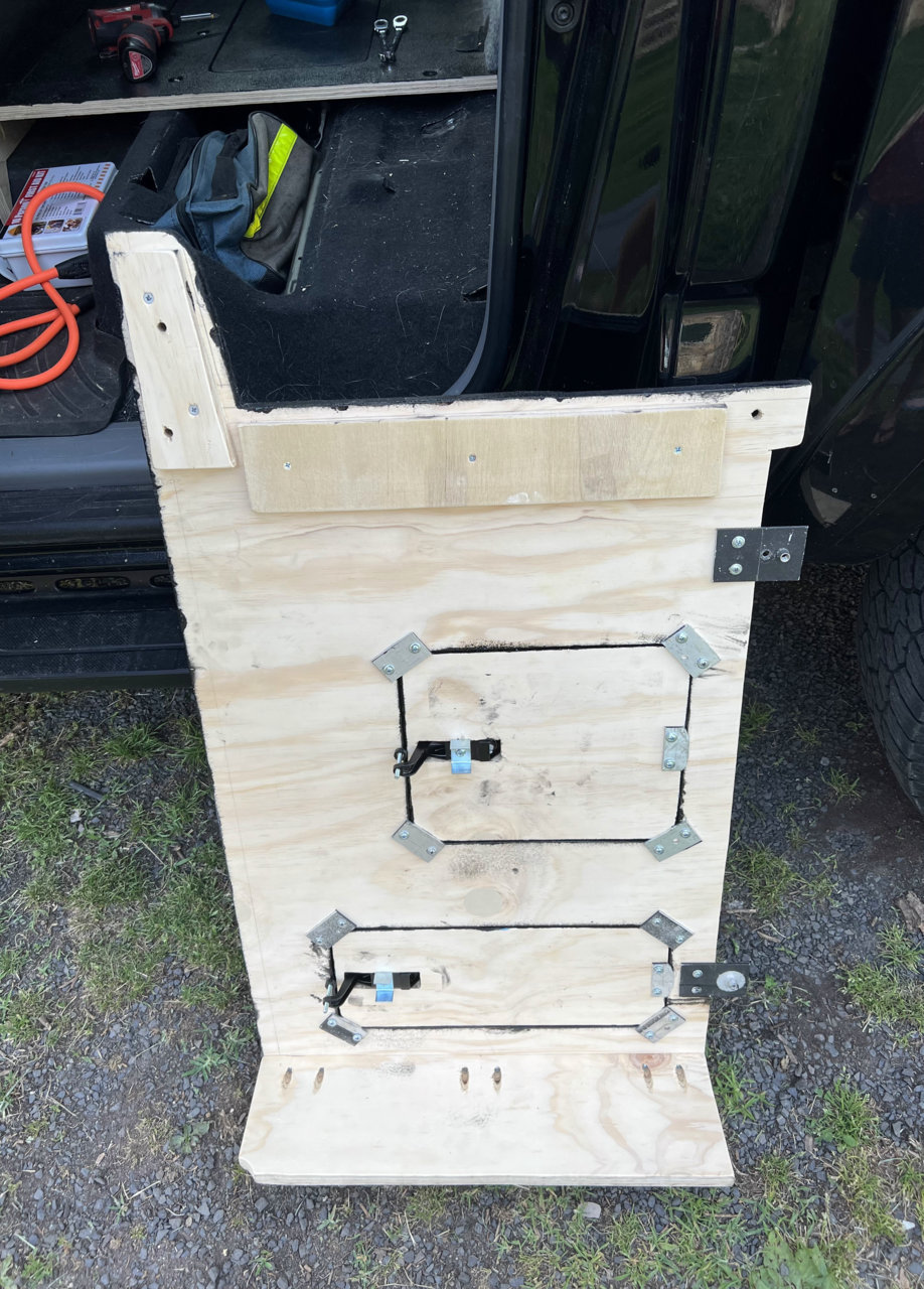

    This was a fun one. Thanks OP and all the others. Really liked the look of goose gear and the versatility of the 60/40 split, so tried to copy their design. My most useful mod so far and the dog approves too. Also the first time using a pocket hole jig and router and now I'm hooked.
    Got to reuse the back piece from the "Double Cab Folding Dog Platform" mod that served me well for a year.

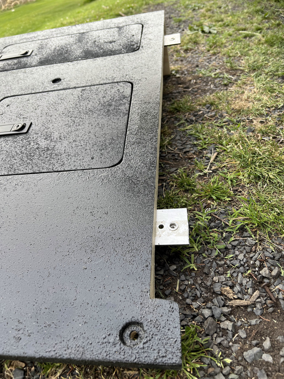

    Made some joiner brackets to lock the pieces together with scrap aluminum and rivnuts.

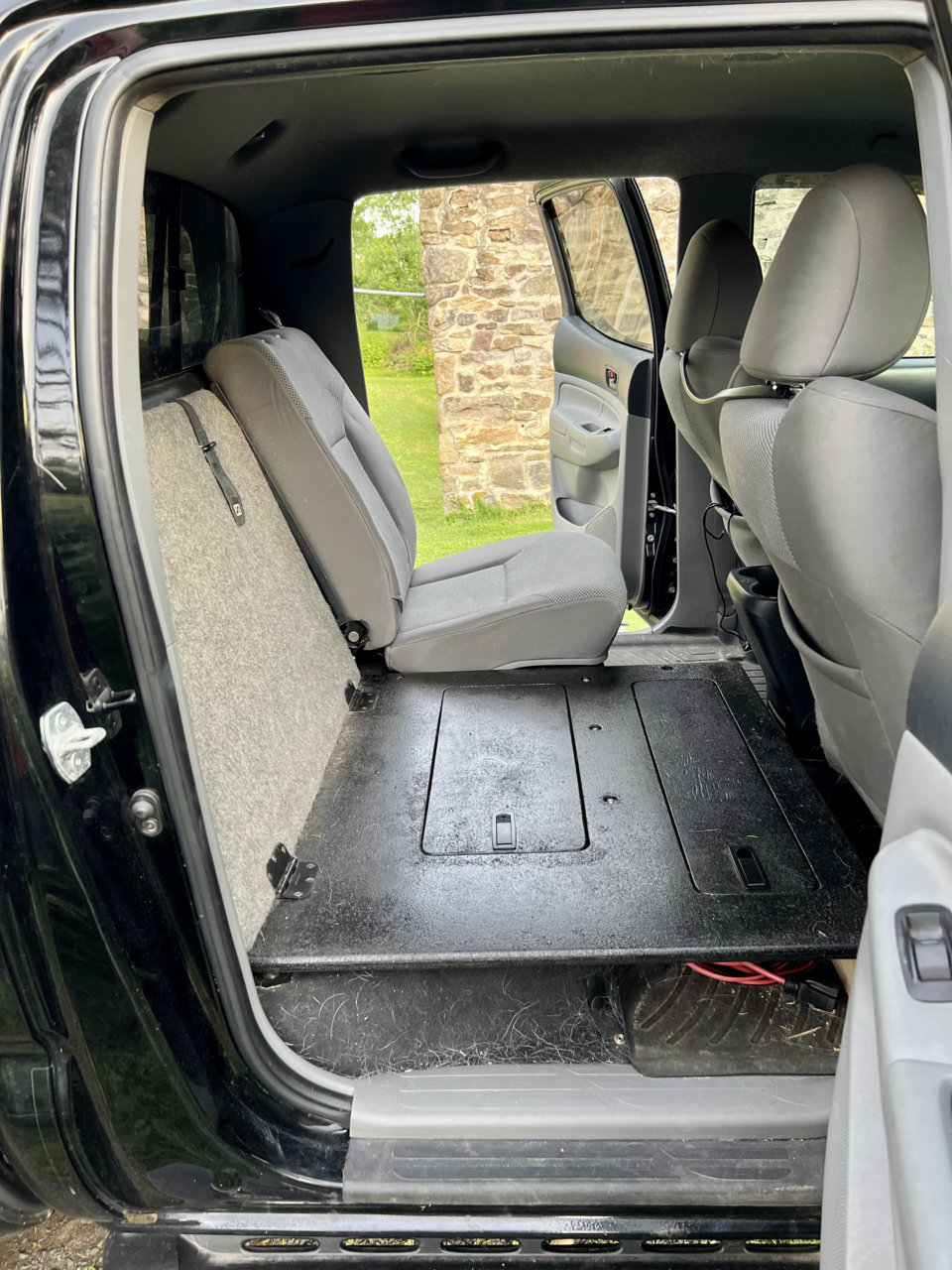

    The single seat can go back in if needed.
    Wet dog tested.

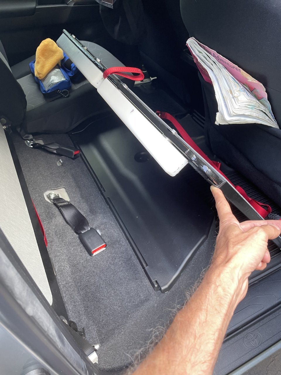

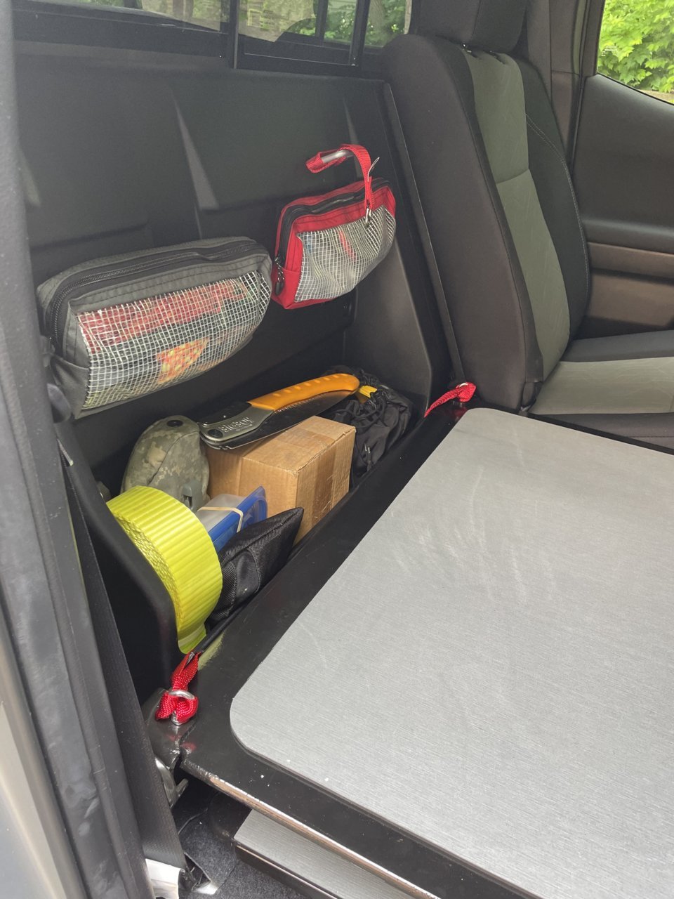

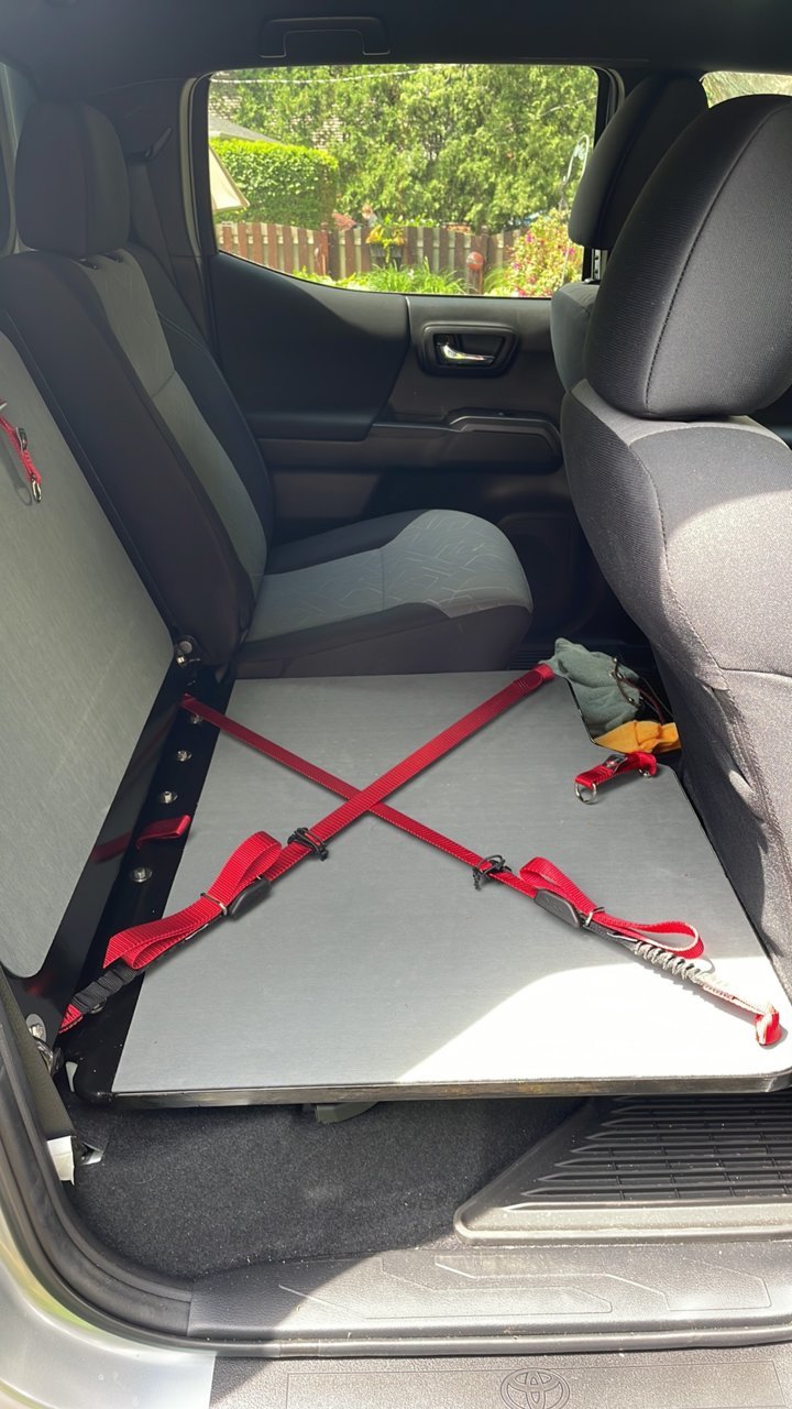

    Hey TW,
    Here’s a 60% delete I just finished that functions just like the factory seats and uses all the same mounting holes - 5 bolts revert to stock in about 10 min.
    Platform is 1/2 Baltic Birch topped w knock-off Sea Dek. Bottom is edged in steel for long term durability.
    Seat back folds flat. Rear cubby remains as I’ve always found it useful. 6 tie down points and some cam straps finish it off.
    Not a huge increase in road noise, but I’ll probably go back and add some deadening in the future.
