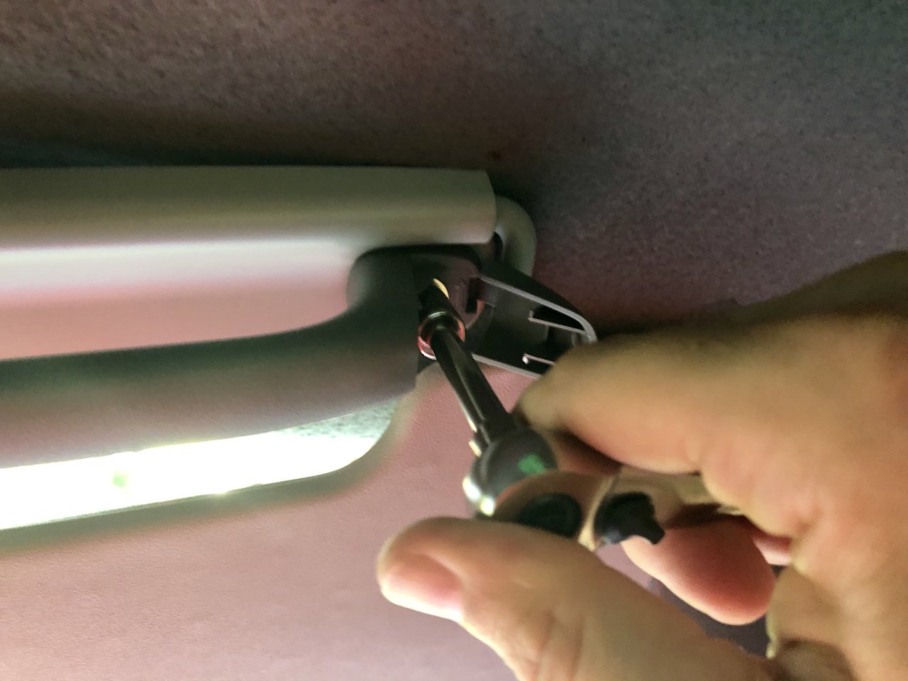

    Follow these easy steps:
    1. Grab 10mm socket (good luck finding it!). Make note of Left side unit and Right side unit (important later!):

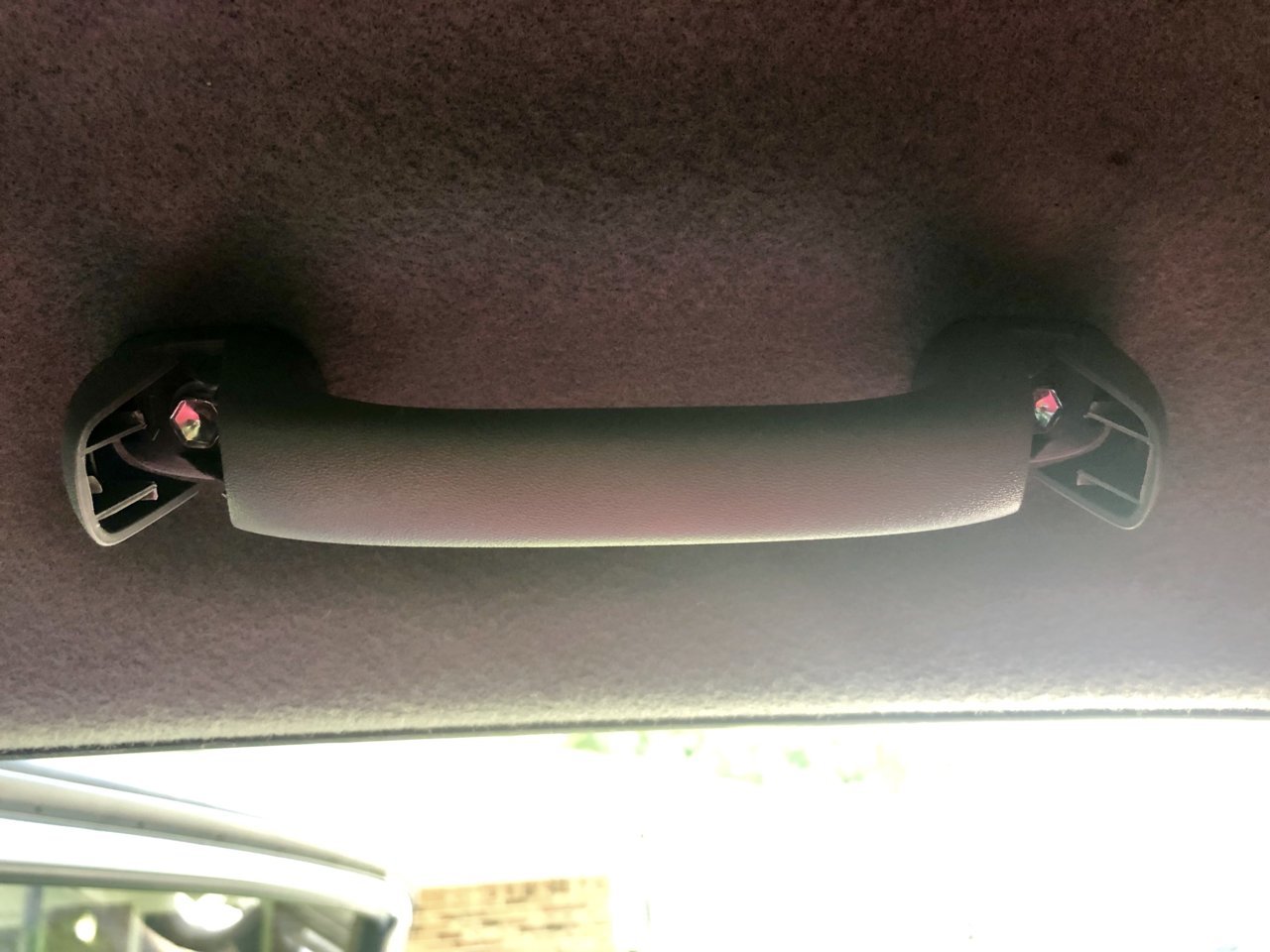

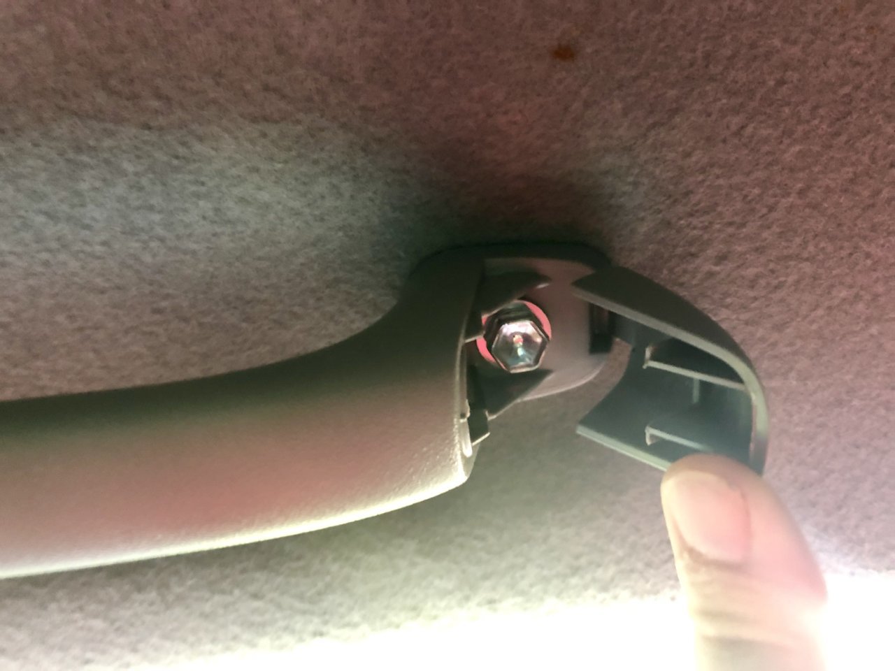

    2. Flip down the bolt cover on the rear grab handles:
    3: remove handles and set to the side:

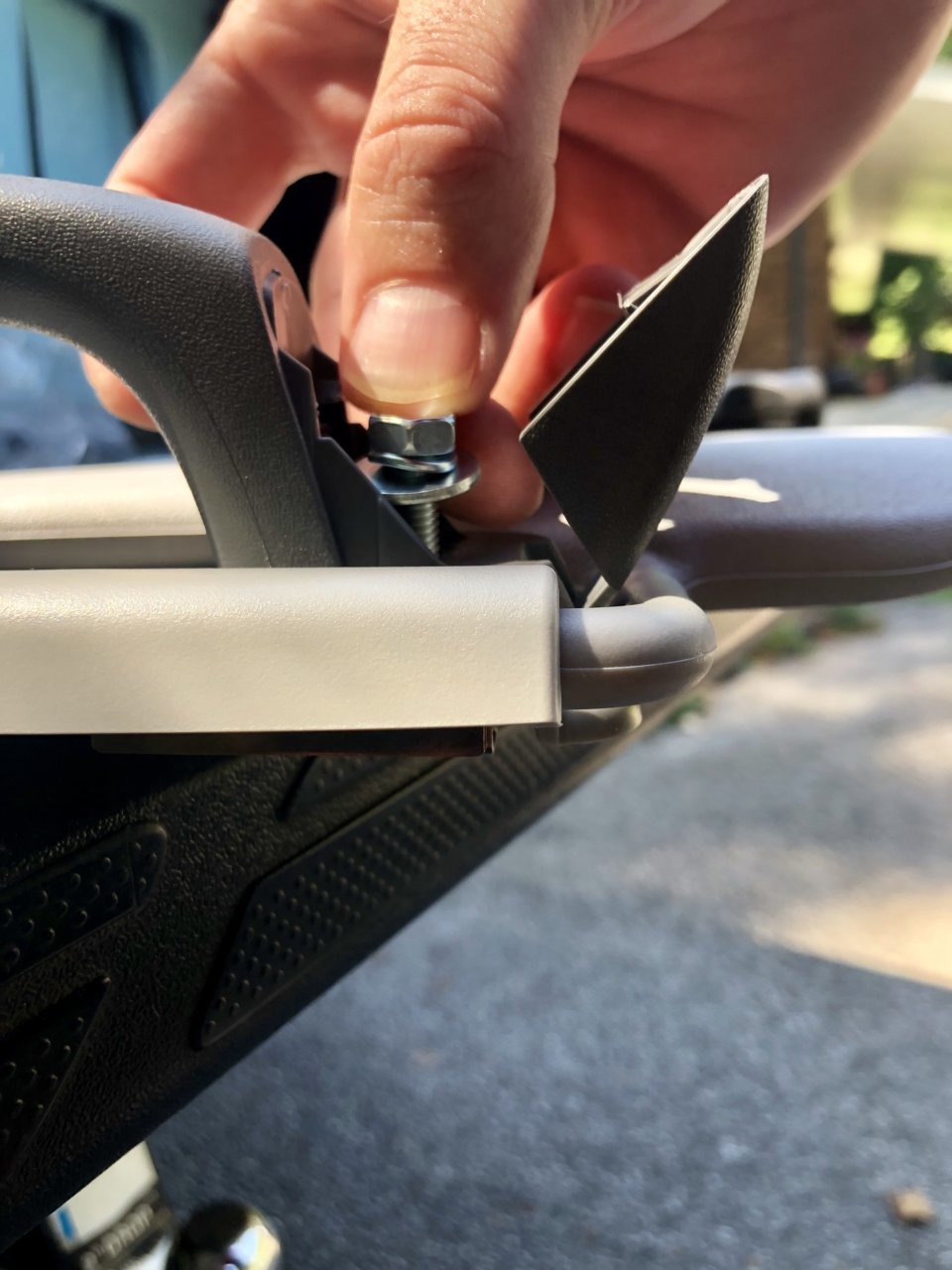

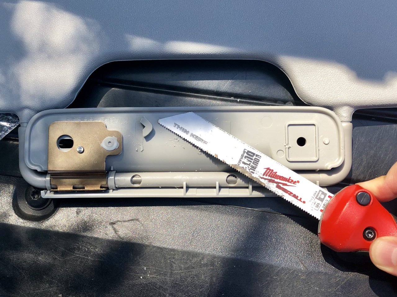

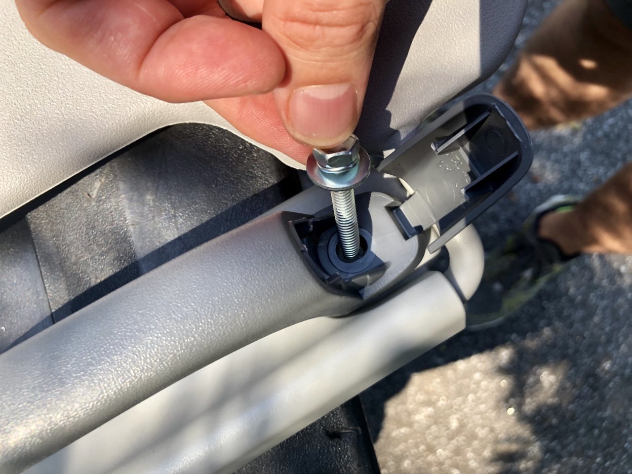

    4: unwrap visors, flip over, cut alignment tabs off like so:

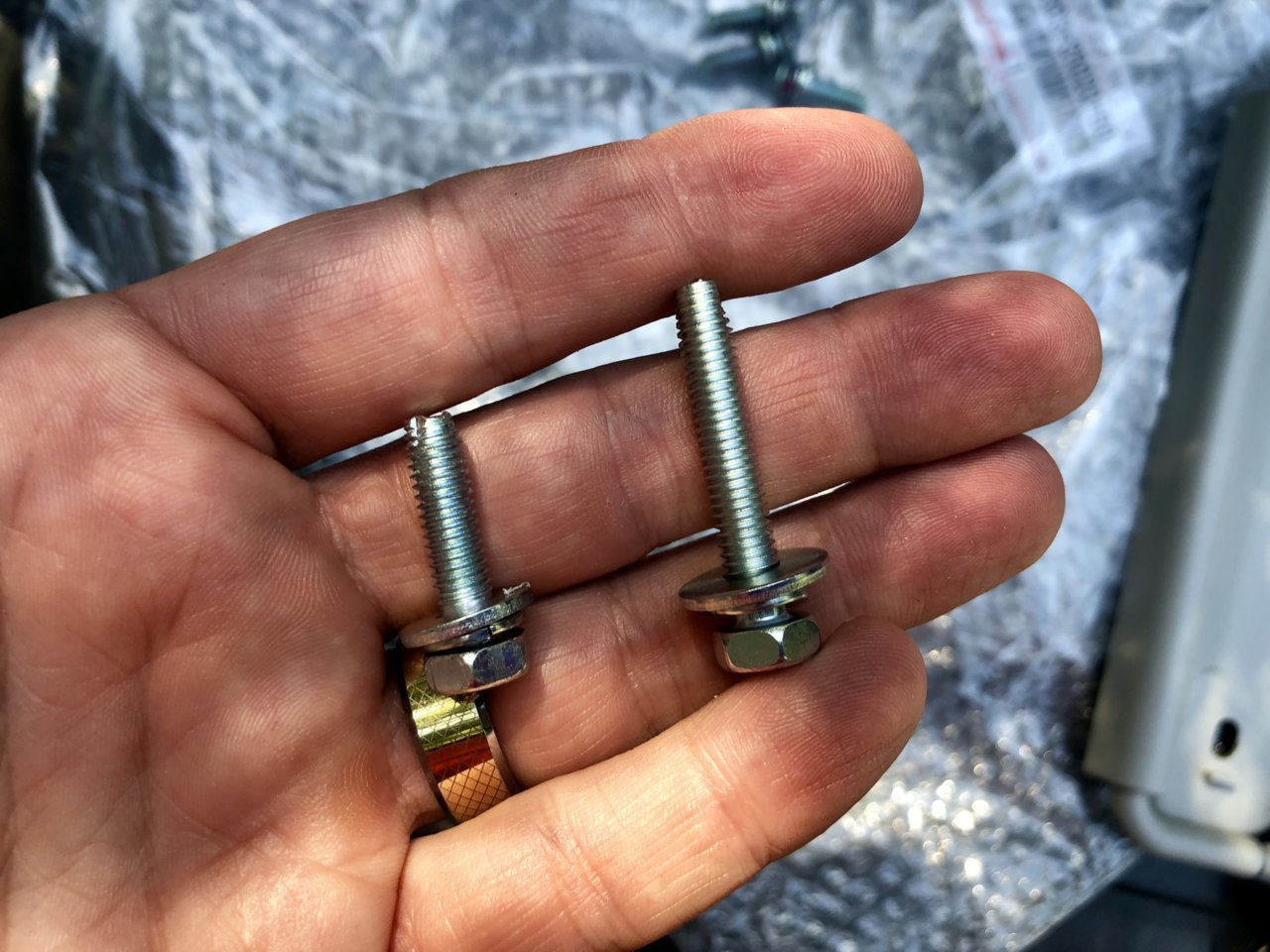

    5: swap out old bolts for new, longer bolts:
    6: Set handle on top of visor and drop new bolts through both pieces:

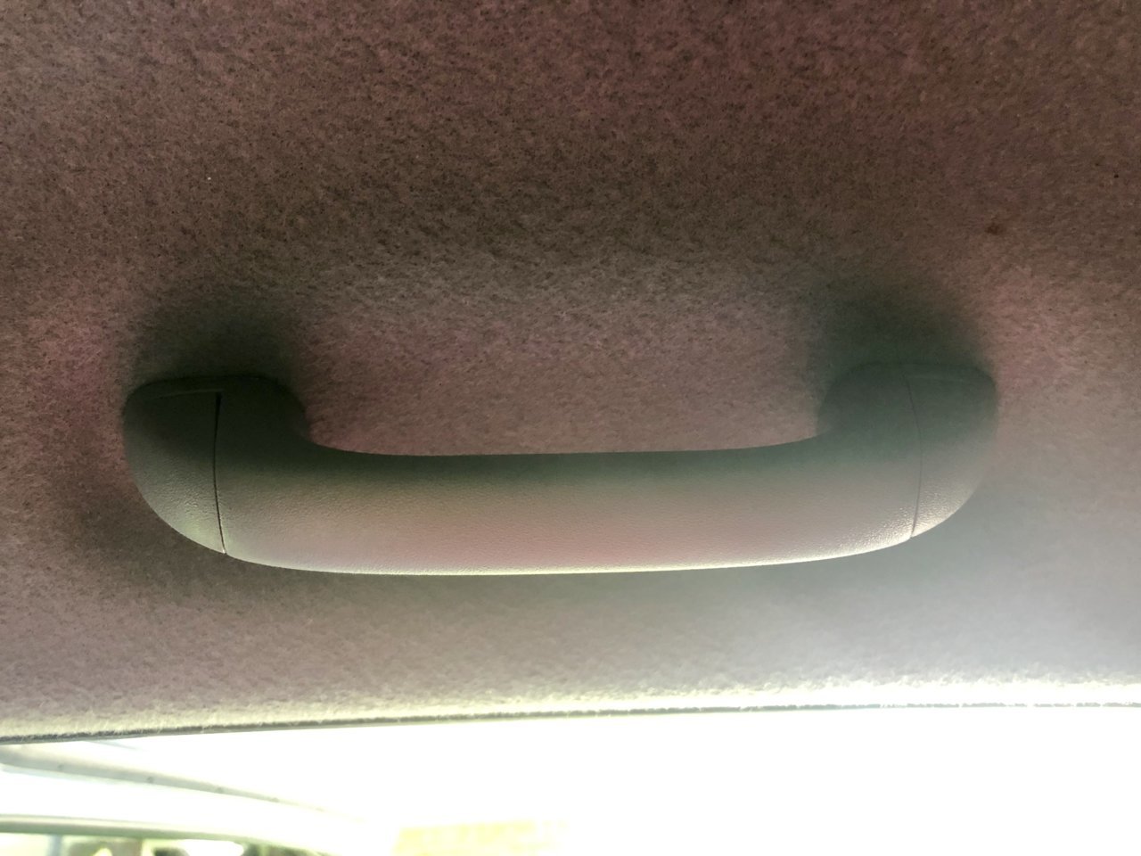

    7: be sure to put Left side unit on right side, and right visor on left side (reversed to follow roof contour, with flattest edge facing forward).
    8: Repeat for other side and crack open a cold one. (Left seat pictured for reference)
