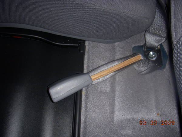

    So my 6 year old has been complaining since I got the taco that the seatbelt (in the back seat) is hard to put on. She sits in a booster seat and every time she tries to put the seatbelt into the "receiver" it pushes into the seat and disappears. I finally fixed it by cutting a piece of scrap wood I had and installing it as shown. Hope this helps those of you who struggle with this. The wood is about 1-1/4 x 4-3/16 by 3/8 thick and costs $0.
    After a few days now, she is happy that she can finally put her seat belt on herself with little effort.:D

    The pictures are with the seat folded up. Once the seats are flipped down to normal position, all you see is the receiver.
