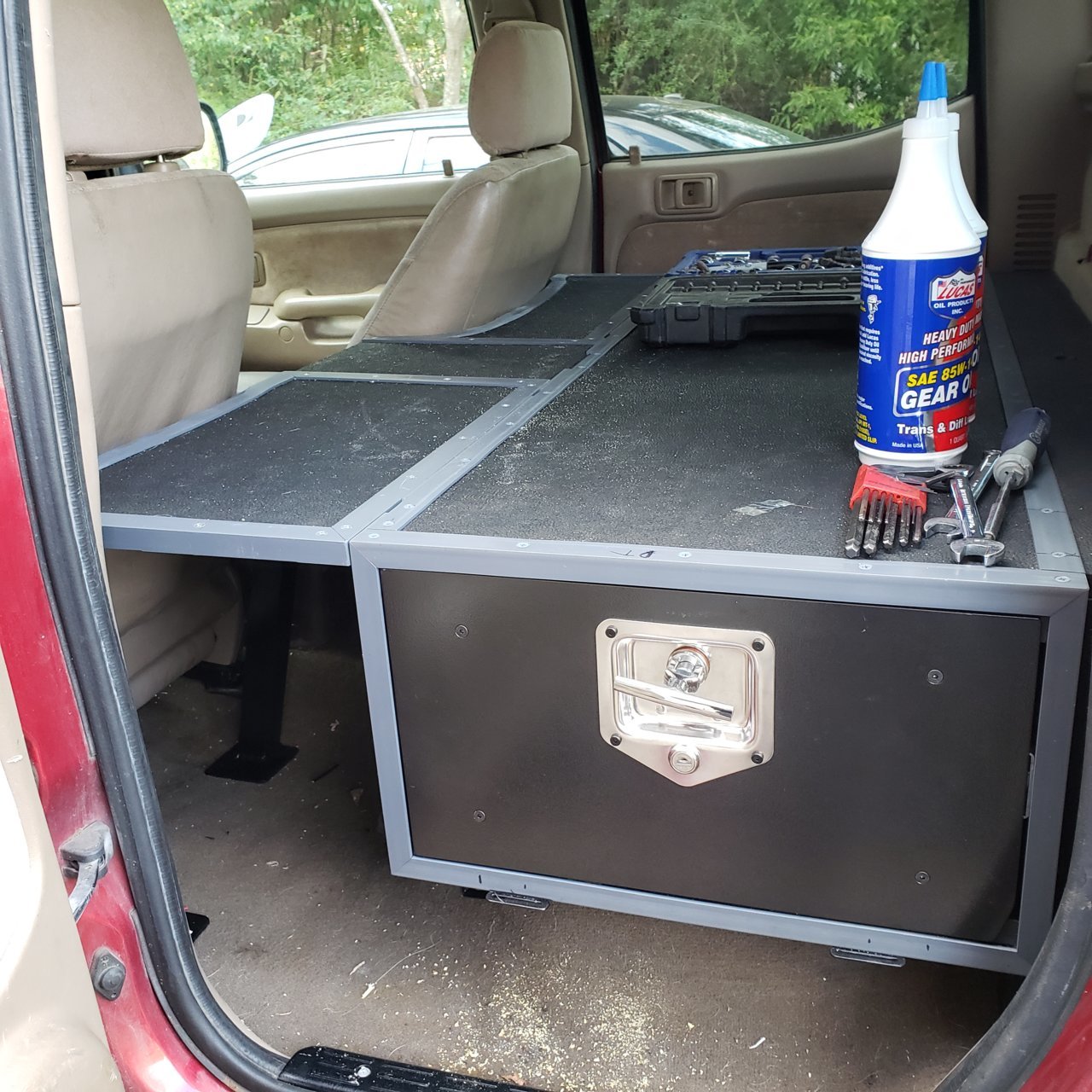

    I made this awhile back. It's nice having dry secure storage for tools etc.

    What did you use for the materials

    Box and drawers are plywood with rubber sheet. The face of drawers and brackets/mounts are steel and the legs for the extension are aluminum. Trim is pvc.

    got it like the idea might just might make the drawers little smaller

    They're definitely taller than I want, but I wanted to be able to put all the tools and parts I'd need on the trail. For extended camping trips they're great for putting a case of water and whatever else you want easily accessible. At some point I'll be making another set about half the height.
