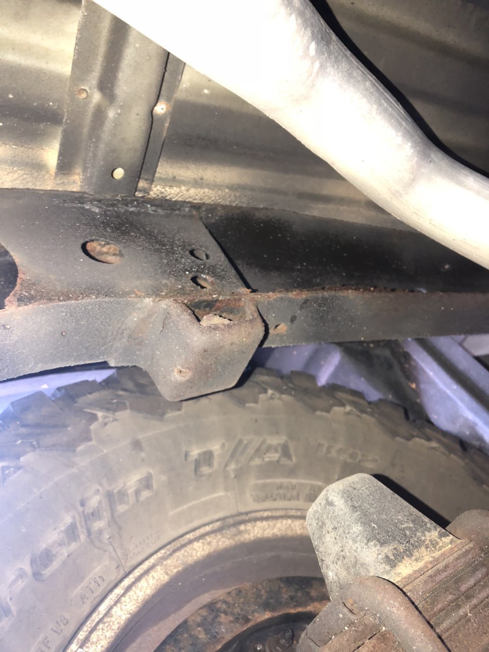

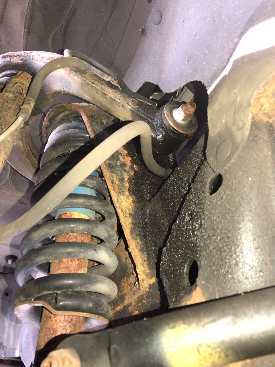

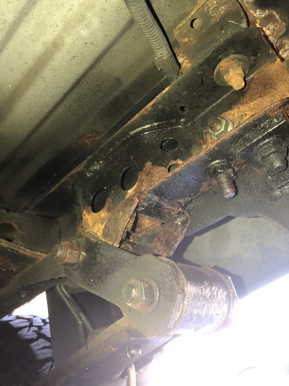

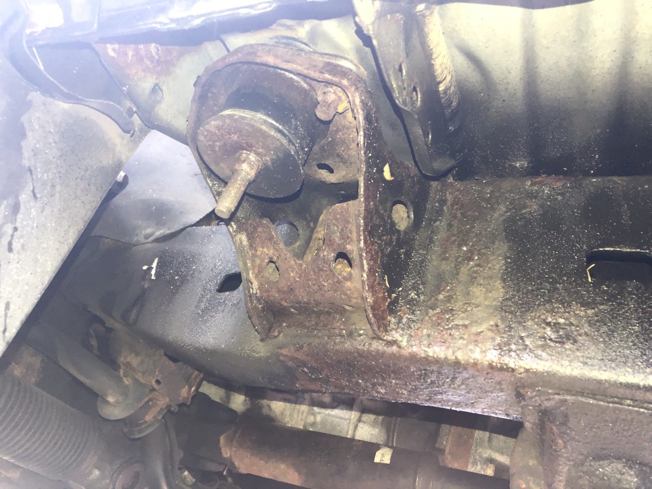

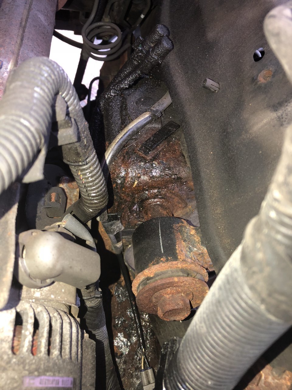

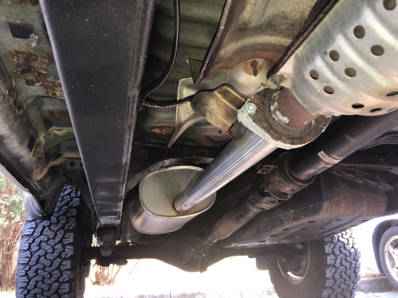

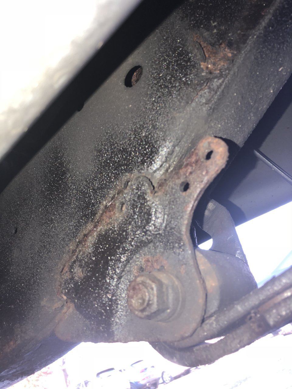

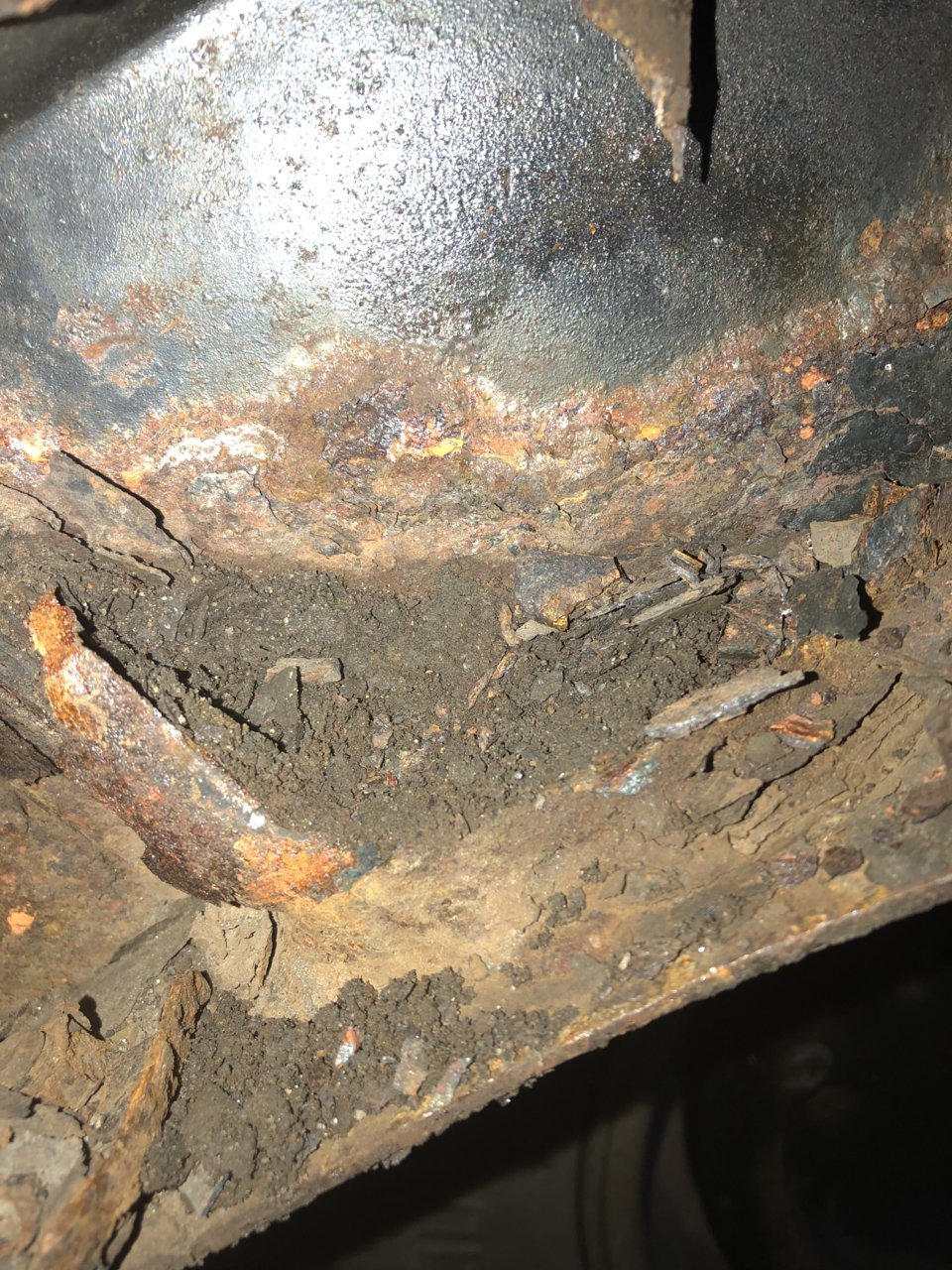

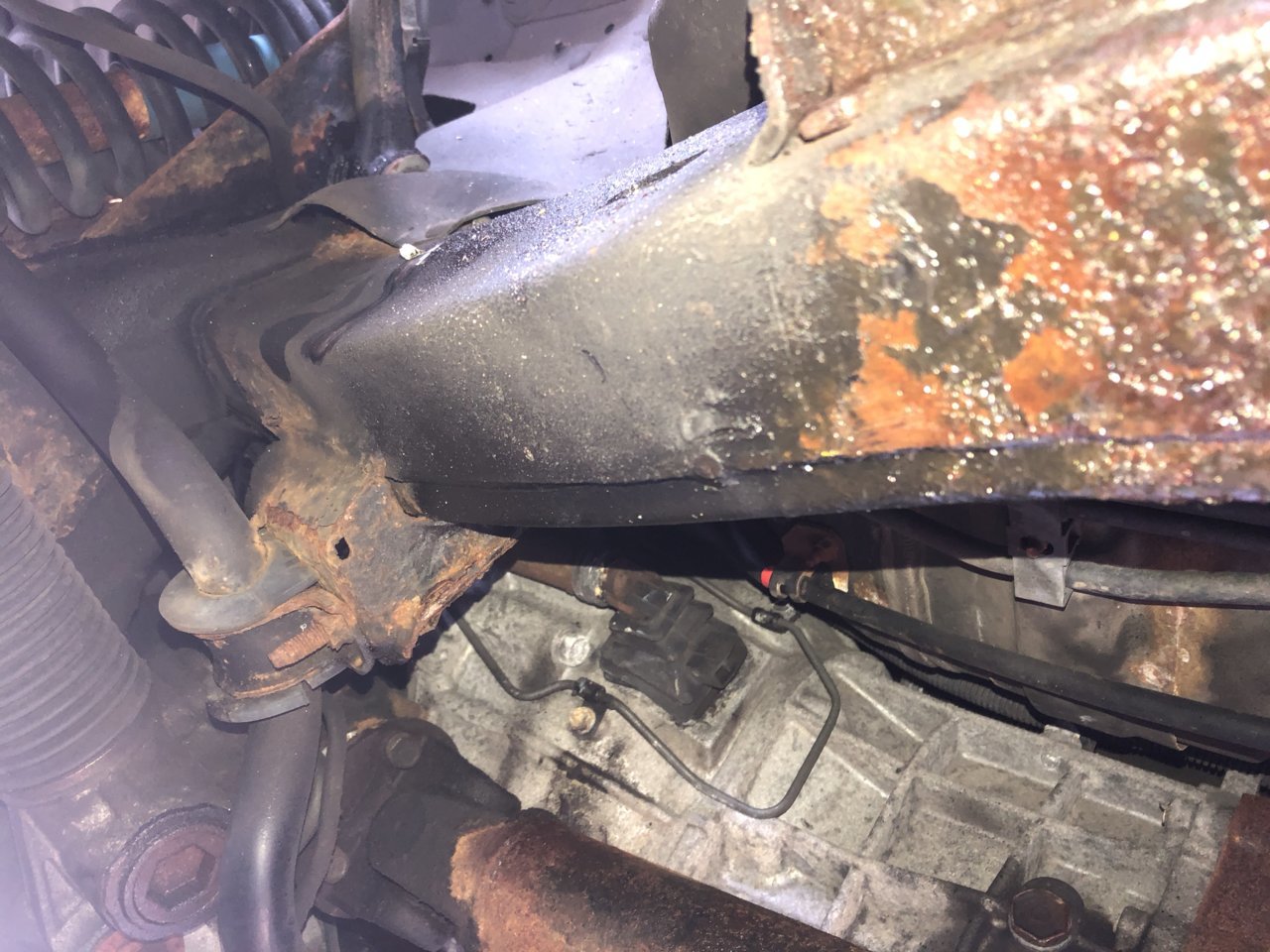

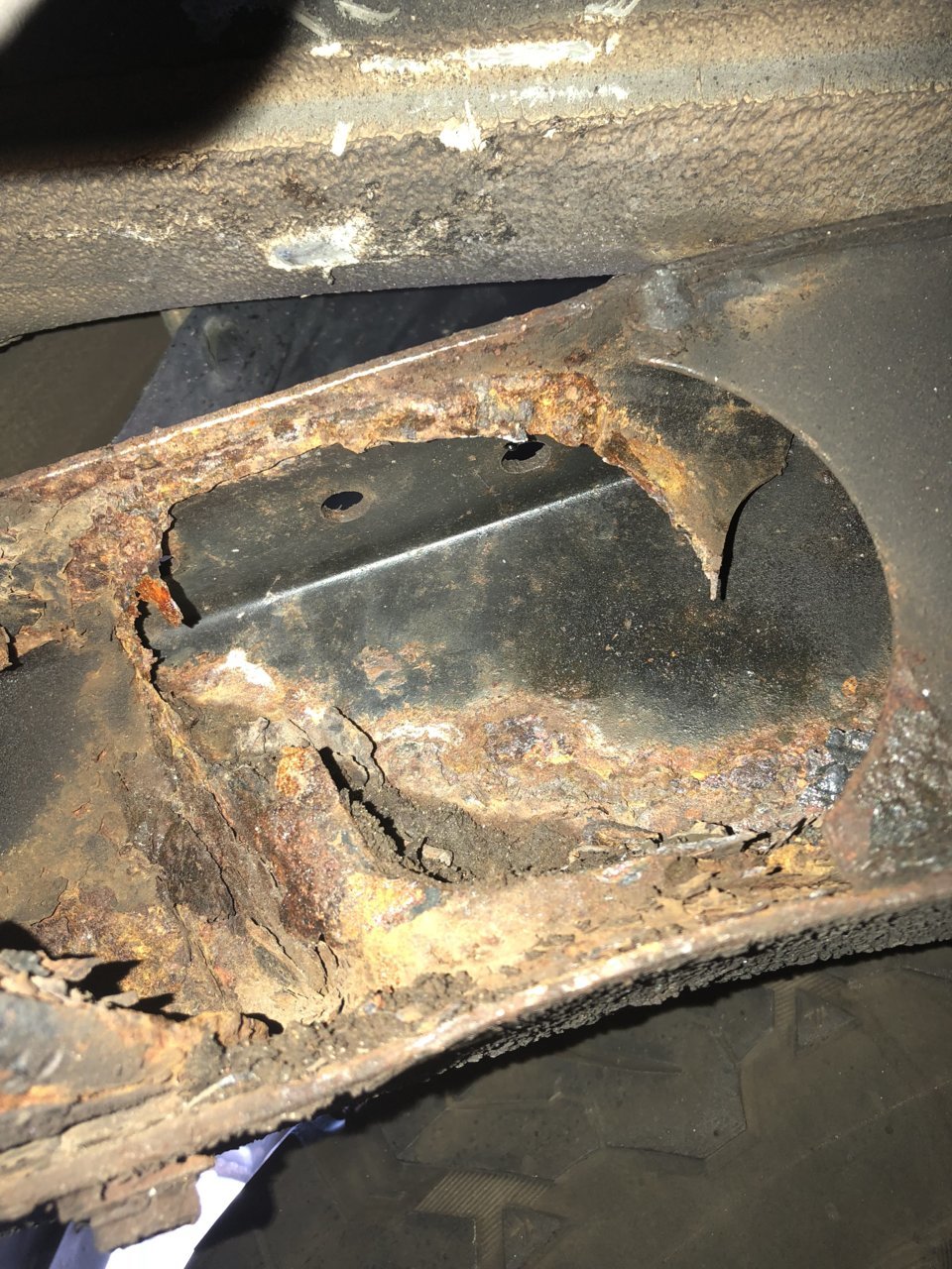

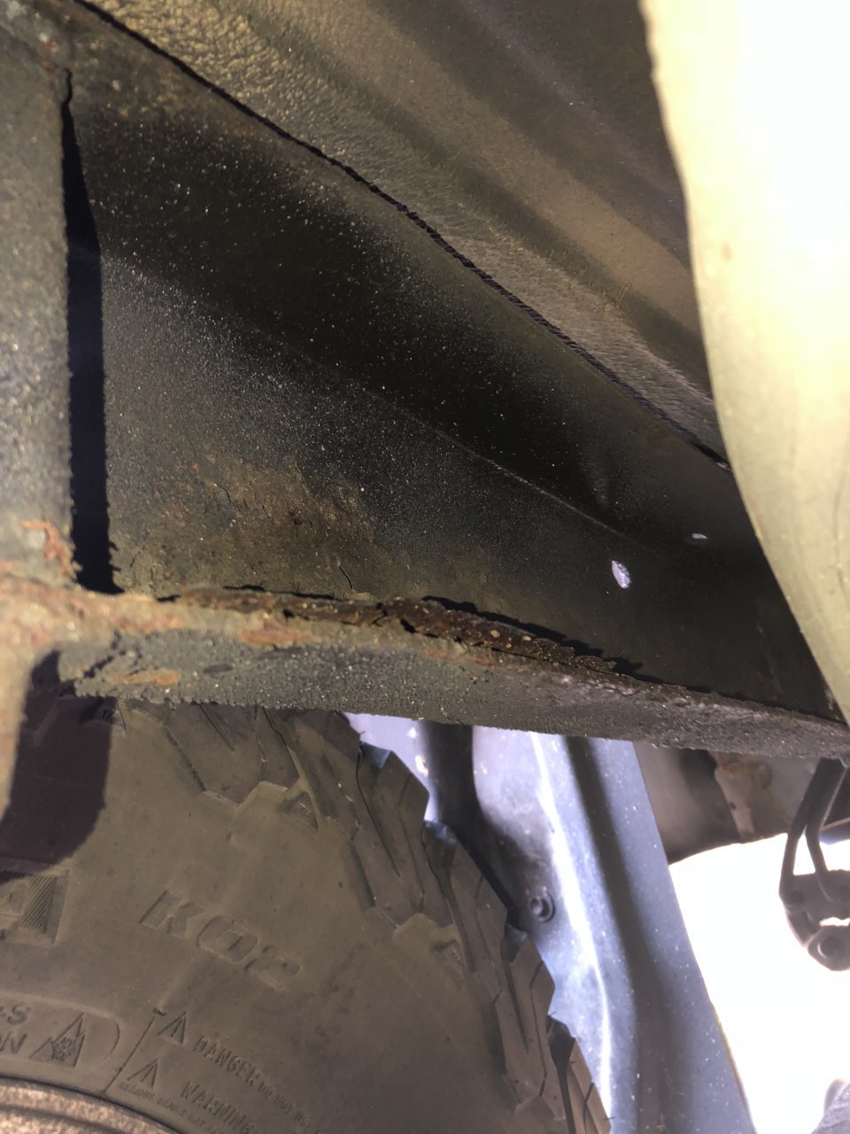

    Ok without further ado, here are pics I took this morning. I apologize ahead of time, they are pretty terrible... I couldn’t find any areas where the frame was brittle enough to poke a hole through with a hammer so maybe it’s better than I think? First up, this is where the shock mount broke free after I brushed out all the big rust chunks:
  8. Nov 17, 2018 at 10:42 AM
    #28
    BLACK04TRD
    BLACK04TRD [OP] Well-Known Member
    Nov 13, 2018
    #272558
    144
    Bethesda, MD
    2004 Tacoma TRD, 3.4L, 5spd -- SOLD
    Stock AF

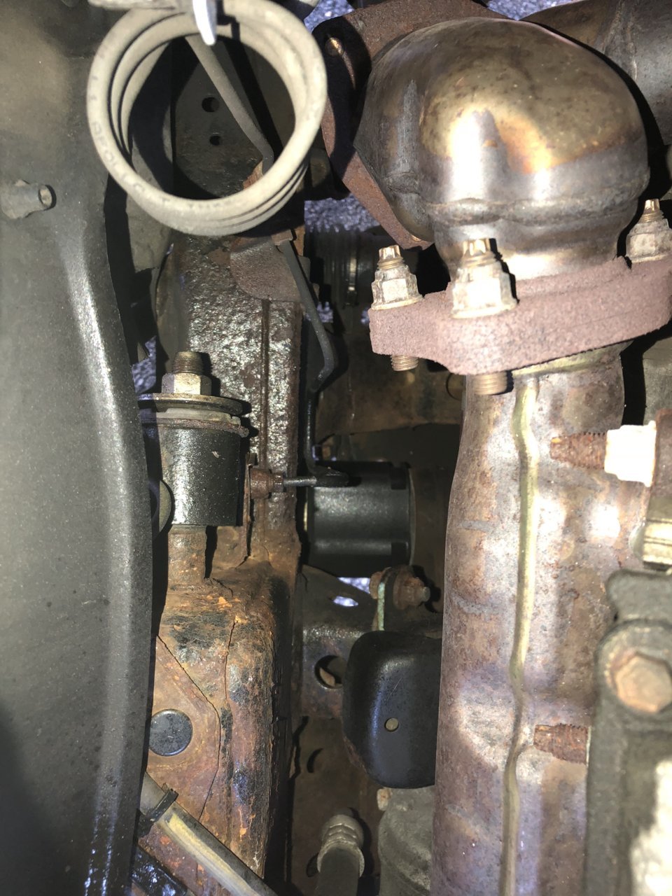

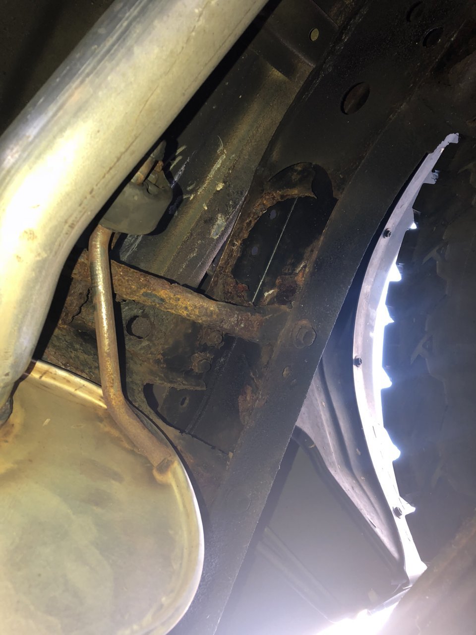

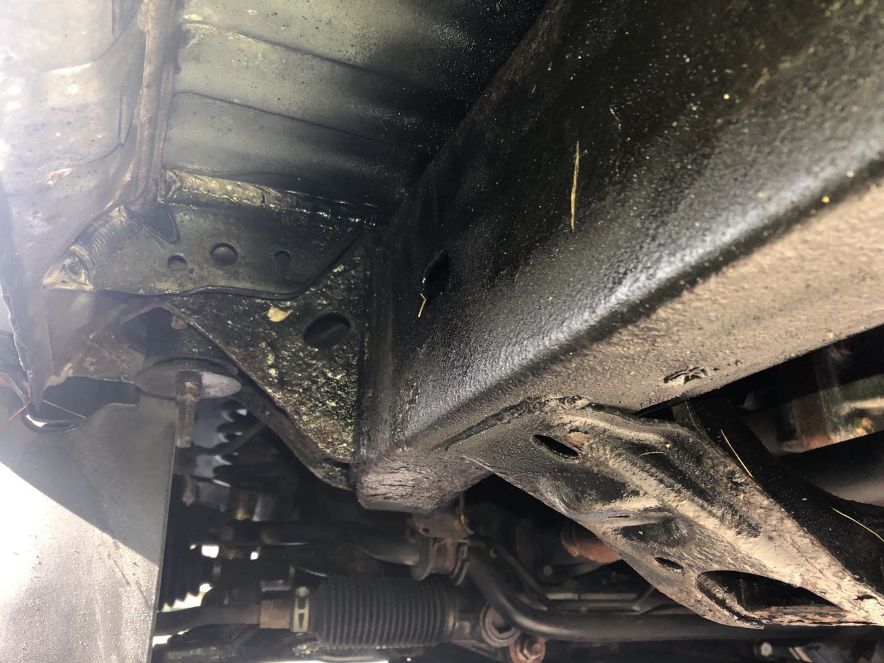

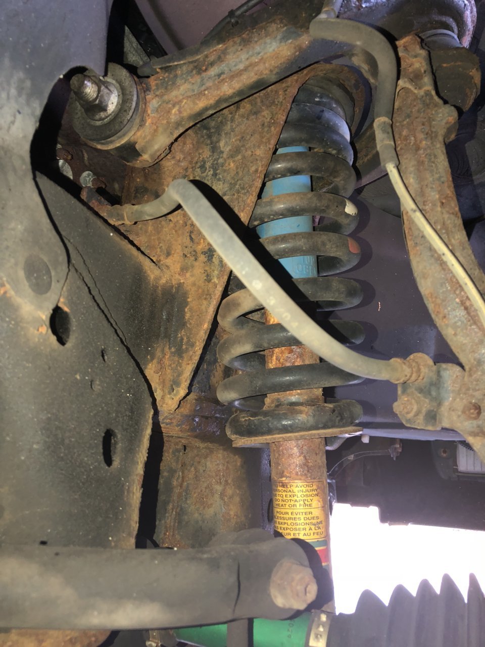

    The rest of the frame honestly doesn’t seem bad. The shiny-ness is because I just fluid filmed it a few weeks ago. Here are some random pics of other areas in no particular order, let me know your thoughts. Thanks for all of your input!

    Is that a big ass rust hole? Are my eyes messing with me?

    I’ve been googling furiously trying to find a picture of what it should look like but I’m just finding pics of rusty broken ones. I think that section of frame is C channel not fully boxed so I’m not sure if it’s a hole or not

    Yeah I'm having a hard time visualizing that part of frame. I'm being lazy because I could go outside and look lol

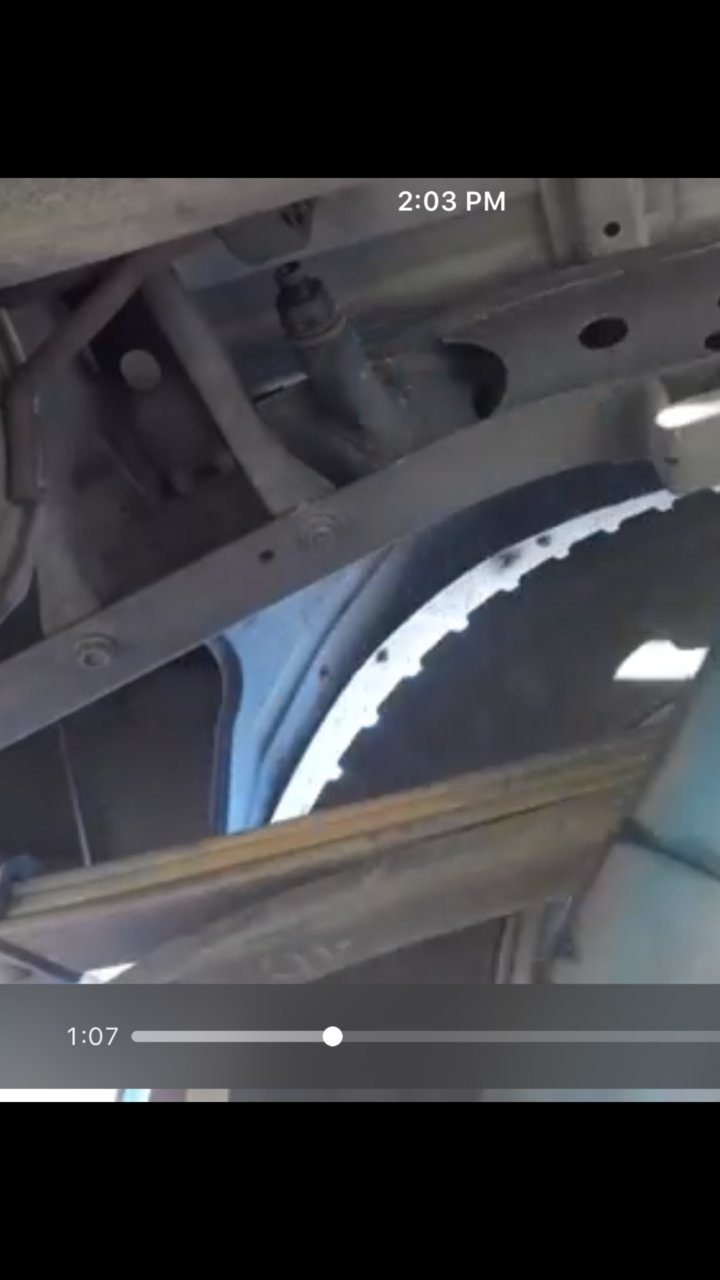

    Ok I just screenshotted a guys YouTube video, it should look like this:

    You see, the thing with boxed frames is that they rust and rot from the inside out... so what you CAN'T see is usually worst than what you can see. So if your shock mount broke off due to rust, well I'm pretty sure the rest is just waiting to rust through... The only thing you can do is bang your frame thoroughly with a hammer and see if it will punch a hole through it.. This will allow you to see to what extent it is rusted and what areas needs repairs
    The worst area is where the leaf springs attach to the frame, right behind the cab (already looks like it's about to rust through in the picture... I even spy a rust crack at the left of it).
    Then another commonly rusted through area is along the inner frame rails, by the gas tank and the catalytic converter
    Then if you want to repair it, this company makes repair patches for rusted out frames
    https://www.autorust.com/product-category/toyota/
    but if you or a friend knows how to weld, it is going to be much less expensive than having a shop fix your frame

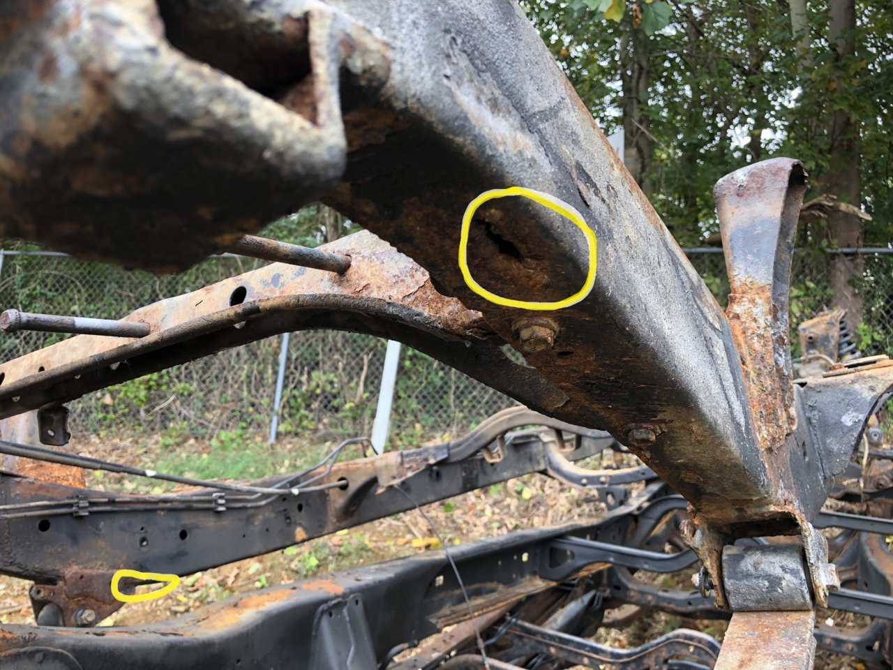

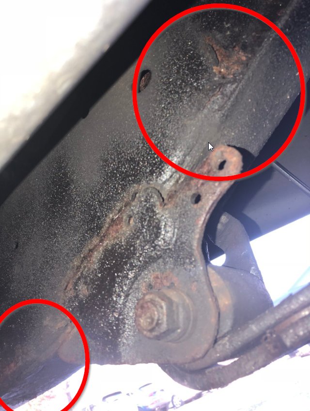

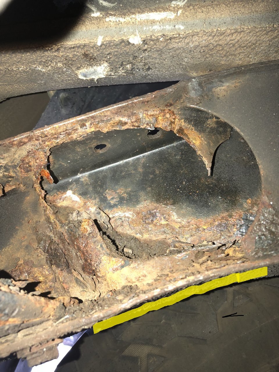

    ^^ This. First I would bang with a hammer areas circled below, and of you have ability to endoscope the inside of the frame there.
    Looks like the truck have taken some rust already, the question is how much.

    Just for shits and giggles check these spots (hammer) I have circled. If the rust if flaking outside maybe it is all rusted inside too. You will feel it right away. If it is soft, ten you have your perforation needed for a new frame.

    Use the claw end of a hammer or better a pick hammer, and hit the highlighted area in the pic don't be afraid to give it a few good hits.If you gonna find a hole that's were it will be .My frame looked just like yours, and that's were the one hole was. That area is a design flaw water gets in behind the shock mount and has no way to drain.
