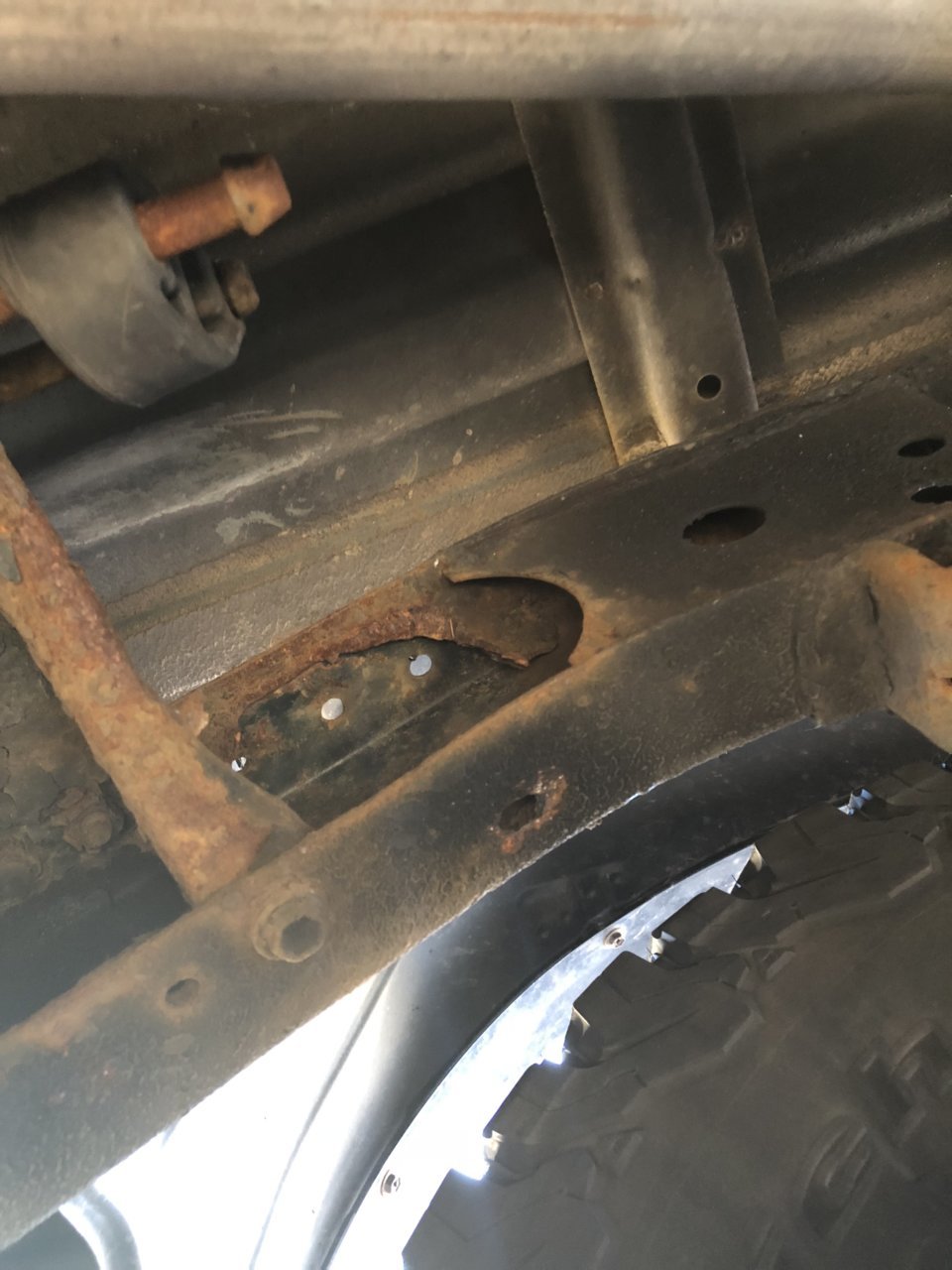

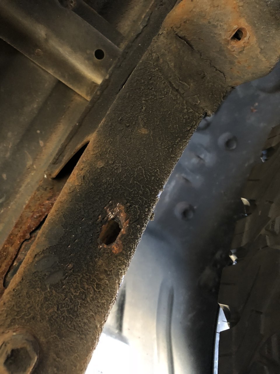

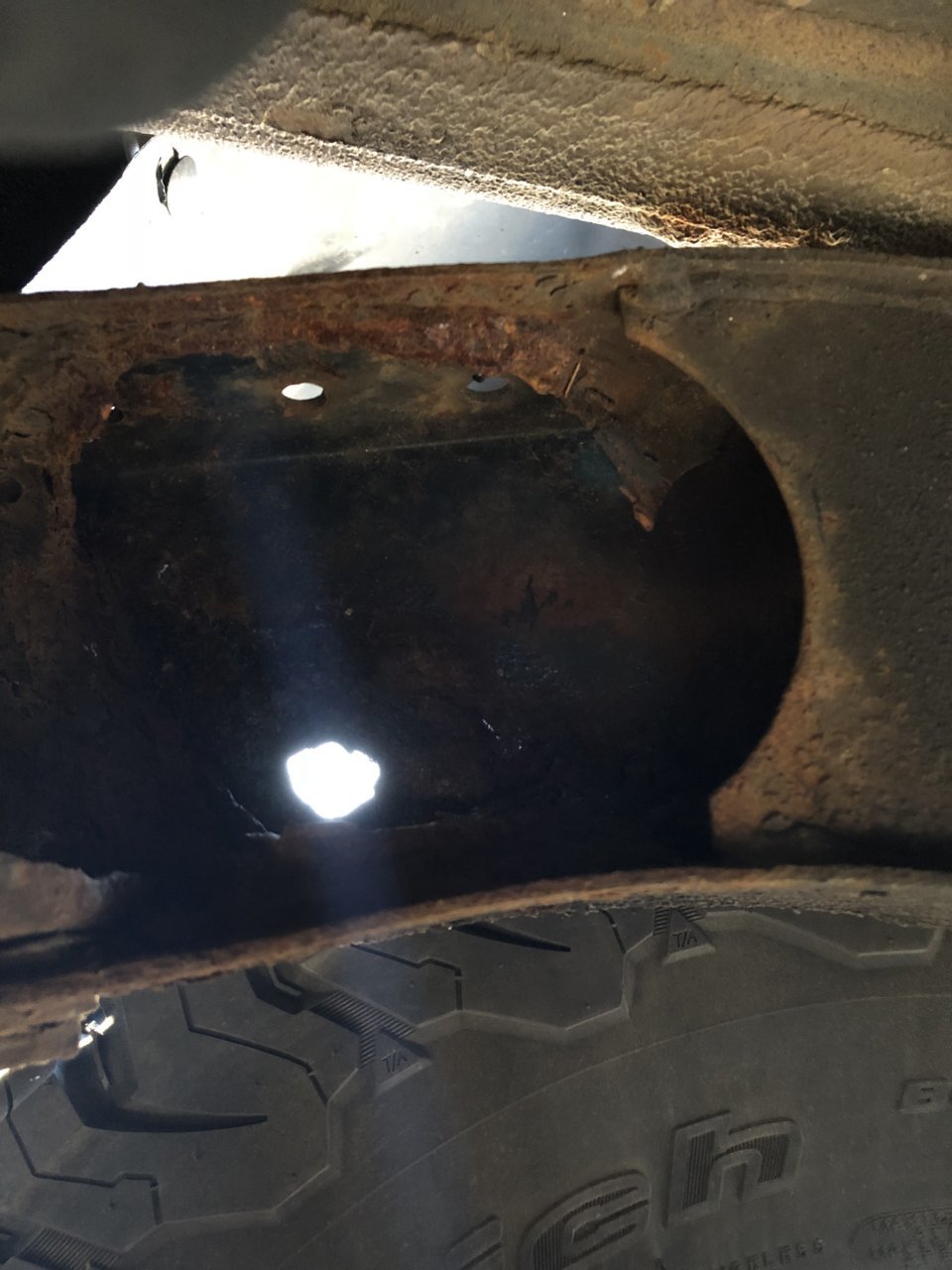

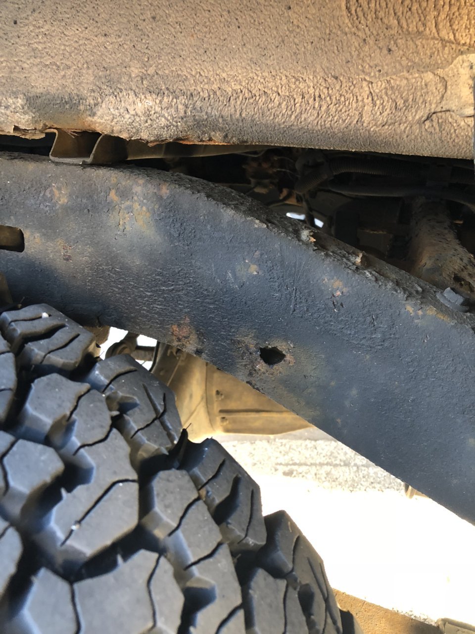

    Longggggg overdue update!
    I have been driving the truck for the past several months with no passenger rear shock while I've been searching for a shop who will weld in a new safe-t-cap section of frame for me. Nobody wants to do the work... but honestly I can't say I blame them. The reason I was doing this is I believed the 2 different dealerships in the area that inspected my frame and, even though my truck is covered under the extended warranty until May 7th, 2019, told me it didn't qualify because the rust didn't penetrate the frame rails even though the shock mount broke off.
    I decided to take the truck to a 3rd dealership this past Saturday. They returned it to me Monday (yesterday), told me it passed the frame inspection and sent me on my way. Long story short, I just went outside with a ball peen hammer to test the frame myself, and they clearly only tested the intact parts of the frame. You can see the little dents in the Toyota undercoating where they tested it and they are nowhere near where the corrosion is the worst! I lightly tapped the frame around where the shock mount broke off and EASILY put two holes in the frame rails. I'm pretty excited to go back to that dealer tomorrow and ask why they passed it when it's clearly rusting through.
    What should my plan be when i take it back tomorrow? Should i ask them to have someone from Toyota corporate come look at it asap? Here's pics of the holes i just tapped:

    The condition for the frame warranty is quite clear: a hole if given size. From the picture I see that hole. For me it is clear. The condition is not if it's safe to drive but existance of perforation.

    GENTS! I just got approved for a new frame!
    Took it back to the same dealership this morning and presented my case. They quickly put it back on the lift and then told me, "you're right, there is clearly rust perforating the frame, I'm not sure how we missed that last time." They took pics, sent them to Toyota corporate, and about an hour later corporate approved it for a frame replacement. Estimated time to get a new frame and get it installed is about 3 months.
    I am beyond thrilled - my baby's got a new lease on life! Thanks so much to all of you for your advice and wisdom, I don't think this replacement would be happening right now if it wasn't for you all!

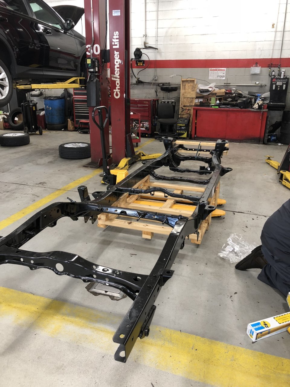

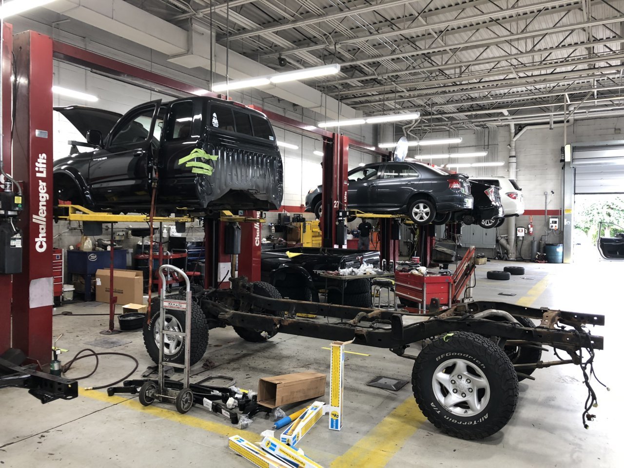

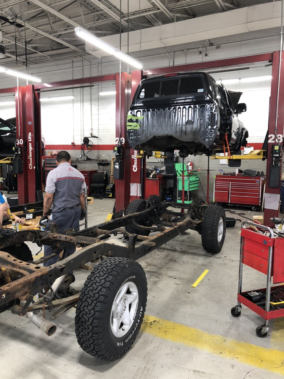

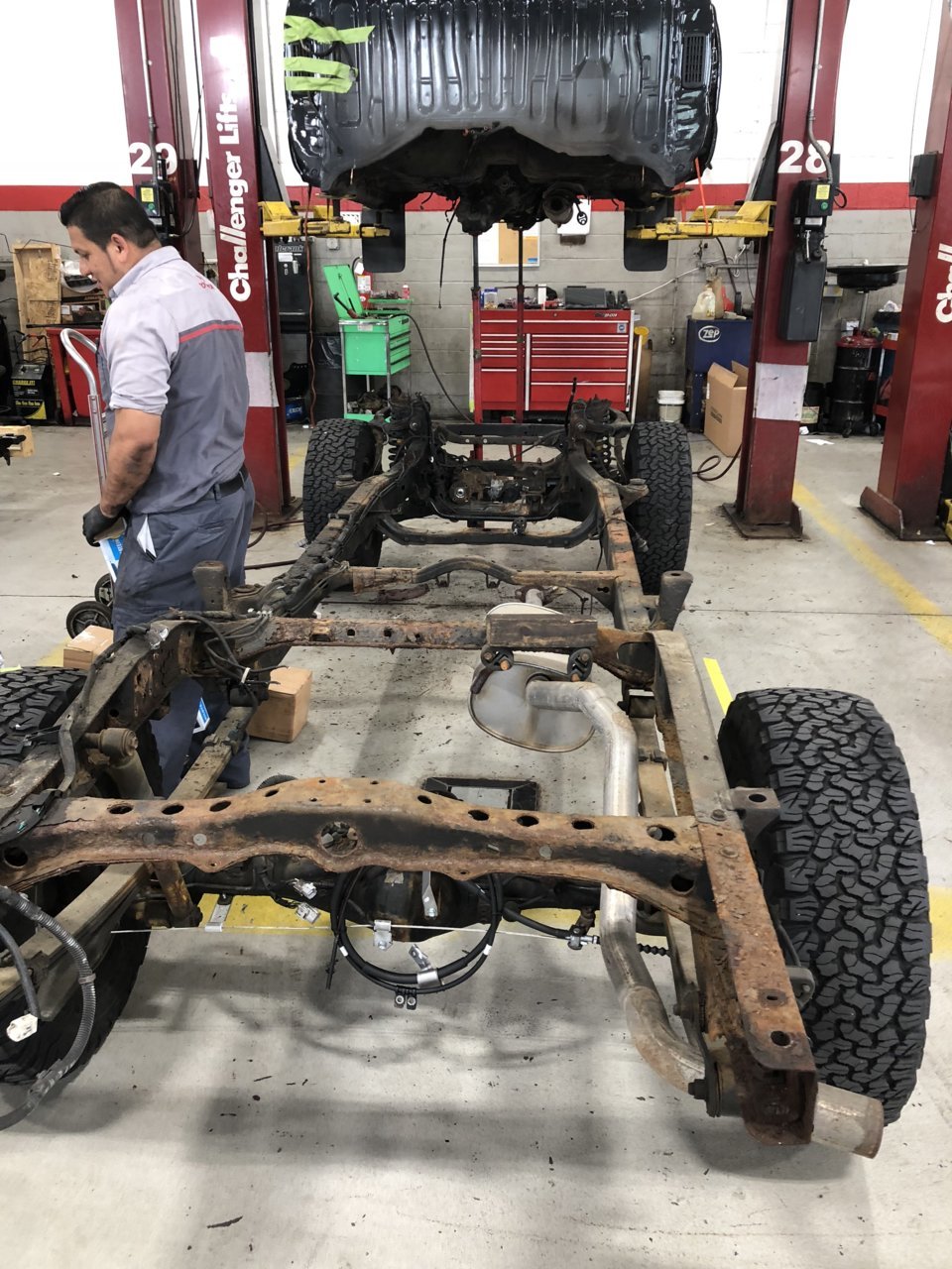

    Frame replacement update!
    Got a call today that my new frame arrived at the dealership, so I headed over there to drop off the new bilsteins i want them to put on while its apart. They let me go back in the shop to see the truck and meet the guys doing the swap. Check it out!

    is that the OEM exhaust/muffler?
  16. May 23, 2019 at 12:53 PM

    the original exhaust rusted through, so i got everything from the cat-back replaced about a year ago with whatever regular exhaust stuff the shop had. I thought about getting a stainless system but decided against it because i didnt want it to drone on the highway

    i was wondering why it looked better than frame did,thanks!

    Picked the truck up yesterday! It's running great although there are a couple of issues. First, the left turn signal isn't working correctly, and second, the check-engine light came on halfway through my drive home from the dealership. I stopped at a local autozone, used their scantool, and its throwing the P0031 code (upstream oxygen sensor). I called the dealer and am taking it back in for them to look into these two issues.
    Despite this, I'm overall very happy with how Toyota has treated me through this process. The final bill came to around $20,000... $15k for parts and labor, $5k in rental truck charges. Amount paid by me? Nothing, aside from the new Bilsteins I purchased and had the dealer install.
