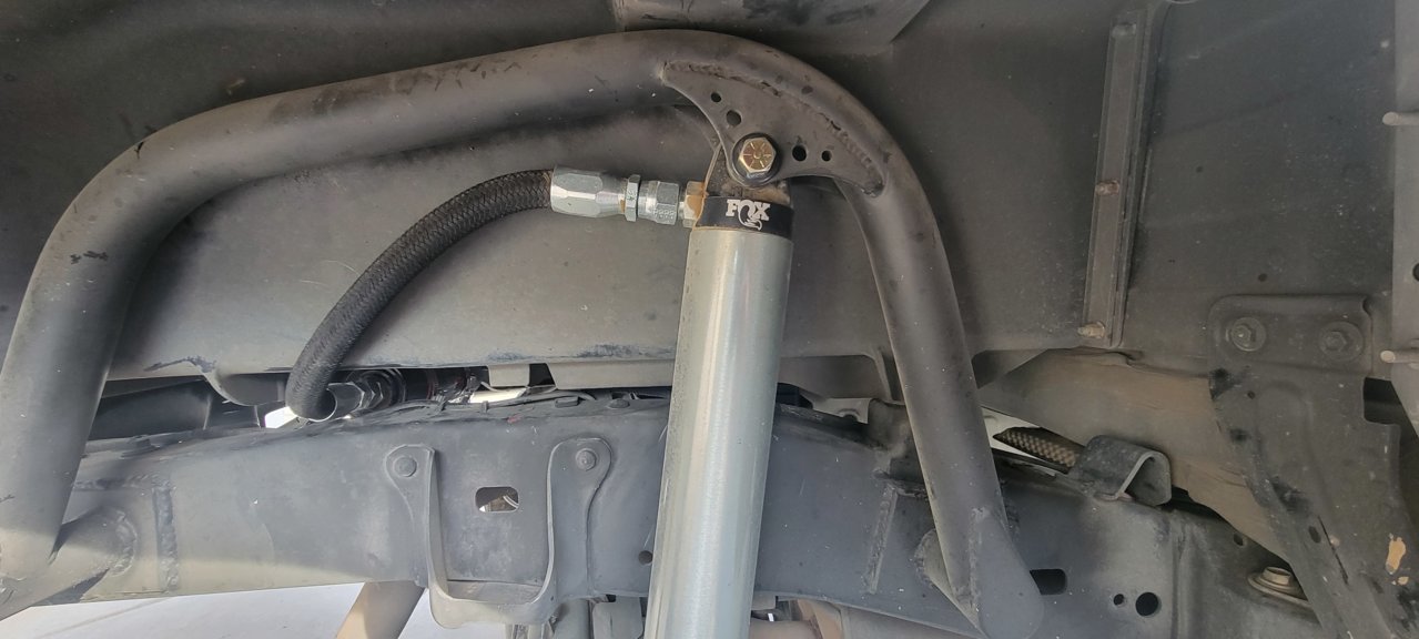

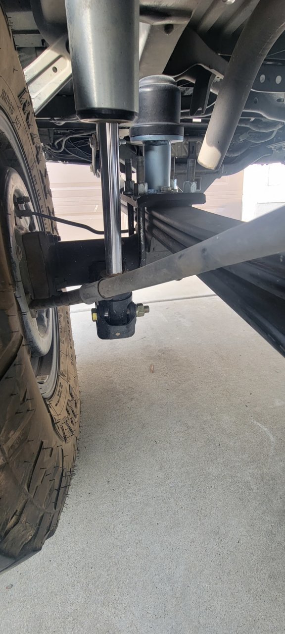

    Heres some pics, i welded guards on the lower shock tabs to hopefully protect my rod ends. Im not a pro at fab work, i just do as i go. lol.20230430_080756.jpg 20230430_080824.jpg

    nice fab work man. I like the resi mount underneath the bed. As much as me and my wallet would love to build my own mounts I dont have the skills nor equipment to do so. Im probably gonna roll with the arg kit, it tucks the shock up the highest I’ve seen from any other. Thanks for your input G.

    Thanks, yeah the resi hose and resi was longer than i expected, thought it was gona be short like the dsc's were..oh well, so i tucked em under the bed, no adjusters anyway..lol.

    What's happening with the leaf springs? Two leafs and one overload?

    I did the chevy 63 leaf spring swap..i wanted the 63s that was just 3 leafs no overload. I got stuck with the 2 leafs and overload..oh well i had no time to return and get the right ones. I will just run these and pick up another set as a spare i guess..so far they are doing the job super smooth ride and good flex..
