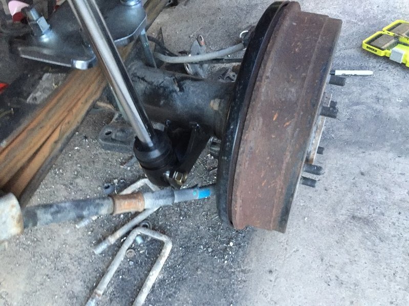

    built this over the weekend for my 2nd gen. fits a 12" shock. will take it off and get it painted this weekend :D

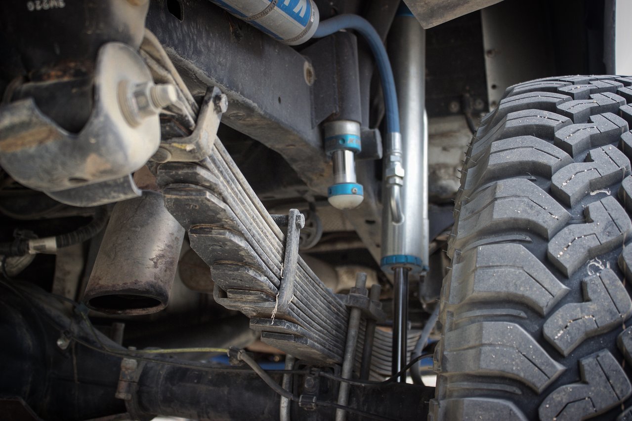

    Here's my rear setup :)
    12" 5125 Bilstein shocks and BAMF shock relocation
    SOS Concepts shackle flip bracket
    Armor Tech OffRoad stock length greasable shackles
    Dakar leaf pack with D29XL add-a-leaf

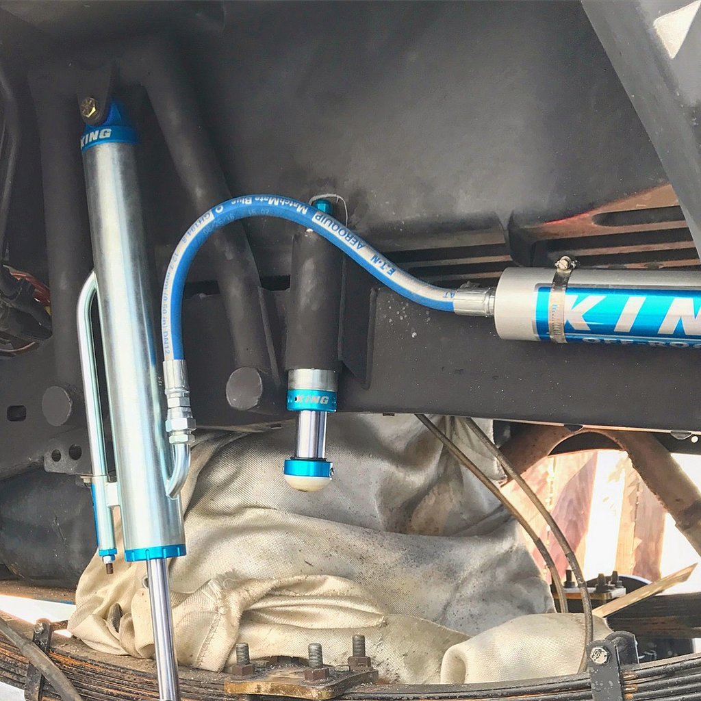

    enough to go over stuff
    12" 2.5 double bypass shocks with hydro bumps.
