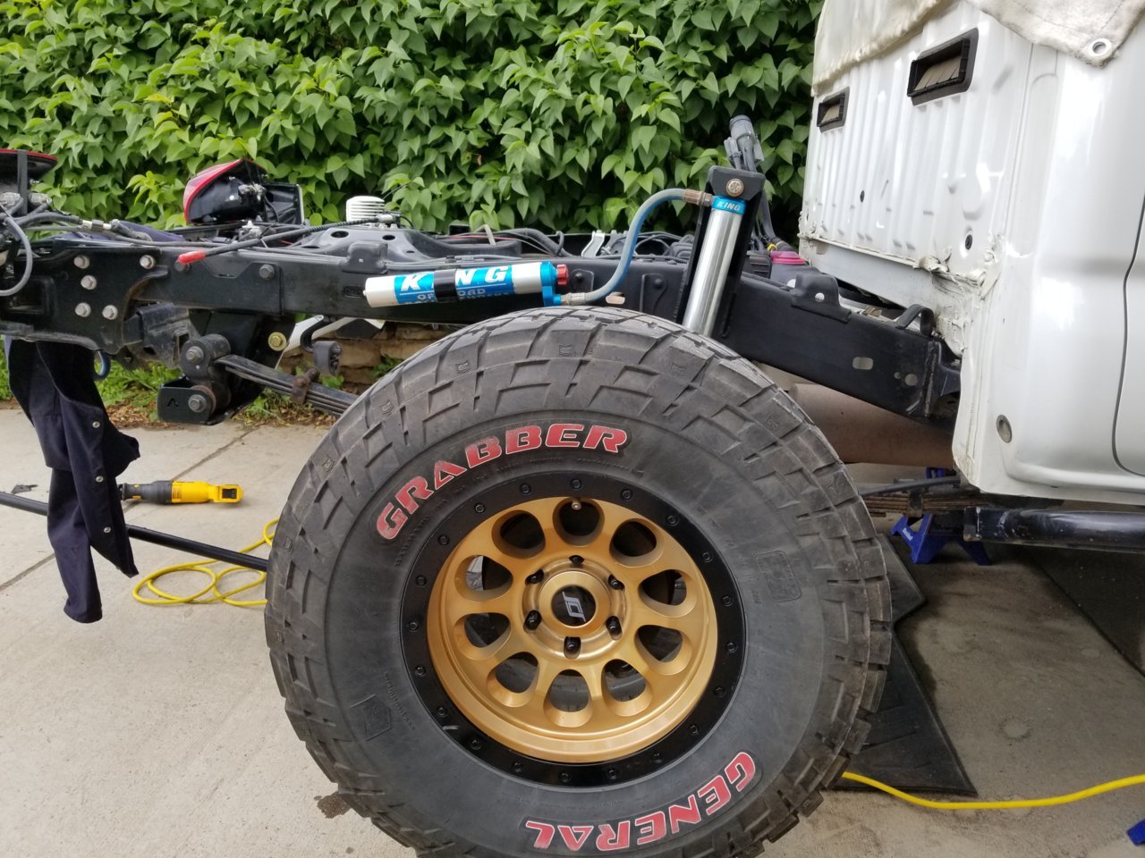

    BAMF rear shock relocation with 12 kings and adjusters

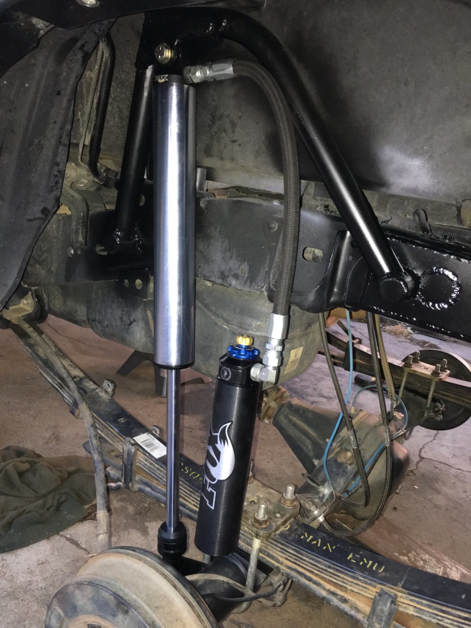

    My relocation. 1.5” DOM and Fox 2.5x12” with DSC. 172A65AB-2198-4B24-893D-8534D180B3DF.jpgEDEDAB03-5AE0-4401-B162-82263774D4AF.jpg4501ED9A-4637-425D-9981-D49D19ACB26C.jpg
  19. Oct 1, 2018 at 5:58 PM
    #319
