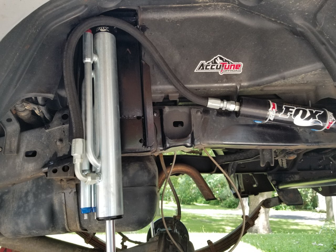

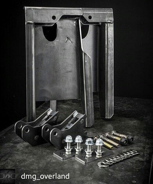

    All this angst over fitting 10" shocks, when the Archive kit fits 12"×2.5" or 14"×2.5"
    It can handle all the bump travel spring under can dish.
    Price is $350 shipped with TW discount for DCSB
    https://archivegarage.com/products/taco-shock-relocation
    This under the bed kit allows a cross brace in the bed to lockout the frame rails from rotating inboard as well, where others do not.
