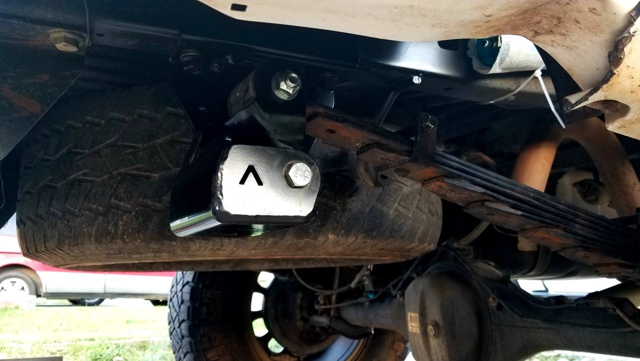

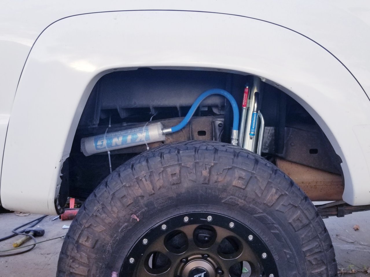

    burned in my Archive shock towers & Hammer Hangers on Monday. Installed Kang 2.5x12" triple bypass remote reservoir bling. Initial freeway cruise says it's a much smoover ride! I can best compare it to how it used to feel with a few hundred pounds in the bed. No pogo stick, no chattering, nada. It just. Feels. Planted. Look closely & you'll see the uber custom reservoir mounts we used to get me by until I can get the real McCoys tacked on tonight.
    Next up: UBolt flip kit & Spidertrax wheel spacers (hopefully before Calico this weekend)

    Looks like you're pretty handy. I like to think I am too and pretty good with an angle grinder. Given that, is the Hammer Hanger install much of a problem?
    Also, are there any guide pin points included with the Archive relocate bracket or do you have to mock it up with a shock to get it all lined up right?

    Besides price and wheel spacing, what’s the draw of a 2.5x12” vs a 2.0x12”? I can assume ride quality between the two is improved right? I’m not doing any go fast stuff, just daily driver and slow trails.

    Im not a shock designer but this should be accurate: A 2.0 with 7/8" shaft is not ideal for damping performance, a 2.0 with 5/8" shaft is actually better for damping performance, the 7/8 shaft reduces oil volume and valving area.
    A 2.5 (7/8" shaft) is heavier duty, has a higher oil volume for better cooling, and can be valved to control higher loads, and then looks is something to

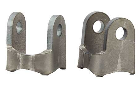

    I used these for the upper and Lower mounts.
    I think these would alleviate the binding problem
    Could I have angled the mounts just a hair off? It seems like my bushings don’t give at all...? Thanks for any thoughts
