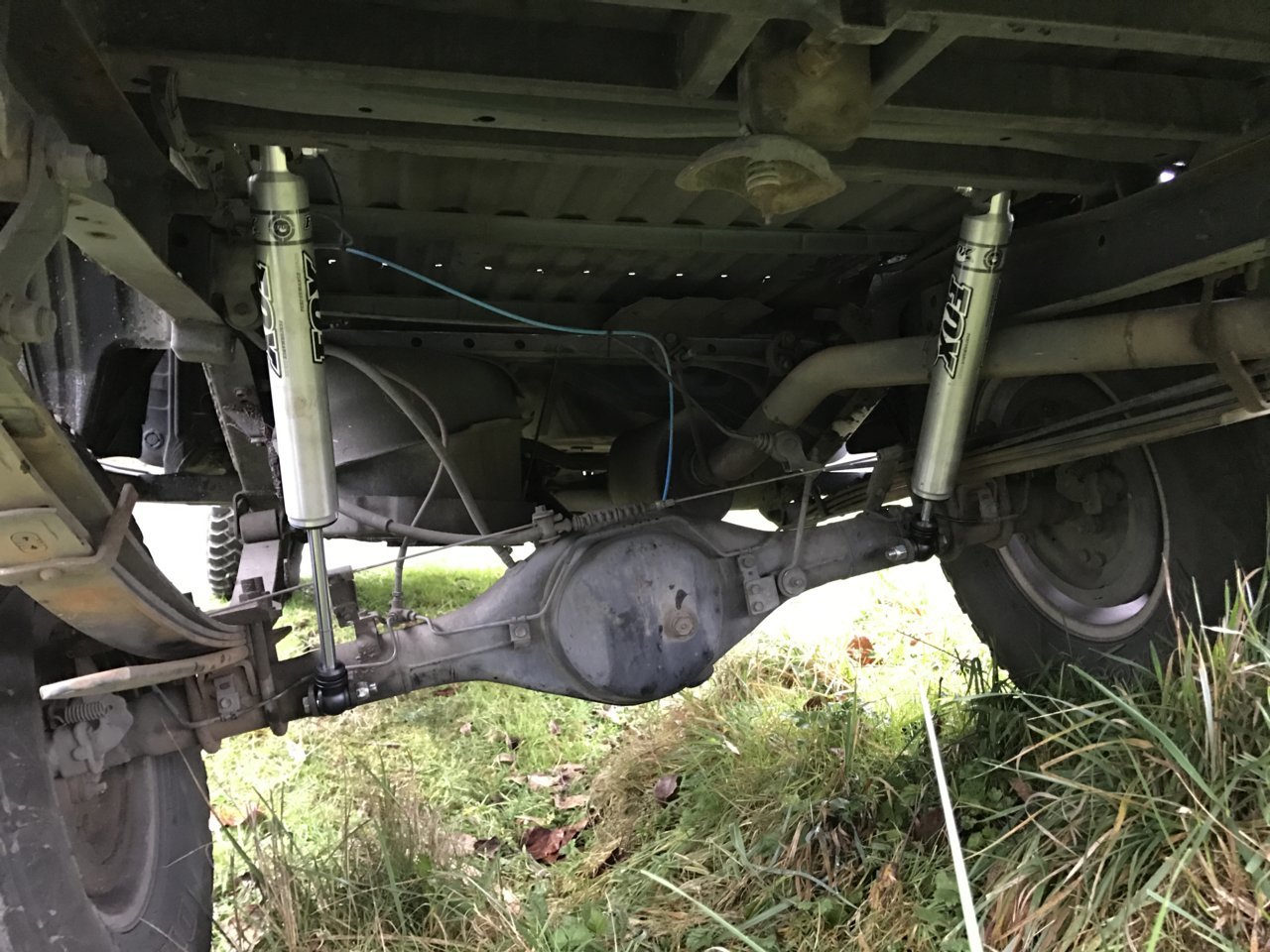

    I put in the cross member because
    1. It was easy to copy everyone else. And, @Speedytech7 was helping me, and that's what he'd done.
    2. I didn't have the spare tire in the stock location anymore anyway.
    3. It got the shocks "more" vertical than the stock location.
    4. It gave me a nice place to mount the resis.
    I think you could probably get a couple more inches by moving the stock mounts, but here are the things I'd be concerned with:
    1. I'd be curious to know if they would be enough to fit 10" shocks. No point in moving them if you can't put in the longer shocks :).
    2. I'm not sure if the mounts on the frame would hold the shock body - at least with a 2.5" body - too close to the frame and you'd get interference.
    3. The OEM frame mounts are well supported through the frame. There's a lot of force applied to them, so I'm not sure I'd be comfortable with them above the frame and "levered" out. But, I don't really know if that'd be an issue, and you could probably surround the post in its own "boxed" area to make it work.
    Might be worth trying to figure out - could be a cool alternative.
    I might need to start talking about myself in the 3rd person now. ;) (just joshin ya)
    I'd have loved to run your kit, and probably would have seriously considered it if I didn't need lower backspacing on the rear wheels. While I loved that look on my truck, it made the mud situation untenable for me.

    Whichever way you decided you have to take the bed off the frame/truck. Knowing this I bought a rear frame boxing kit and it came with the cross members. I boxed the whole frame while the bed was off because I didn't want to redo anything. Put the cross member in because it was super easy to weld in.
    SmartShox671 and Speedytech7 like this.

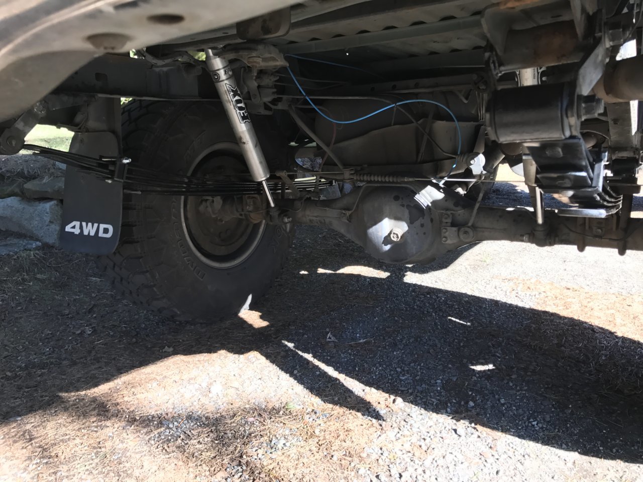

    I removed the stock crossmember that holds the spare and clearanced my spare another 2-1/2 inches (1 inch body lift required), did a new crossmember for both spare and shocks, stuffing the spare was part of my motivation, as well as doing a u-bolt flip. The shock locations were put in the easiest location I could get to make it all work, but several years later and they work well
    I was able to weld both up crossmembers up without pulling the bed, but as said, it definitely helps, easier protecting your gas tank too- I eventually did so to repaint my rusty frame and redo my exhaust- dumping the exhaust under the bed as many people do had several negatives-
    1) bed got really hot in the right rear corner
    2) my frame rusted out like crazy
    3) not good for spare to have all that heat on it
    4) fumes while crawling and in traffic were definitely noticeable
