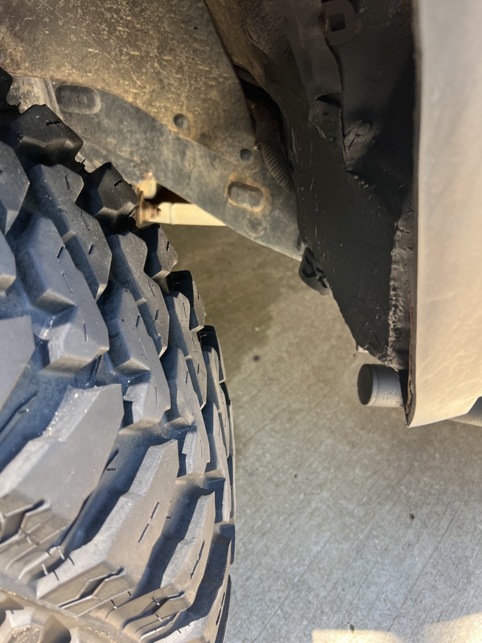

    Yeah, I went with 1.25" spacers (Spidertrax) and have had zero issues with the rear. I do rub on the front now since I decided to put them on the front as well to match-- I previously did not after a CMC was done years ago. The hammer will be beating the inside a little more to clear it all up, shouldnt be too bad.

    Nice. I also chose to put the spacers in the front as well. I have a CMR and had to do some firewall/ inner fender work. They were rubbing on the trails.
    For the inner fenders I hammered up and then in with an 8 lbs sledge. The lower firewall was pushed back about 3", over 7" and up right about 9".
