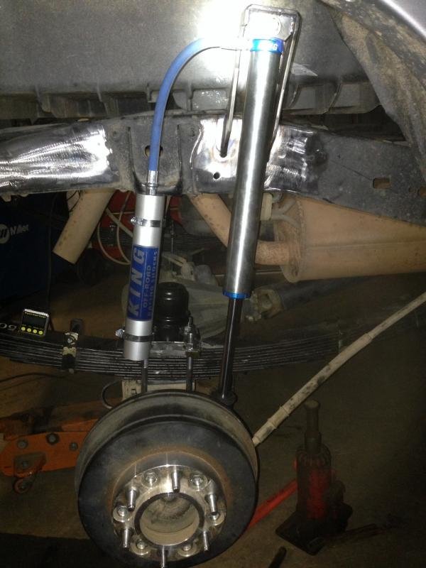

    Here is how I did my relocation with 10" 5125's. I now have 10" 7100's

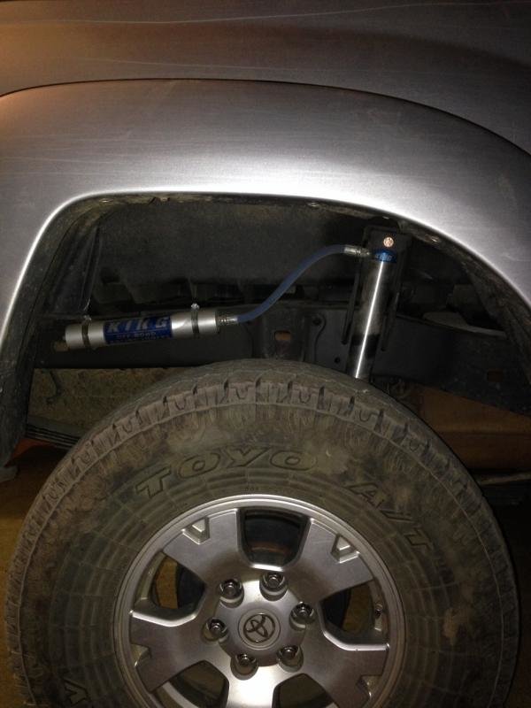

    Here's mine. Will be upgrading to some 10" 5125's sometime this summer.

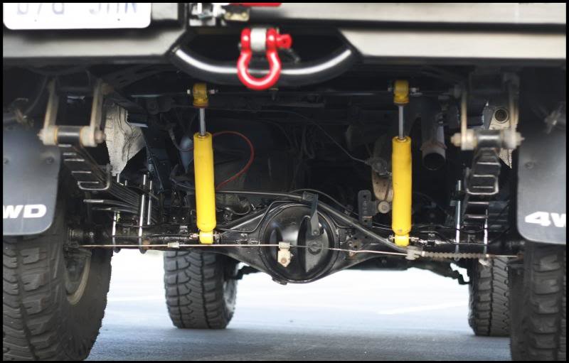

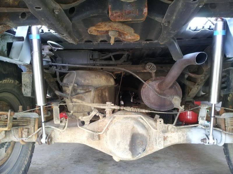

    Bilstein 12" 7100 shortbody shocks with f-250 shock towers through the bed:
    Works great, really got the back end working as it should. Now i just need to move the rear shackle hangar forward and it will really be where it should!
    Tyler Lacasse likes this.

    Those Ford towers are a nice cheap way to handle the upper mounts. I used those same towers on my '93 SAS truck with really good luck.
    Update: My setup is still working great a year later.

    Yup! Price was one reason why i went with them, the other was i wanted to pay homage to the oldschool days of toyota wheeling and reading build threads on pirate. The goal then was to do it as cheap as possible using stuff you found in a junkyard, kind of a departure to the builds of today. Saying that i have a $35 ford f-150 tank waiting to go in the taco soon, another old school mod!

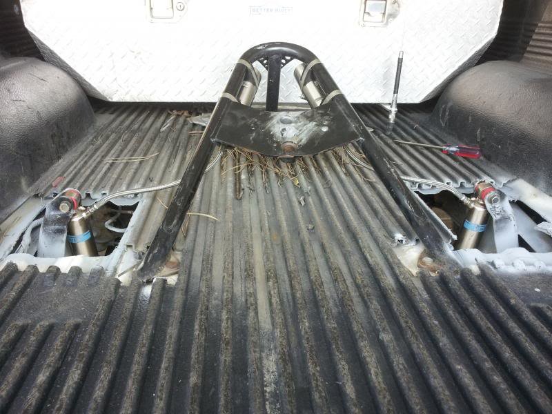

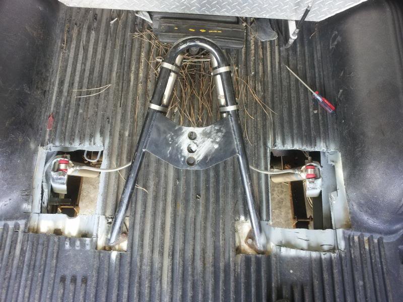

    BAMF kit, king 2.0 12", ruffstuff resi mount tabs, allpro standard 3" u bolt flip, superbumps, works tits,,,,,nice tits

    Very nice, looks like you ran your crossmember pretty much inline with the original location of the driver side upper shock mount, correct?

    Yes. The new crossmember is welded in directly above the factory location of the driverside upper shock mount.
