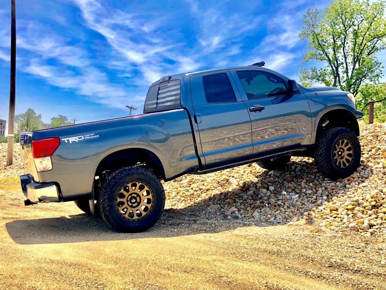

    I have a 6” lift on my tundra, coilovers in the front with 1” shims, and a 3” block in the rear with icon 2.0 shocks. CB steering kit and all the other stuff. I recently added a coachbuilder +3 shackle and ran into a major issue. The vendor I bought everything from told me they’ve sold this setup to 200+ tundra owners and never had the issue I’m having. Which is now that the shackle is installed, I have hardly any down travel. Aka shocks fully extended And slight bumps just bang the whole bed of the truck. He hasn’t offered any resolution or a fix. After looking around I can’t find anyone that has done custom rear shock relocations on a tundra, but it is pretty popular with Tacoma’s.
    Has anyone done this before and able to offer any insight? All help would be appreciated. I know I can get custom shocks made but I’d like to use what I have since they’re brand new.
