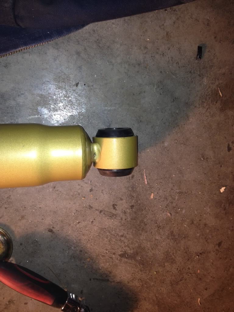

    I notice the bottom (base) the bushings are a tad bit big in two ways, they stick out a 1/4 inch on each side, and the bushing hole is bigger then the bolt. But I was like well they sent it to me so I'm sure it will work, on a side note I noticed another set of bushings that look like they would fit the bolt. So I grabbed them and they do but there is NO way these would fit into the base, as the base is semi beveled if that makes since and these are straight.
    So I try to put it in and it doesn't seem like these are going to go in at all...
    The bushings stick out about a 1/4 to far on each side, now maybe if I lube it up and beat it in, it might work but I'm not sure if I'm supposed to do that.

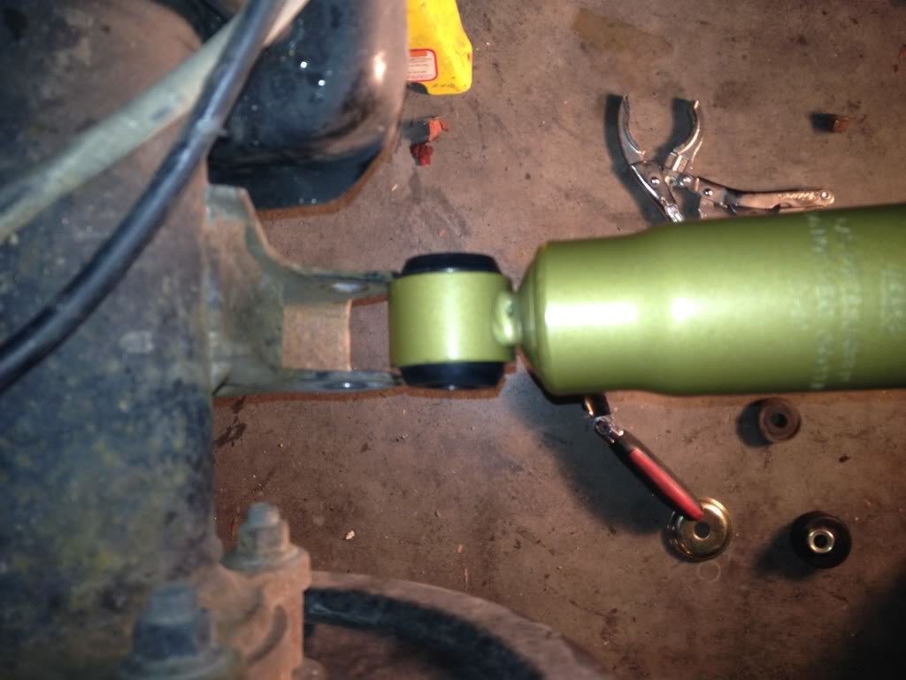

    The bushings do not fit in securely they easily fall out to btw

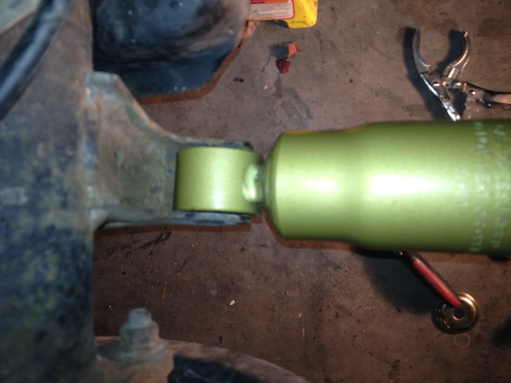

    This is it without the bushing in, it fits with very very small amount of play
    part number 50431 I think

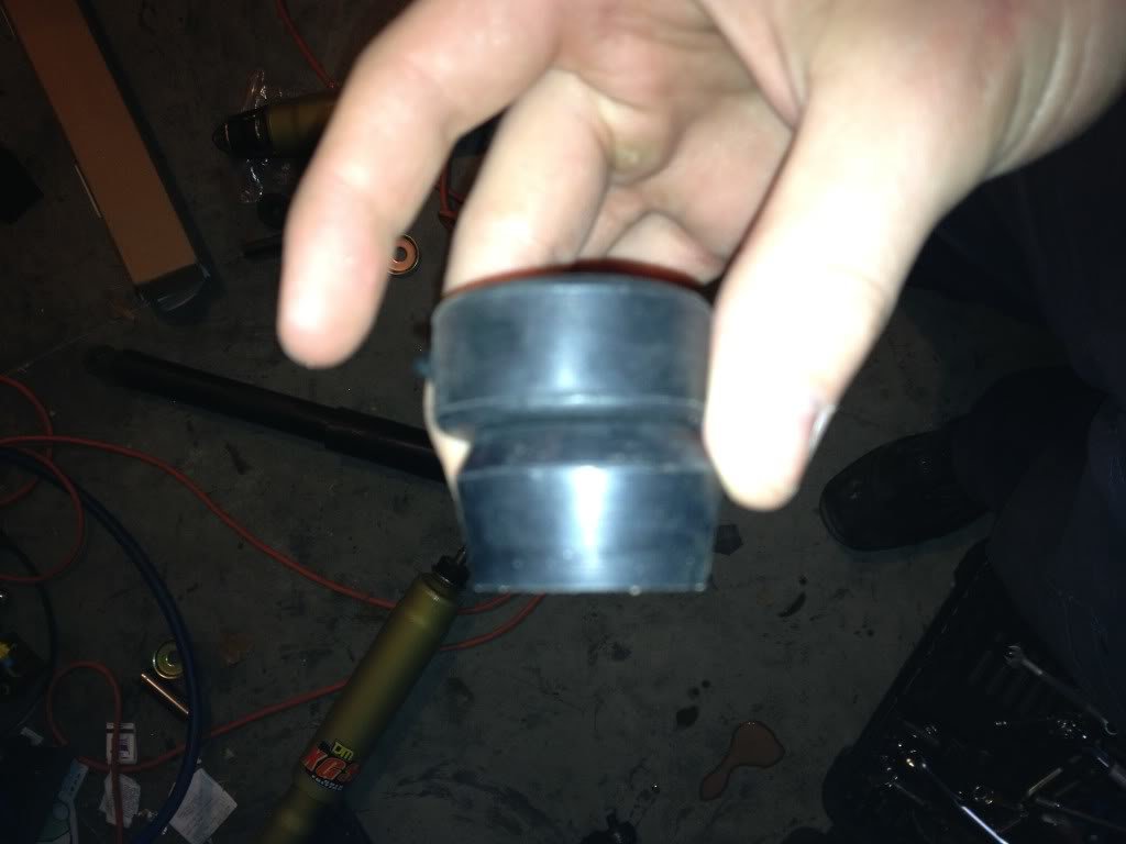

    The other bushings I was talking about, the one on the right is it. See how it is now beveled.

    OK, IF that indeed is the right part number, then I would put something in that bushing to keeps it's shape, put it in a bench vise and grind down the bushing say less than an 1/8 of an inch on either side, maybe less, i seem to recall doing the same thing to mine. My feeling was that i was gonna mess it up but i've put 10k on the truck since then with no problems whatsoever. I ended up using a block of wood against the metal part and having to pound than bastard in sideways and a little from the top down to get it into place.

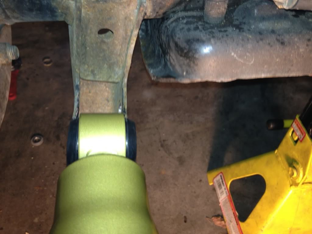

    Ok after going and looking at it again there is no way I can even get it started without cutting it....
    If I cut the inside of one of them I can prob make it work.
    I took one out, pounded the other one farther in (gently) so it was actually in the space of where the other one went it was a snug fit, so if I cut down the other one it should fit pretty well..
