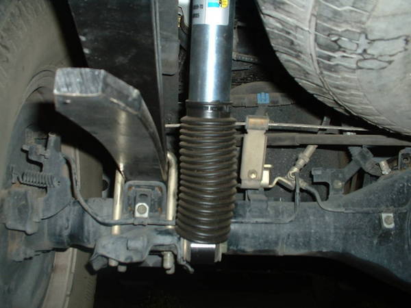

    Yep, thats my thread. I also searched for pictures of the 5100 installed to see if the boot goes up or down and saw both. And both cases were on Tacomas. So I dunno, I mimicked the OEM HD Bilsteins where the rod is facing up and shock canister and the bottom. I might flip them to the boot down position down eventually.
    As to the TrOdOr dilemma on this thread on the new one about the AAL and 5100s, I went through the same problem with Sonny on my 02. See my thread above. I installed the AAL and they still seem to long to me. I haven't heard any bottoming out yet even with a few dirtbikes on the back but I will switch back to the stock HD Bilsteins before the summer when I do more 4x4 and riding.

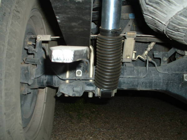

    I saw your latest post, so I went out and took a couple of photos for comparison...I mounted the rear 5100's with stock height springs (albeit Alcan replacements), and this is how they look in comparison to your photos on the thread you refer to: (I can't figure out how to insert your photos, the picasaweb has a strange url...)
    Mine:
    They don't look nearly so compressed, unless your photos are at a different angle, so I don't quite get it...

    Bilstein 5100
    Yeah, I know, upside down "Bilstein", thought that too but went the OEM way. :eek:
    Thanks for those pics. Good to see a comparo. I'll go out this weekend and take a few pics with the AAL in and show how my shocks are looking now. The pics in my thread are before I put the AAL in. It'll be good to show your pics and mine side by side.
