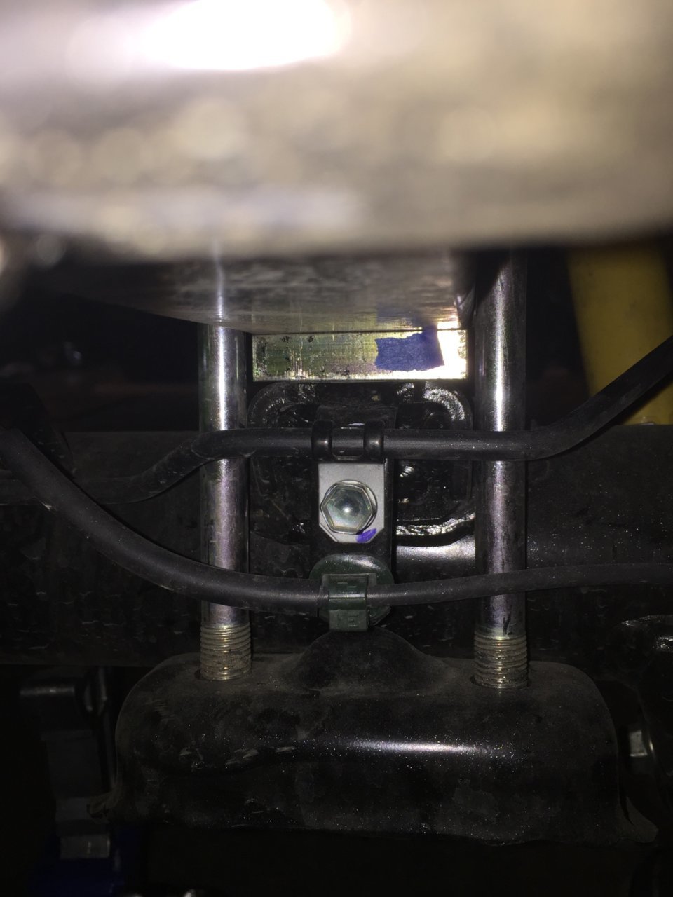

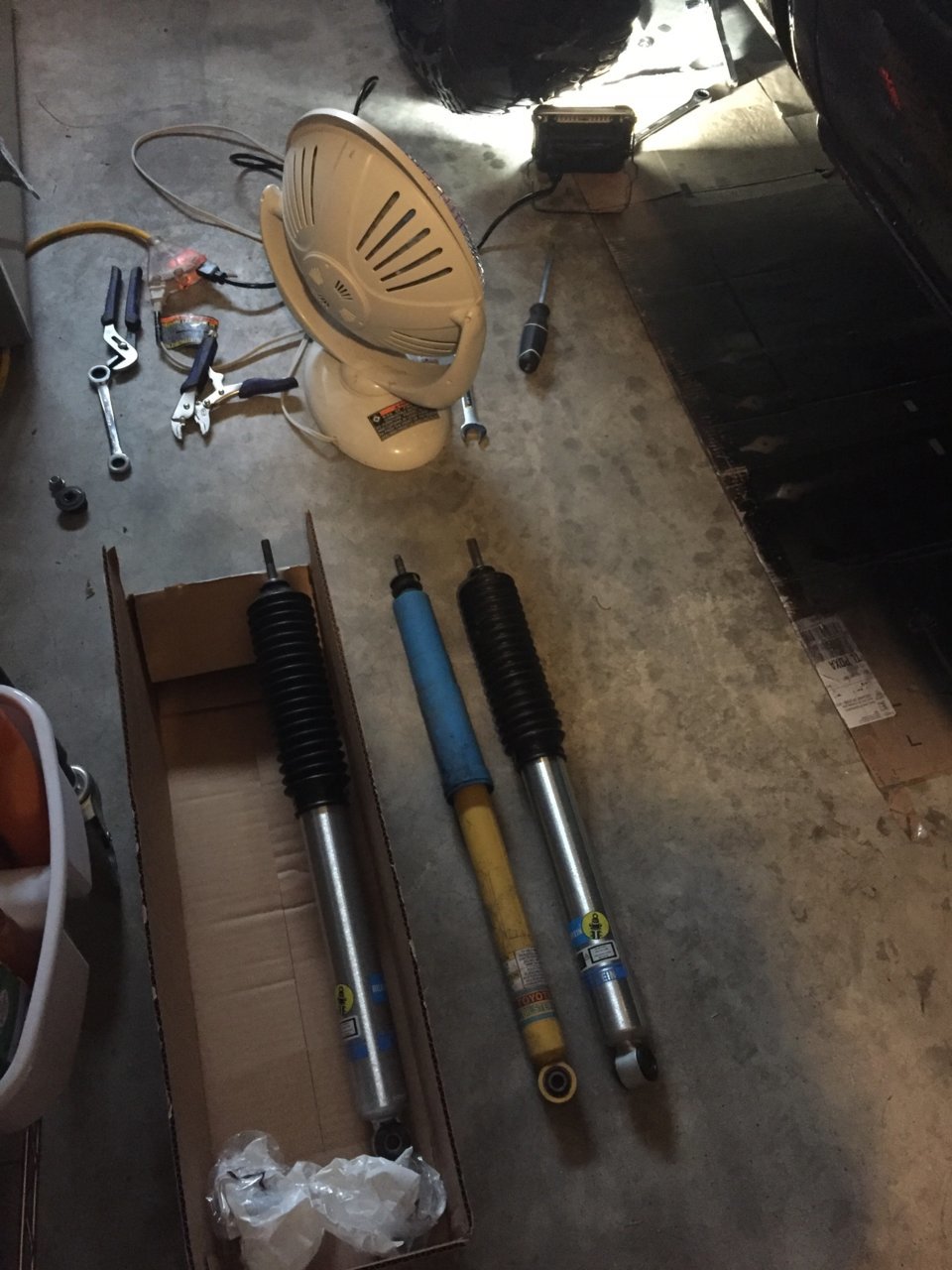

    The 5100’s are for 0” to 1” lift.
    While the 5100’s provide a firmer and more controlled ride and handling, I’m still bottoming out on large bump, and it only gets worse as the already sagging stock leafs continue to further sag as they get older.
    Stock springs with 1/2 inch block:
    7E33DAFB-83B4-4C90-9222-5BFC43F7FA23.jpg 517B620C-04D6-4F05-A6A4-8A34FC47F0AF.jpg
