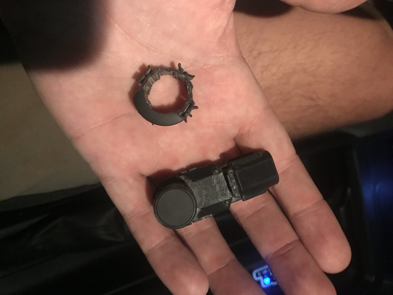

    One of my parking sensor clips broke magically. And by magically I mean nothing hit my bumper and sensor is fine, but dealership said it costs $450 ($250 for parts $200 for labor) to fix. I took it out in less than 10 seconds, and can probably beat that time putting it in. Only thing I'm missing is the parts department says that retaining clip only comes when you buy the sensor. Where can I buy this sensor retaining clip??
    Tldr: where to source 2017 Tacoma rear sonar retaining clip...

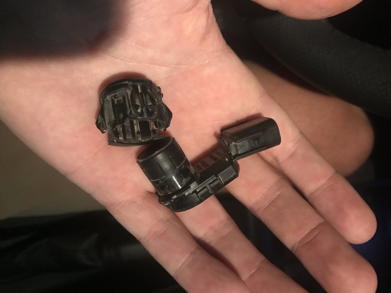

    Attached are pics retainer goes into bumper then sensor clips in from back.

    That looks close, but the Tacoma one has an interior ring I'll see if I can take better pictures. I didn't even think about looking at Lexus parts. Looks like some toyotas come with the ability to replace the clip and some don't. Is there any way to cross reference the sensors part number to other vehicles to see if they have the clips?
    8816204011; 8816204012 These are what I believe to be the whole assembly.

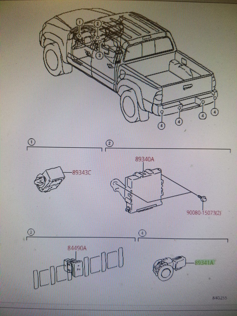

    I am in the same boat as you. Got rear ended and the retaining clip broke. I found that part # 89341-12100 appears to be the same thing.

    Negative, the part number you are referencing is the sensor ecu for blind spot monitoring(BSM). The part number @Taco_Time referenced is the correct one and through Toyota it, the clip, is non-serviceable. That being said a clip from another model may possibly work.
