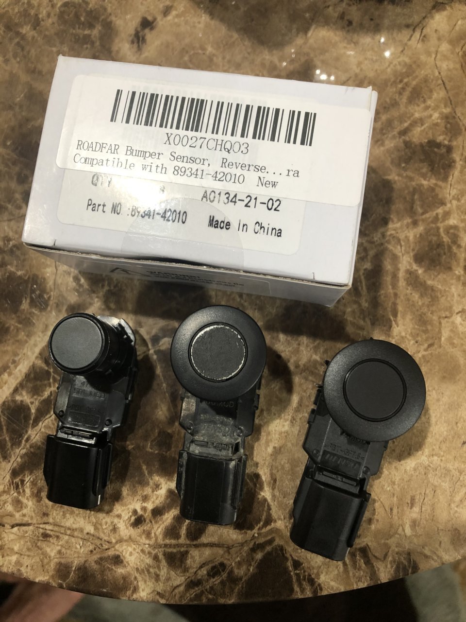

    thanks to @svermilyea , the ones he linked allow you to easily pull of the plastic ring that breaks way too often and put them easily on your OEM sensors (if you’re like me and don’t want to lose any potential functionality b/t OEM and $14 Amazon part). They come off super easy just be gentle, and pop right in perfectly flush to the tab on the OEM sensor

    I broke my retaining clip a few months ago while taking the sensor out to replace a scuffed bumper cover, and like others was surprised/appalled that you can't just get the (very fragile) clip without buying an entirely new and very expensive sensor. I bought one of the knockoff sensors off of Amazon for around $15 and decided just to put the entire thing in and see what happens. It did work well enough to at least not cause the truck to having dash warning lights pop up anymore when enabling them, but I found out they did not work very well. I basically had to stand right next to it to it to get it to trip, whereas the OEM ones detect stuff from many feet away. I'd only use the actual knockoff sensor if you don't care and just want to get the dash warning to go away. Otherwise just buy it for the retaining clip and throw the sensor away.

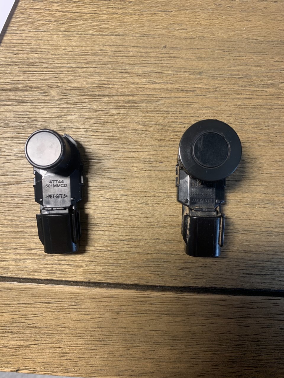

    That was the point of the post, bought the cheap one strictly for the retaining clip and it fits perfectly. The pic is showing the OEM denso sensor with the cheap plastic clip from the $14 Amazon one on it. I was surprised how well it fit. I didn’t really want to add that garbage amazon sensor to it and wanted to keep OEM functionality. I agree it’s pretty frustrating they won’t just source the cheap plastic clip from the factory but I’m guessing it’s cause they want more $$$

    I can confirm that the Amazon clip will fit your original sensor .. I just bought the whole sensor for $18 from Amazon and removed the clip and installed it on the OEM sensor .. so the left is for the original part with the original clip and the one in the right shows the Amazon sensor without the clip and the middle is the installed clip on the OEM sensor .
