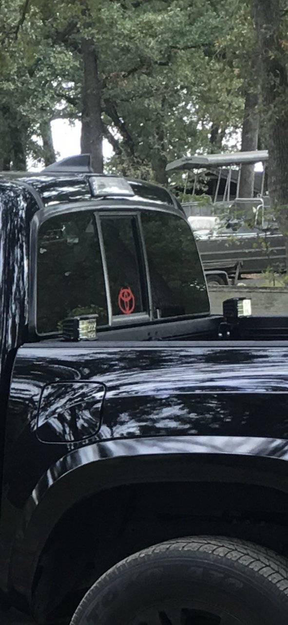

    Rear side shooters and bed rail brackets from caliraised

    Quick note:
    The battery harness for the lights reached fine in length, I did have to add extension wires for the switch in the cab, just a few feet worked.

    These, but consider mounting them by the tailgate.
    Less blinding yourself as you move around/reaching into the bed.

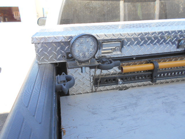

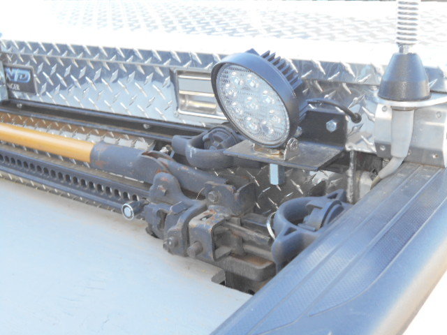

    Our service trucks at work use a variation of this set-up..........
    Shop guys made their angle brackets a bit smoother than I did - but the tool box mount works well. The extended nut below and a wingnut on the tilt makes them quick to aim. Cheap LED lights came from Amazon - when they fail I'll get some better versions. Next time will get one spot and one flood.
