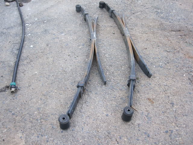

    I bought this thing a few months back and have been trying to get it back fairly stock it's a 4wd extended cab. Under the rear leaf springs is a fairly thick maybe 5/8" helper spring, I was wondering if this is stock because it rides like a tank. Or do they just comes with the leaf springs? Thanks

    That sounds like the overload, which is normal. There should be 3 leafs and one overload (thick one on the bottom)

    I think that's about how it looks it sure rides rough on my old bones

    That overload leaf really does not affect the ride much, since it is curved downward. Its supposed to prevent damage to the main pack when the truck is overloaded.
    More weight in the back (camper shell?) would help the ride a bit.
    If the front suspension had been modified for lift, it could have worsened the ride if done cheaply.
