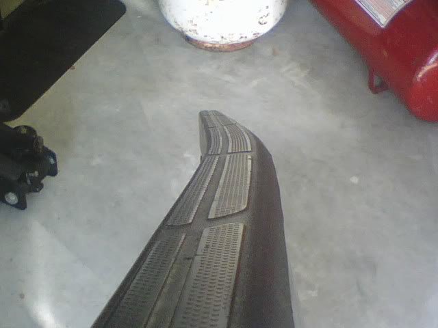

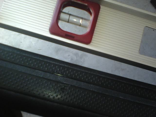

    I have on 07 with about 32,000 miles on it. I recently started hauling my sportbike in the rear and haven't had any bend yet. I plan on getting a heavier bike and am worried about bending the tailgate out of warranty. How did everyone else bend their tail gates, any pictures?
