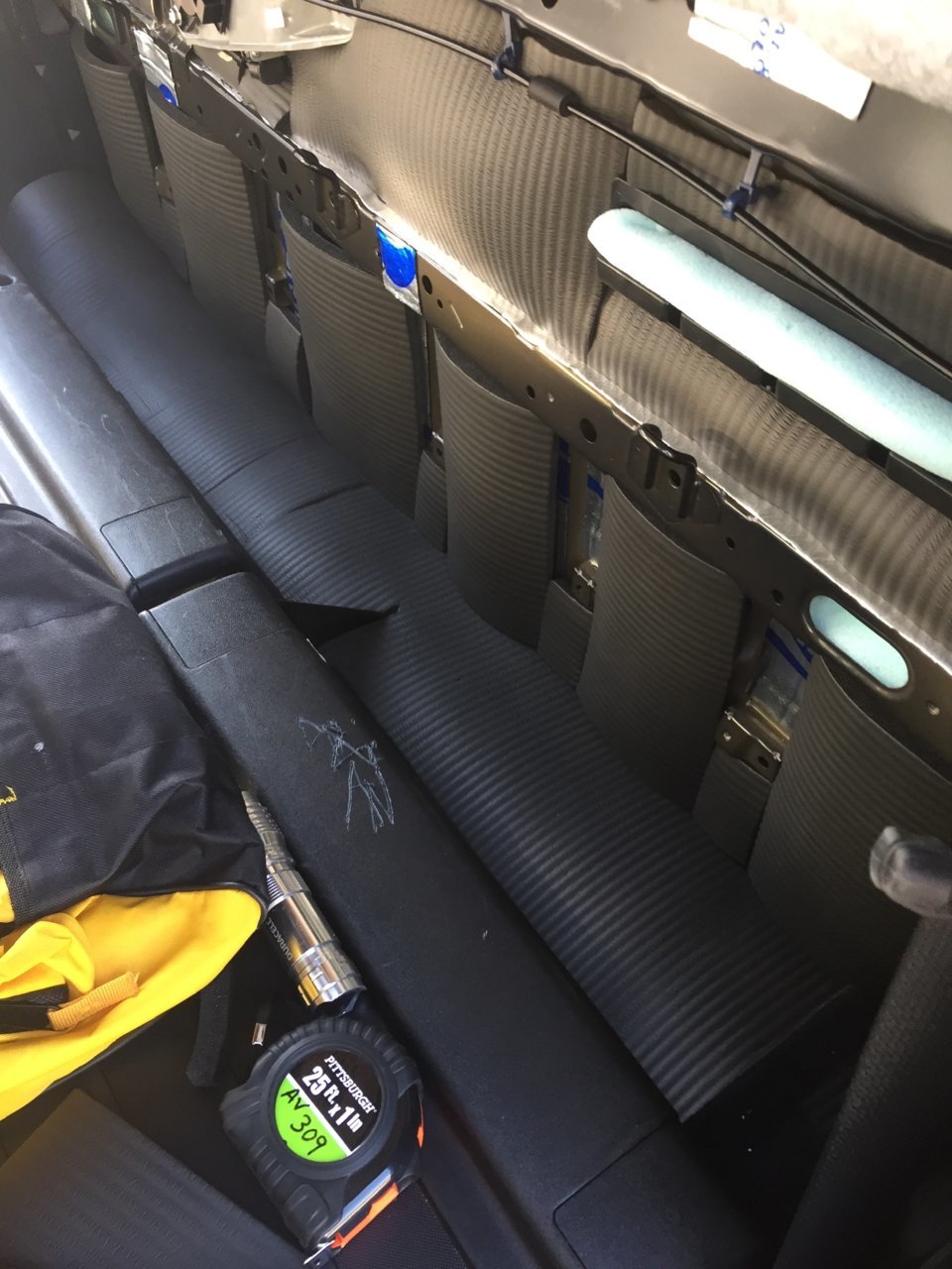

    getting ready to replace the speakers and going to be laying down some Noico. While doing the rear wall, I was thinking about the rear storage under the seats. Question...will the storage bin fit after laying down the Noico 80 mil?
    2018 DCSB for reference
    Thanks for any and all help

    I found when i was sound deadening with CLD tiles and 1/8" MLV that putting the storage box back in was a struggle. Toyota makes it a tight fit. Hardest thing was the 7 or 8 push down clips that hold the storage box in place would just pop right back out.
    Take a look at the bottom of the storage compartment and make sure you get the 80 mil deep in the crevices with a roller and pushed down tight in the corners...
    Good luck with the deadening.

    I have BoomMat and exercise mat behind and under the rear wall storage tray and BoomMat and automotive insulation on the floor under the tray beneath the rear seat.
    The BoomMat is similar to Dynamat or Noico.
    You can try some new plastic push clips of various lengths and diameters from an auto parts store and use those to keep the tray down if re-using the OEM clips won’t quite hold the tray.
