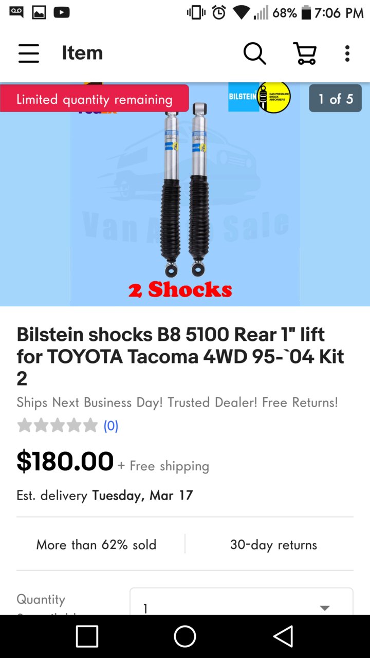

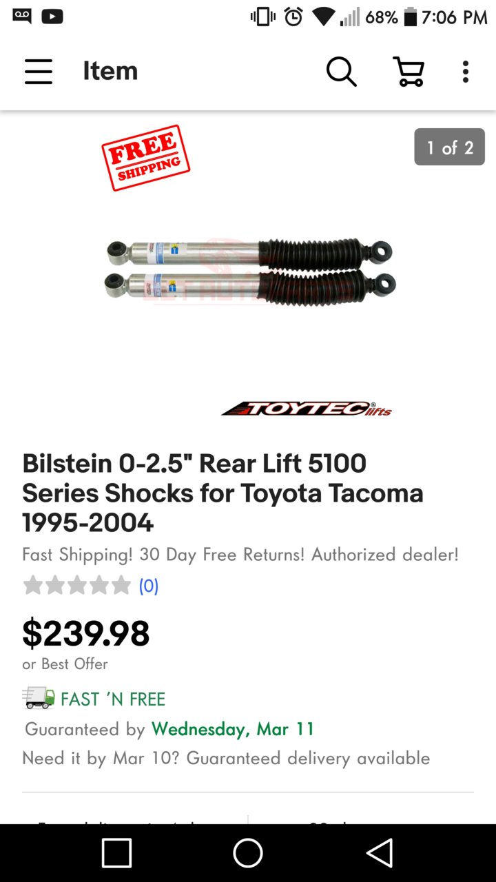

    I need rear struts and leaf springs in a pretty bad way. I was wanting bilstein 5100's at factory ride height.
    Anyone have an idea why there's a $60 difference between these?
    The cheaper pair says a minimum 1" lift is required but the lengths are shorter than the $240 ones which doesn't make sense to me.
    I wanted stock ride height but at this point I'm thinking I'll lift out an inch to save $60 on struts.

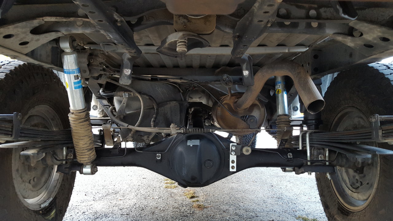

    Fox -
    The two -
    Bilstein -
    Anyway, the Bilsteins proved to have softer dampening (due to the difference in valving) and driving down the same roads didn't give me that "jarring" experience when I'd fly over a speed bump.
    What I didn't like about the Bilstein's though was that the rear felt a little "soggy" (due to a lack of better term) when I'd off road while all loaded up. The Fox shocks in this case were great for that.
    Anyway, my truck feels great (even though its pretty heavy) but even before I got my front bumper, sliders, etc. on, the Bilsteins were great.

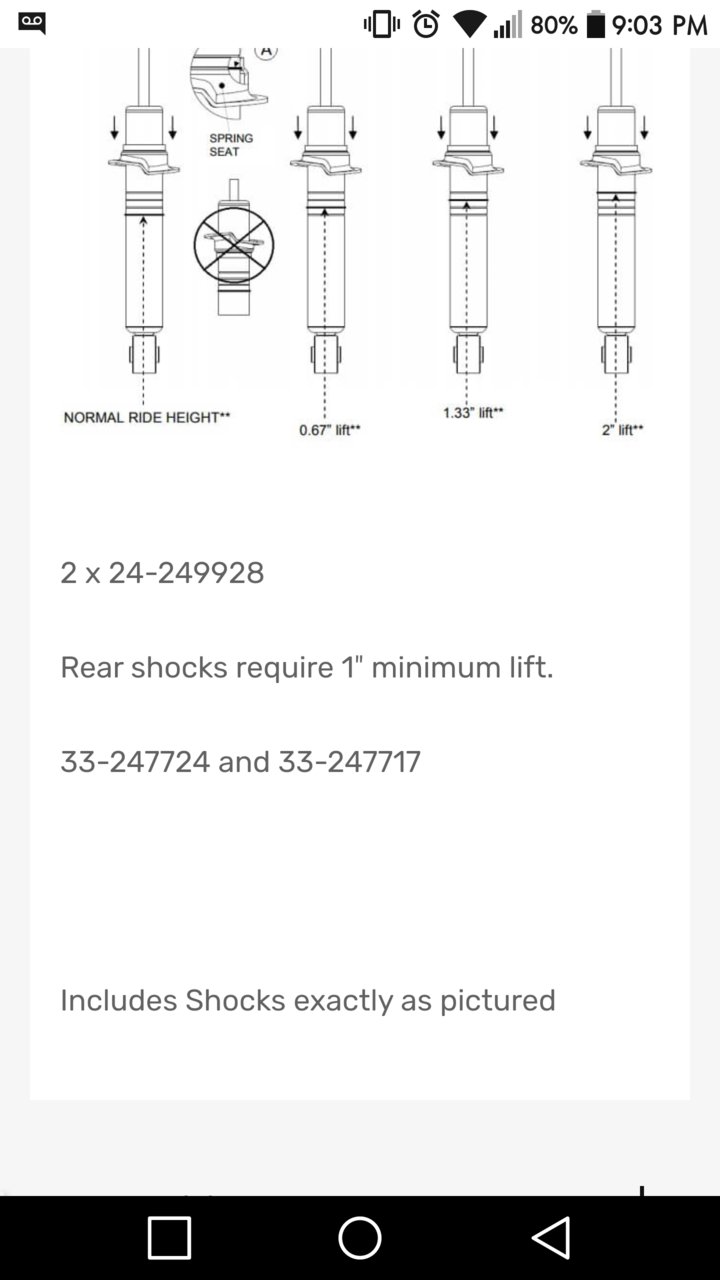

    Yes, Bilstein 5100's are a great option for someone that may want to off road, but I wouldn't say they're a factory replacement parse.
    Opt for the shorter variant since you're not going for anything more than a 1" lift so you don't run into issues at full extension/compression -
    33-247724 and 33-247717
    There's another variant with part numbers BE5-D559 and D560 but they're slightly longer both compressed and extended which I advise against with your setup.

    The $180 dollar ones are 0-1” of lift, the $240 ones are for 0-2.5” of lift in the rear hence the cost difference. So depending on how much your planning on lifting the rear of your truck buy accordingly.

    @Kwikvette Bilstein's site says for the p/n's that you advised a minimum of 1" lift is required.
    @gotoman1969 0-1" would be fine but according to online distributors its "a minimum of 1" " Which is the whole point of this post, looking for someone who has experienced that the cheaper option will work properly with no lift.

    @BubbaTaco324
    Going back and reading your reply to the other poster, you are stating no lift.
    You need Bilstein 4600s which are meant for 0 lift.
    They're slightly softer than 5100s since the valving is slightly different.
