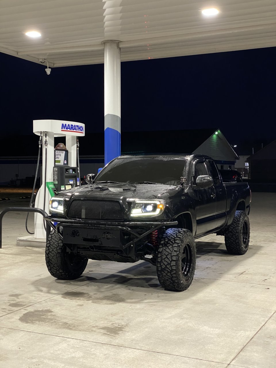

    Finally have the front suspension of this truck set up the way I want. Icon 2.5 coilovers with Fox 600lb coils (ask me why the coils are Fox not Icon :rofl:) and SPC UCAs. For those that have seen this truck before, also got a new bumper.
    Now that the front rides well, it’s obvious the rear is kinda stiff. Stock leaf springs and an Icon AAL, Icon remote resi rear shocks. What route would y’all go to improve the ride/weight capacity in the rear? Looked at Firestone air bags or getting new leaf packs, just not sure what route to go. Any input welcome.
