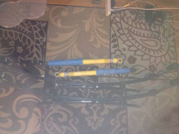

    I was wondering the same thing....if you're not going for a lift I just took off my Toyota TRD Bilsteins and brand new 3leaf pack that has probably 1,000mi., shocks have 11k mi.
    I took my truck in to get the TSB leafs done at my 10k mi service but they gave me a new 3pack instead. I now have just over 11k mi and replaced them with Deavers two days ago so the leafs are really new, shocks fairly new at 11k mi.
    $100? OBO...I'm in LA if you're interested, they're taking up space in my living room :)
