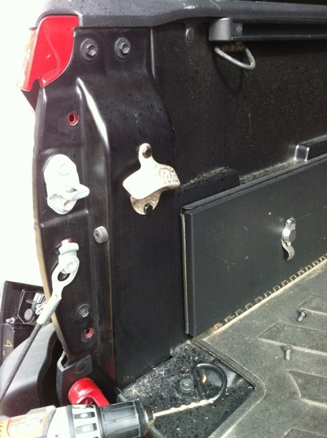

    These are the bolts I removed to mount the bottle opener. Does that help?
